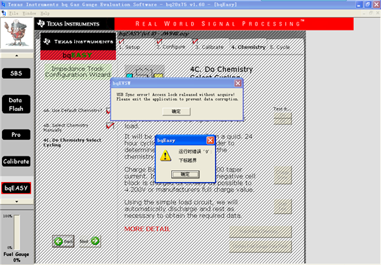

bqEASY 0.9.64: Fatal error at the end of Chemistry Select Cycling
Other Parts Discussed in Thread: BQEVSW
After completing the Chemistry Select Cycling (Step 4 in the bqEASY Impedance Track Configuration Wizard) and then clicking "Match Best Chemistry" the following error appears:
USB sync error! Access lock released without acquire! Please exit the application to prevent data corruption.
Then:
Run-time error '9': Subscript out of range.
This has happened twice so far and as a result I cannot finish the configuration procedure.
It seems as if it is the same error as described here: http://e2e.ti.com/support/power_management/battery_management/w/design_notes/bqeasy-encounter-a-problem.aspx
I am really desperate for a fix for this problem and would appreciate any help.
Nick

  • Sorry - I should have included that information!
    Device: bq20z65EVM
    bqEVSW Version: 0.9.64 downloaded from: http://focus.ti.com/docs/toolsw/folders/print/bq20z65-r1_bqevsw-sw.html
    bqEASY v1.87
    I hope you can help me from here.
    Nick

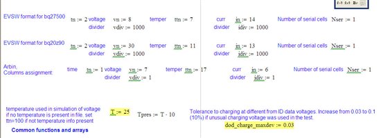

    Here is the chem.log file: http://dl.dropbox.com/u/11967961/Chem.log
    Nick
  • Nick,
    From the chem.log data, the software matched with chemID 150 (max error = 0.87%)
    Jackie

    Would you mind taking a look at my chemical log file?
    http://dl.dropbox.com/u/8083213/Chem.log
    Helgi Hall

  • Helgi,
    The best match chemID for your battery is ID 190 (max error = 0.44%).

  • Jackie:
    I noticed that you have been able to match a close chem id using the chem.log file.  Would you be able to do this for me?  The chemistry leaning cycling has been erroring out and I have been unable to correct this after many attampts.  We have a demo coming up and your help would be much appreciated.  I attached the chem.log file.  The file is for a Moli IBR-18650B 6661.DM_IBR18650B.pdf.  Two cells were in series.  Thank you in advance.
    Peter

  • Hi Jackie,
    i also had these problems with crashing bqEvSW when selecting the chem-Id. Could you please check my file too?
    Thank you
    Michael
    3757.Chem.zip
    I also used the BQeasy to get the chemistry ID, but also BQeasy crashed at the end and gives an error that it was out of range.
    I have added the chem.log file. can you tell me witch ID the best is
     6763.Chem.zip
    Thanks already
  • Hi Jackie,
    I have got the same error like the others, an I need the chemID, too.
    I am using:
    bq20z95 v1.5
    bqEVSW Version 0.9.59
    bqEasy V1.85
    I have added the chem.log.
    8004.Chem.log
    Could you help me, please?
    Thanks.
    Klaus
  • Dear Jackie:
    I have got the same error like the others,After completing the Chemistry Select Cycling (Step 4 in the bqEASY Impedance Track Configuration Wizard) and then clicking "Match Best Chemistry" the following error appears:
    I am using:
    Device: bq20z75 Ver: 1.60
    bqEVSW Version 0.9.64
    bqEasy V278
    So I copyed the chem.log file  in C:\Program Files\Texas Instruments\bq Evaluation Software\Plugins\
     3021.copy Chem.rar
    And my computer installed MathCad 15,I want to calculate this Chem ID by myself,because we used a lot of different types of lithium batteries,I placed the chem log file in the same directory containing the chemselect.mcd file [SLUA372],But import this chem log file cannot get the correct chem ID,How can I set these parameters?
    Thanks and Regards.
    GeneChou.
    2013-3-8
  • Hello Jackie,
    5 years later this issue seems still not to be solved (bqeasy 1.85 in bqsw 0.9.59 for bq20z95 1.50). Can you also check my chem.log to give me the good chem ID please ?
    Thanks by advance.
    Antoine
