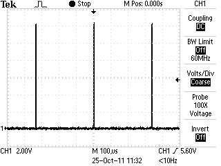

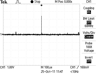

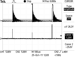

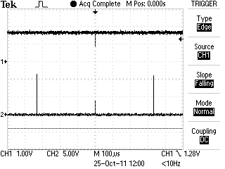

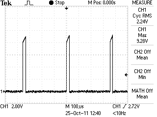

    here comes the first wave, which shows waveforms under no load condition:
    Voltage directly on Gate-Pin of Switching-MosFET Q3.
    Voltage Drain-Source of Q3.
    Voltage over shunt "R30||R31". During the measurement a overall resistance of about 1 to 1.4 Ohm was installed (no 0R5 like in scematic).
    COMP-Voltage (CH1) and Gate of Q3 (CH2).
    VZCD (CH1) and Gate of Q3 (CH2). The Cursor shows the 1.2V mark of VZCD.
    Thank you very much! Scopes of load conditions will follow.

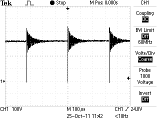

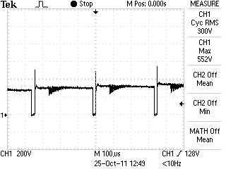

    like I promised here are the load-scops:
    The load is a 33R resistor whereas the output voltage breaks down to 12V under this load condition.
