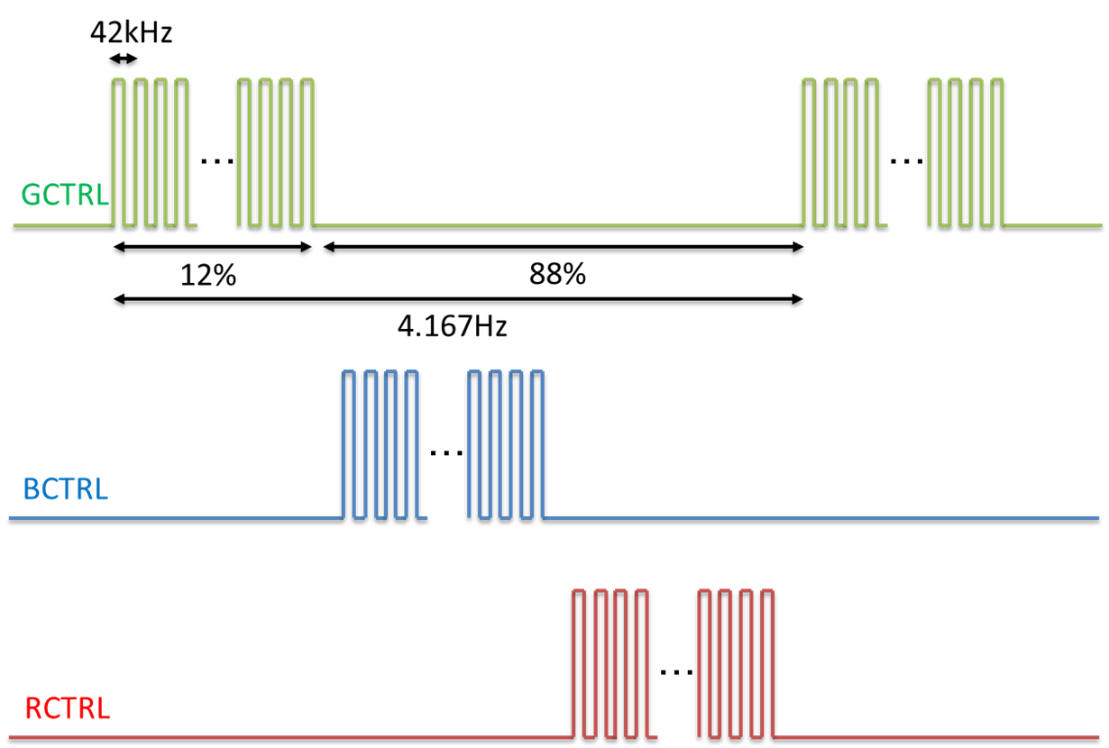

  • Hello Issac-san,
    1) Can the attached waveform be input to the G/B/L CTRL pin of the LM3435?
    2) Will delay time (default: 35us) occur between ON pulses under control of the same color?
    Kato

  • Hi Kato-san,
    We did not tested such pattern before and we don't know about the feasibility of such configuration with LM3435.
    As far as I know, the 35us delay does not implemented on the same color.
    Thank you!

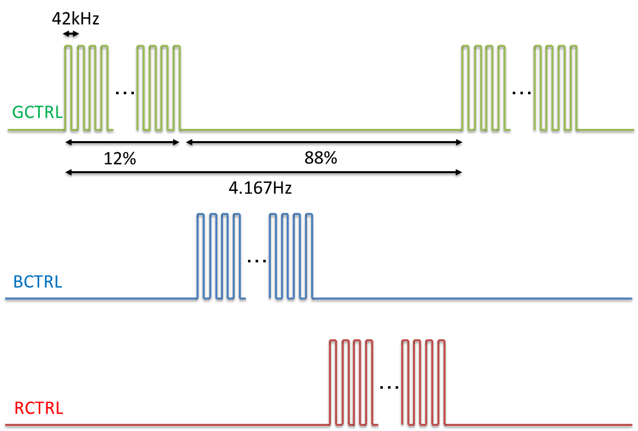

  • Hello Issac-san,
    1) Please tell us a specification of the response speed on the same color?
    2) We are considering LCOS display.
        The following specifications are required for the LED driver for LCOS display.
            - Channel/Current : 3 channel(G/B/R) / per Min 600mA
            - Switching frequency : excluding AM band (500k to 1.6M Hz)
            - Input voltage range(Min) : Less than 2.9V (Li-ion battery voltage input)
            - The LED can be controlled with the attached waveform.
                *Control can also be considered with an external switch as shown.*
        Are there optimum devices other than the LM3435?
        Is optimum devices a camera flash LED driver like a LM364x?
    Kato

  • Hi Kato-san,
    We did not test the delay for same color on/off during the evaluation as it was not the purpose to use this device.
    I also cannot comment if you can do the external switch for dimming as the converter was not designed for such condition.
    I am not sure if LM364x family would be able to help as the products were not belong to my product line.
    Sorry if you feel this might not helpful as the product LM3435 was designed a few years back without a broad application usage!
