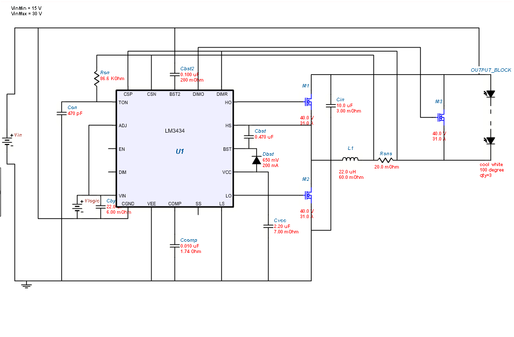

    Although the LM3150 can be made to work as a synchronous buck converter for driving LEDs. It will require some extra circuitry to add a DCR sense to the circuit that adds complexity.

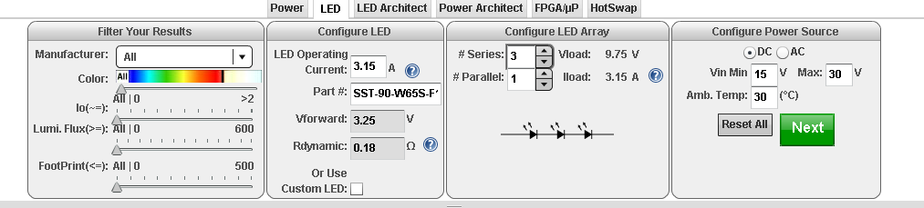

    I ran a quick calculation on Webench, one of our online component selection and simulator tools.  Which you can find on the TI home page  WWW.TI.COM
    It came up with the LM3434 as your best solution.  Here is what I entered as your paramters.
    Then I added the following LEDS
    This is the solution that it provided
