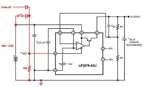

    I'm guessing the circuit looks like this (image below) ... If this accurate, there is no reason this would not work. With Vin at 5.0V the voltage applied to the /shutdown pin would be about 4.3V and the LP3878-ADJ output should absolutely be on as long as the switch is closed.

  • Just now back from the bench and I do NOT see any measurable variation of the LP3878-ADJ ON (~1.50V) or OFF (~1.40V) threshold voltages for VIN from 2.5V to 5.5V.
    As a test, if the LP3878-ADJ output voltage of 3.3V is looped back to the diode connection I labeled "From uP" then the LP3878-ADJ should stay alive when the switch is opened. When the switch is opened the voltage on the /SHUTDOWN pin will drop from about 4.3V to about 2.6V, and 2.6V is still well above the ON threshold.
    A second test is to leave the switch open and connect the 5V only to to the diode connection I labeled "From uP" then the LP3878-ADJ output should be ON.
    "... if I put this Vout into /SHUTDOWN ..."
    Both of the control voltages (5.0V and 3.3V) must be OR-ed to the /SHUTDOWN pin via the diodes. A direct connection from the LP3878-ADJ output to the /SHUTDOWN pin while the switch to 5V is still closed will cause the output pin to be pulled up to 4.3V, and that is not a recommended condition.
    One issue to consider is when the 3.3V is from the GPIO pin is loading (i.e. the current needed) of the GPIO pin. Ideally, the GPIO pin should be able to supply at least 270 micro-Amps (2.7V/10k) in order to keep the GPIO pin voltage near to 3.3V.

  • Hi again,
    I've put together a simplified version of my circuit at Upverter: http://upverter.com/asier/a7762392930e01c3/LP3878-adj-based-soft-power-switch/
    I think this _should_ work, but it doesn't, even taking /SHUTDOWN to OUTPUT.

  • Asier,
    Schematic looks ok, same as you described. No odd or unreasonable values.
         Vout = 1V x ( 1 + (10k7/4k7)) = 3.277V
         fz = 1 / (2 x pi x 240pF x 10k7) = 62 kHz
    Text book.
    This makes no sense. Wiring the on/off pin to the output voltage is a common 'latch-on' configuration.
    Since the external battery test works, all I can think of now is perhaps there is some odd behavior with the LP3878-ADJ output voltage, such as an oscillation. This would not be normal behavior and may point to some problem with the 10 uF capacitor on the output pin.

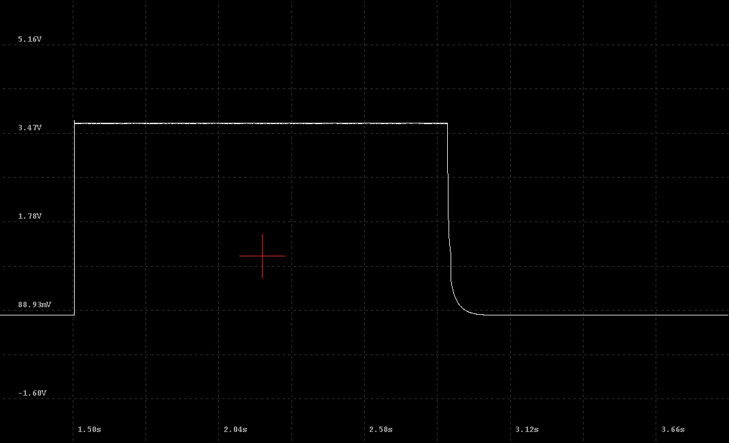

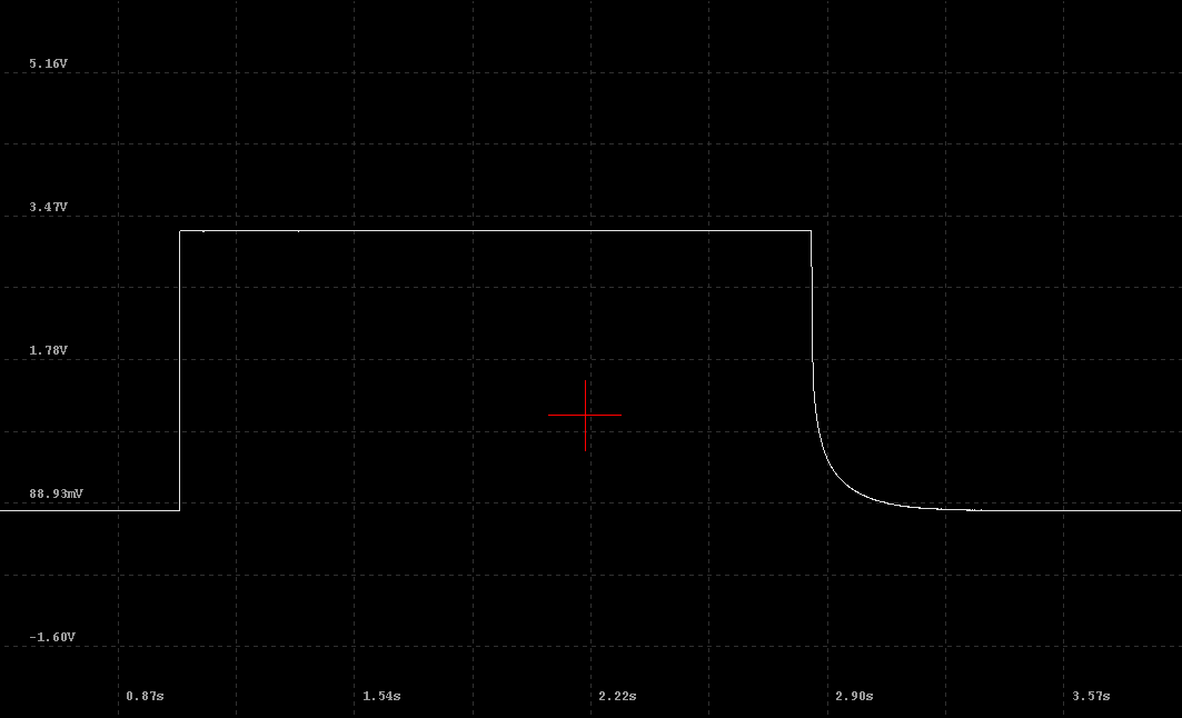

    With regards to the 10uF capacitor on the output pin, as per my multimeter, it has a capacitance of 8.60 uF, which seems to me like a big tolerance.
    I don't have a proper oscilloscope, but I've managed to make some measurings with a Bus Pirate (don't know if you know it). It doesn't allow a really fast sampling but I've attached two captures:
    - one on the input line to /SHUTDOWN, i.e. the output of the OR'ing diodes,
    - and the other on the Vout line right before the OR'ing diode.
    For both test I've started with /SHUTDOWN = LOW, then pressed the button, wait, and released the button. Although the scale is not zero'ed, I've checked the LOW value was 0v.
    For these tests I've simplified my circuit as much as I can, as the regulator is already mounted on a board, although it should be pretty much isolated from the rest of electronics, which have been disconnected. The part with the diodes and the pushbutton is running on a bread board.
    Any further hint?
    Thanks and best regards,
    Asier.
  • Having 8.6 out of 10 is close enough.
    The horizontal trace trace close to 3.47V is with the switch to 5V closed? If switch to 5V is closed, it should read closer to 4.5V, give-or-take a few milli-Volts.
    At what point in the horizontal time line is the 5V switch opened?
    Great.
    Yes, it is. It's kind of weird as measuring with the multimeter I read close to 4.5V. I'm afraid it's a deviation caused by the sampling software. I'll try to check that tomorrow (I'm at GMT+1, and I don't have the HW at home) or to use a different software.
    It's when the falling edge is, in both traces.
