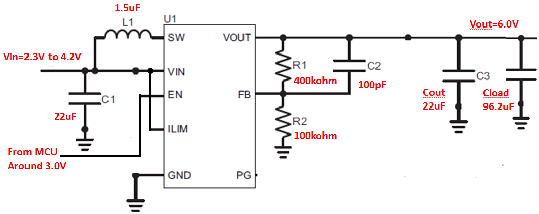

Our customer would like to use the following condition.
We understood that this condition is not recommended.
However, our customer would like to know about behavior at low Vcc (out of recommended range).
Could you please let me know if you have any advice?
[Condition]
-Vin=2.3V to 4.2V (1cell)
However, it may drop to around 2.1V.
-Vout=6.0V
-Iout=Around 570mA (peak current)
-Cout=22uF
-Cload=47uF*2 + 1uF*2 + 0.1uF*2=96.2uF

    Note that the max UVLO of TPS61252 is 2.1V. So if Vin is 2.1V, IC will enter UVLO and shutdown.
    Would you please share more information about the application environment and end equipment?  Perhaps we can give you some other suggestion.

    Therefore, they intend to do the design that does not reach "Vin=2.1V".
    However Vin of TPS61252 may become "from 2.1V to 2.3V(out of recommended range)" by the inrush current.
    Could you please let us know if you have the concern point other than UVLO?

    - Would you please share more information about the application environment and end equipment?
    -> This circuits are as follows

    UVLO is the main concern, no other concerns.
    As you said, large inrush or long trace PCB layout will introduce low Vin and lead to UVLO.
    BTW, if your customer use one-cell Li-Ion battery as the input of IC, 2.75V should be the lowest input voltage. Why they need 2.1V application?

    According to our customer, Vin range is “2.5V to 4.2V”.
    However, Vin may drop to around 2.1V by the large inrush current.
