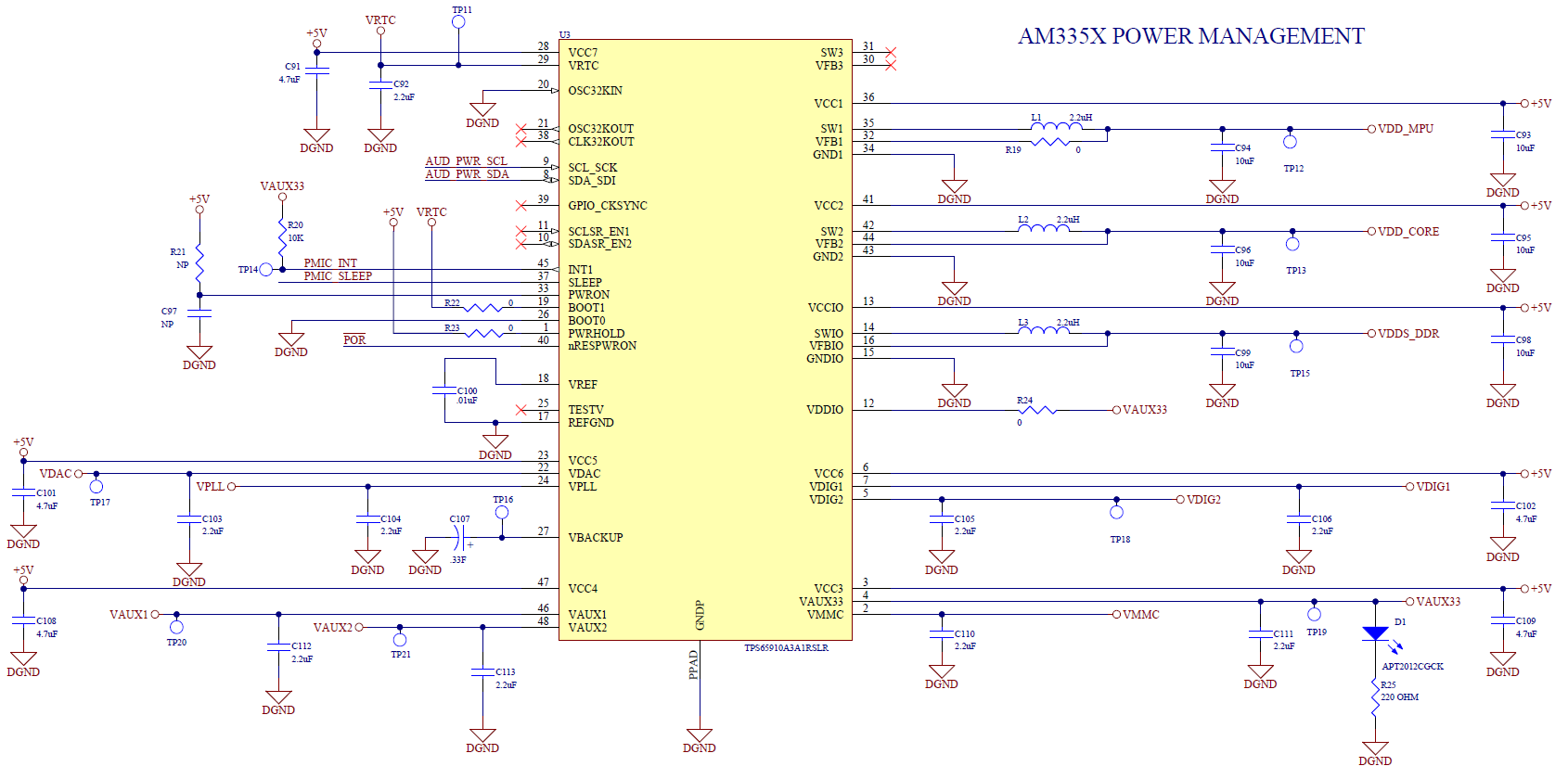

  • I ended up pulling the PWRHOLD Pin high and then just putting some pads on my board for the RC Circuit just in case, but i never needed them because pulling the PWRHOLD pin worked fine for me.  Here is my setup in case it helps (this is currently working for me):
    The only input voltage is the +5V, the rest are all output voltages.  As you can see R21 and C97 are Non-populated meaning my PWRON pin is floating like yours.  I am using the A3A1 as i have DDR3, but other than that it sounds like we did the same things.  Hope the image helps, Good Luck!!!

  • I see on your schematic that you had PWRHOLD connected to VAUX33 which will not work, but also see that you later connected it to and EXTERNAL 3.3V supply.
    Have you tried connecting your PWRHOLD pin directly to the 5V VCC power input to the part?  There is an internal pull-down on that pin enabled by default so just connect it directly to the 5V.

  • The range on that pin is 1.65-5.5V, so connecting to 5V is fine.  Since you are using PWRHOLD to turn the device on you cannot connect to VAUX33 because this domain is not powered in the device OFF state.
    You need to either connect it to VRTC which will be powered even in the device off state, or directly to your supply (VCC7).  I chose to just connect it directly to VCC7 and everything is working well for me.
    In the post you mentioned they are referring to the starter kit which makes use of the PWRON signal and in that setup the PWRON signal turns the device on at which point VAUX33 will turn on and pull up the PWRHOLD signal keeping the device on.  Since you are not using a power-on button then this setup cannot work for you.
