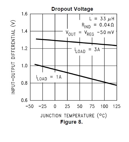

I was reading the Datasheet of the LM2596 but i didnt find anything about wich is the minimum voltage that i should have as input in order to obtain a fixed output, is to say, if i would like to have 3.6V on the output, which is the minimum voltage that i can put on the input to take this?
Thank you for your help...
