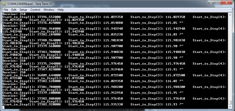

I want to get the data sent by the TDC7200 to the MSP430F5528 of the eval board and access it via the UART1.
In the board, there is a connector J6 which is not placed and in there are pins for the UART1TX & RX.
I'm trying to get data from these pins. How can I achieve this? How can I enable UCA1TX & UCA1RX?

  • I have a working version that will send out the TDC7200 calculation data through the UCSI-A1 pins. It will be released to web sometime soon. Meanwhile, I can share a pre-release. Please send me an email: vishy.natarajan@ti.com.

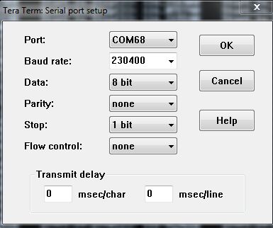

  • Jomer,
    Default baud rate is set as 230400. You can set it to other rates as well. For example, to get 115200, you need to do minor modifications to files "uart_commn.c" (uncomment line 65/comment line 66) and "uart_commn.h" files (uncomment line 38/comment line 39).
    You can observe the data sent out by using a UART to USB cable (like FTDI  TTL-232R-3V3). Connect GND, RXD to GPIO3, and TXD to GPIO4 of the board. You can use a terminal like Teraterm to observe the data. I have enclosed screen captures of data being sent out. TOFs results are sent out as shown. Most of the applications would use 1 stop, so start to stop1 data alone is valid.
    Vishy

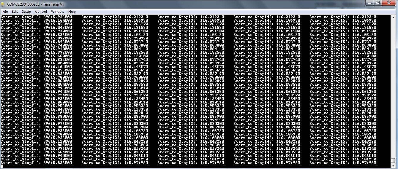

    Start_to_Stop[1]: 39615.392000    Start_to_Stop[2]: 116.139380    Start_to_Stop[3]: 116.139380    Start_to_Stop[4]: 116.139380    Start_to_Stop[5]: 116.139380

  • Hi Vishy,
    Got the set-up working. Initially had problems because of physical connections between UARTs.
    Attached is the screenshot of the output.
    Thanks again for the help.
