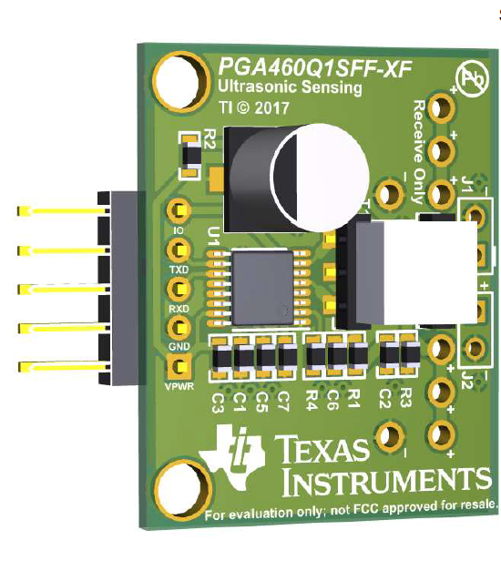

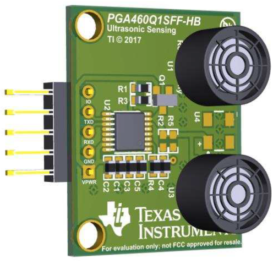

The PGA460Q1SFF is a small form factor solution showcasing single-sided PCB spacing and supporting component requirements for the PGA460-Q1 ultrasonic sensor signal conditioner. The small form factor solution is separated as two board variants: transformer driven and half-bridge driven. Both variants can be operated in either mono-static or bi-static transducer mode. A mono-static transducer mode utilizes a single transducer to both transmit and receive the ultrasonic echo. A bi-static transducer mode utilize two transducers, such that one is dedicated exclusively to transmitting the ultrasonic echo, and the other is dedicated exclusively to receiving the returning ultrasonic echo.
PGA460Q1SFF-XF PGA460Q1SFF-HB
To download the output files for the small form factor solutions, navigate to the Design files section of the PGA460 or PGA460-Q1 Technical documents tab:

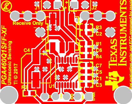

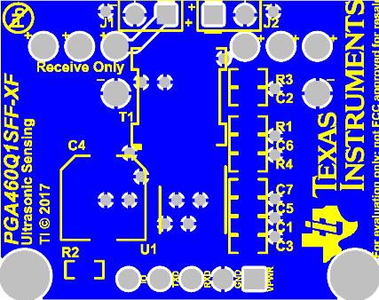

PGA460Q1SFF-XF, Transformer Mode
Schematic:
Layout:

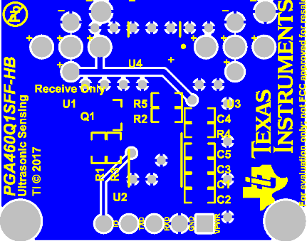

PGA460Q1SFF-HB, Half-Bridge Direct Drive Mode
Schematic:
Layout:
