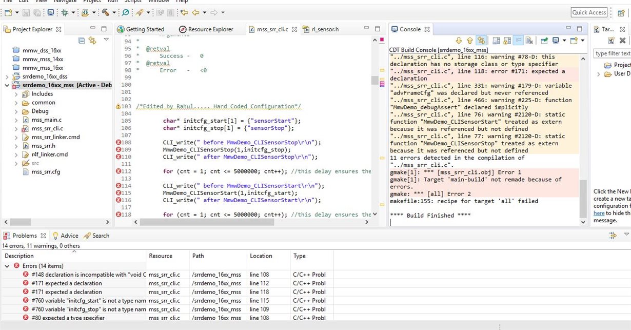

  • Hello Nitin,
    thank you Nitin your valuable guidelines
    Can you explain it how to do this, i am little confuse
    I use Shot Range Radar demo code for standalone  application development
    1.I need to modify this e2e.ti.com/.../4745.cli.c file or use it as it is (Currently i am using as it is)
    2.Rename/backup existing cli.c source file in mmwave_sdk_01_02_00_05\packages\ti\utils\cli\src directory (there are 2 file's cli.c and cli_mmwave.c)
    3.Place new cli.c

    5. In mss_srr_cli.c, i comment static int32_t SRR_MSS_CLISensorStart (int32_t argc, char* argv[])  and static int32_t SRR_MSS_CLISensorStart (int32_t argc, char* argv[])  function
    6.I am inserting this in mss_srr_cli.c file
    char* initcfg_start[1] = {"sensorStart"};
    char* initcfg_stop[1] = {"sensorStop"};
    CLI_write(" before MmwDemo_CLISensorStop\r\n");
    MmwDemo_CLISensorStop(1,initcfg_stop);
    CLI_write(" after MmwDemo_CLISensorStop\r\n");
    for (cnt = 1; cnt <= 5000000; cnt++); //this delay ensures the sensor stops
    CLI_write(" before MmwDemo_CLISensorStart\r\n");
    MmwDemo_CLISensorStart(1,initcfg_start);
    CLI_write(" after MmwDemo_CLISensorStart\r\n");
    for (cnt = 1; cnt <= 5000000; cnt++); //this delay ensures the sensor starts
    it's not working ....?
    Please guide to resolve this issue
     Regard's ,
    Rahul

    I don't want to use this OOB, i need to make changes in PPL_count demo code which we modify as per our requirement
    My end application is this(sense the Motion(People) and trigger GPIO2 ) there for i need to modify that One, can you help to do this (But need to run this demo code standalone without GUI, no need to Configure every power on)
    i am Using ES.2 EVM (IWR1642) and SDK2.0
    Rahul
