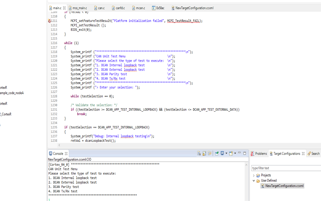

I am using awr1642 . while running CAN driver code I got the output which attached. when i select the option it is not giving any output.
How can I change testselection verialble.  please guide me.

    If console doesn't take user input then better to halt the MSS core from CCS and set that variable manually as required value.
    After core halt you can hover over that variable and set new value or add that variable in expression window of ccs and set new value.
