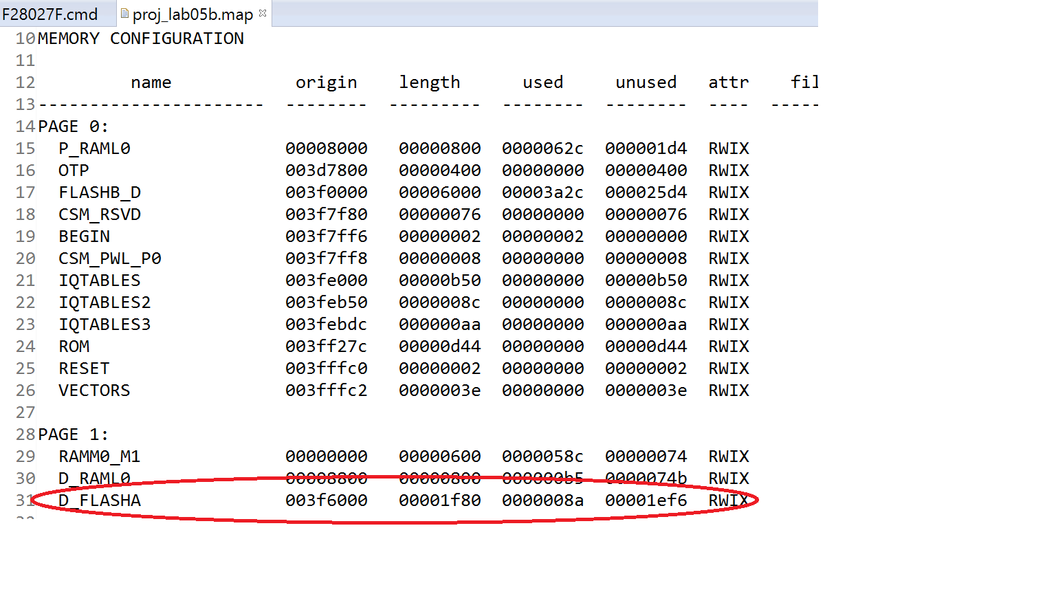

My customer took F28027F to develop E-bike controller, they took lab5b and add some applications. Now they finished development, and need to take C2000 Gang to programming Flash, and need to converter .out to .hex for C2000 Gang, but they met a problem that:

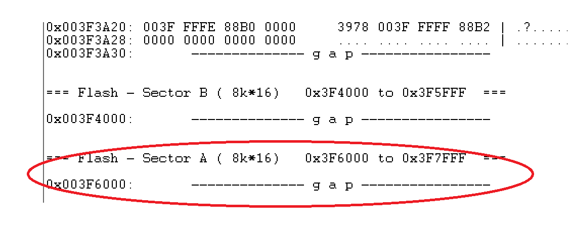

When got .hex use CCS's post-build steps(Create flash image: Intel-HEX), can get the .hex file, but in Flash section A, can't find any data! I look their CMD file and Map file, all showed that there were some data in Flash sector A, but can't find it in .hex file. please kindly find CMD and map and .hex pic as blew:
As pic above, you can see that from map and CMD file, that Flash A have some data, but .hex file lost Flash A's data. Why? Would you give me some suggestion? thanks!

    "From the snapshots, the MAP file and linker command file looks correct, but I’m not sure why the hex file is omitting the page 1 sections.
    We might have to look at the command that is generating hex file and see if any additional parameters/options are needed when invoking scripts.

  • If the last picture is of the .hex file, it doesn't look like the format that hex2000 would write. Is it hex2000 or SDFlash being used to generate the hex file? If SDFlash, I note the comment in the middle picture says that the objects must be on page 0, but neither the load nor run addresses are.

    I took CCS's post-build steps command to get HEX file, the command is:
    "${CG_TOOL_HEX}" -i "${BuildArtifactFileName}" -o "${BuildArtifactFileBaseName}.hex" -order MS -romwidth 16

    I test the Demo project in motorWare(lab5b), I haven't do any change, but it met the same issue as customer met. I wish can send you the whole project, but our motorWare distribute all files in many folders, so I just can send main.c and CMD file as blew. Suggest to download motorWare in TI web and import the project lab5b into CCS, and use post-build steps to get HEX file. Thanks!

  • I took CCS's pot-build steps to generate the HEX file, yes, it call Hex2000 to generate HEX file. Thanks!
  • Here is what happens.
    The section .econst is on page 1, and has initialized contents.  All other initialized sections (like .text) are on page 0. The hex utility converts the .econst section, but because it is on a different page than the rest, it is in a separate output file.  You get the output files proj_lab05b.hex (page 0) and proj_lab05b.i10 (page 1).  The .econst section is in the second one.
    The hex utility is documented to behave this way.  In the section titled Partitioning Data Into Output Files of the C2000 assembly tools manual, it states ...
    If your *.out file contains sections allocated to multiple pages, separate output files are generated for each page.
    This is very obscure, and not user friendly.  That being the case, I filed an entry in the SDOWP system, with identifier CODEGEN-1699.  It does not report a bug, but requests an enhancement to the hex utility.  Whenever the hex utility creates additional output files that are not explicitly named by the user, issue a warning message.  You are welcome to follow this issue with the SDOWP link below in my signature.
    Fixing this issue requires changing the linker command file so that no initialized sections are on page 1.  The team that releases Motorware is responsible for the linker command files in this case.  I will start a conversation with them on the best way to handle this requirement.  To get you going in the mean time, you can make these changes to F28027F.cmd.
    • Remove "PAGE 1" in the MEMORY directive
    • Change all other instances of "PAGE = 1" to "PAGE = 0"
    Now everything will be on page 0.  I verified the hex utility output now has the contents of .econst in it.  Otherwise, I cannot verify this change causes no other issues.  But I'm very confident it will work.
    Thanks and regards,
    -George
  • George,
    Thanks for your answer! I will suggest customer to make changes to f28027.cmd. Thanks!
