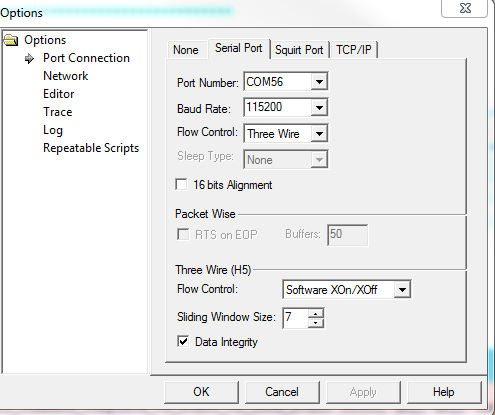

  • I changed the CC board used and it worked fine. Have given the old CC board to ti for debugging. Also found that HCI tester is only supporting ports with single digit number so edited the port number in device manager and this made HCI tester tool recognise my reader. Thanks for your support.
    I am also facing same issue for my Boost-CC2564MODA board.
    It is not returning any event after sending the command. Below is the COM port configuration I am using in
    HCITester application.
    What could be the issue here?
    Vishal N
