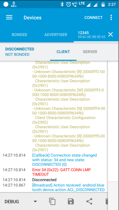

I am working on host test with SDK 1.50.00.58... i added simple peripheral services in code and testing peripheral gap role through btool.
I am able to do advertisement able to make connection with mobile generic app (connection via mobile app) and its getting connected, but after sometime ( 30 sec ) connection gets disconnected and error comes on app debug log is "Error 34 : GATT CONN LMP TIMEOUT"
Pl find screenshot below..
Pl find the sequence of commands i give

  • Hi Bhavin,
    This seems to indicate a timeout in a LL control procedure. What does your BTool log look like for this connection? What phone and android version is it?
    Does it work with regular simple peripheral towards the phone?
    Aslak
    Yes it works with regular peripheral example.
    I use Motorola G5sPlus and Android version 7.1.1 i do use.
    See the below log....

  • Hi Bhavin,
    It looks like you didn't reply to the GAP_LinkParamUpdateRequest. Does that seem likely? When you are using HostTest you don't have the peripheral.c GAP Role abstraction to respond for you.
    The correct response here would be to send GAP_UpdateLinkParamReqReply, with the same parameters as you received.
    Aslak
  • Hi Aslak,
    Done!!! Working ok now.
