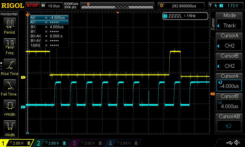

In my board I use I2C for many slaves, sometimes after running some minutes suddenly the I2C blocked at the Semaphore pend in the I2C driver
"SemaphoreP_pend(&(object->transferComplete), SemaphoreP_WAIT_FOREVER);"  (I2CCC26XX.c)
and stuck the system. I am working in Blocking mode, with 100 kHz speed.
After some research I connected the SDA and the SCL to oscilloscope, then I noticed that sometimes the I2C transfer miss a clock (See the attached photo)
I have no idea what cause the problem and have no idea how to solve it, each time this happens my system is stuck.
