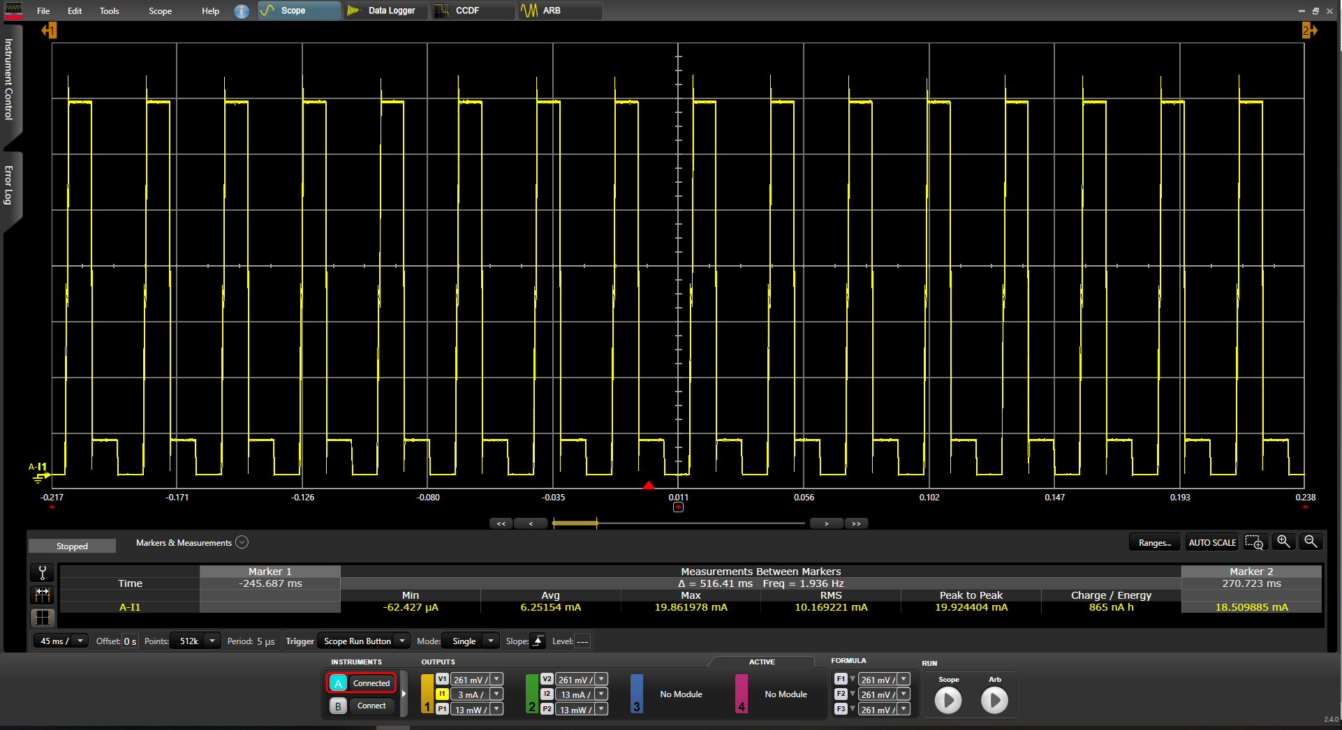

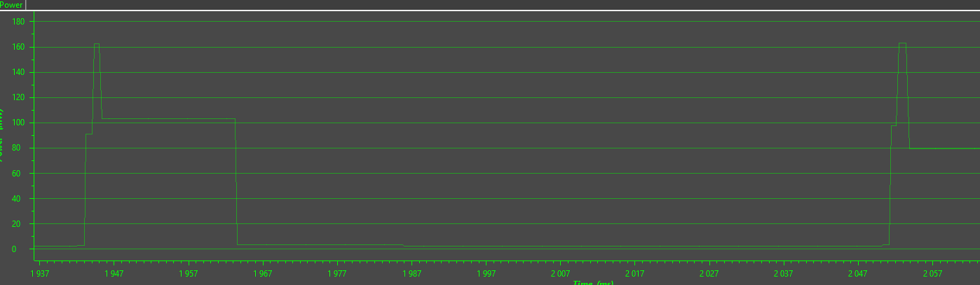

I'm currently sampling the CC1101  to use in one of our R&D projects with ultra-low-power targets
Right now, I'm just test the TX mode to check current profile of a buffer transmission.
Settings looks simple :
  • Datarate : 76.6kbaud
  • Frequency center : 868.8MHz
  • TX Power : 10 dBm
Main loop is :
  1. Send 10-bytes packet (+ 4Byte preamble  + 4Byte sync word)
  2. Send CC1101 Sleep as soon as it finishes
  3. Wait 100ms
I've hooked up the CC1101 (using a breakout module) with a MSP430FR5969 launchpad
I measure current with EnergyTrace on Code Composer Studio
Looking at (wake-up + pll lock + airtime), I'm expecting TX current between 2-3ms
I see a peak with that estimate duration, but after that, there is a ~18ms steady current that I do not understand (see screenshot below).
Any idea where it is coming from and why it happens ?
Thanks in advance.
  • The figure showing the current consumption is missing, please re-post the picture.
    I've edited the main post with and re-added the screenshot

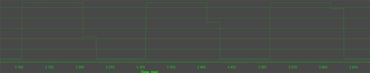

  • Hi Siri,
    Thank you for taking time to look into this.

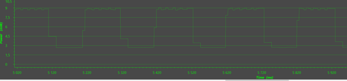

    I'm not doing anything with the MCU (low-power state) right now. MCU is waiting in active state right now for the test. I'll implement this later. MCU power is around 3mW when main loop is empty.
    I'm not sure to understand what you mean by "y axis".
    For the first test (no radio, sleep/idle), power profile shows the 20ms current after the Idle period
    For the second test (idle/tx), we clearly see the different mode in the power profile. However, there are some steady current after the TX (6-7ms) (see below)

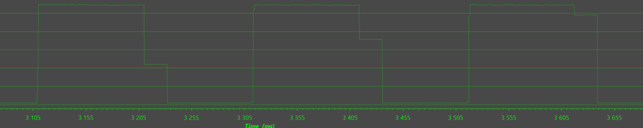

    So I made a third test by going between TX and Sleep with the loop doing :
    SpiStrobe(CC1101_SIDLE);
    SpiStrobe(CC1101_SPWD);
    delay(100);
    SpiStrobe(CC1101_STX);
    delay(100);
    And there, we see again the current, but with a longer duration (around 20ms) (see below)
    So it looks like the weird current is maybe not related to the TX, but to the entry within resting state (Idle/Sleep) and that its duration is depending on the chosen state

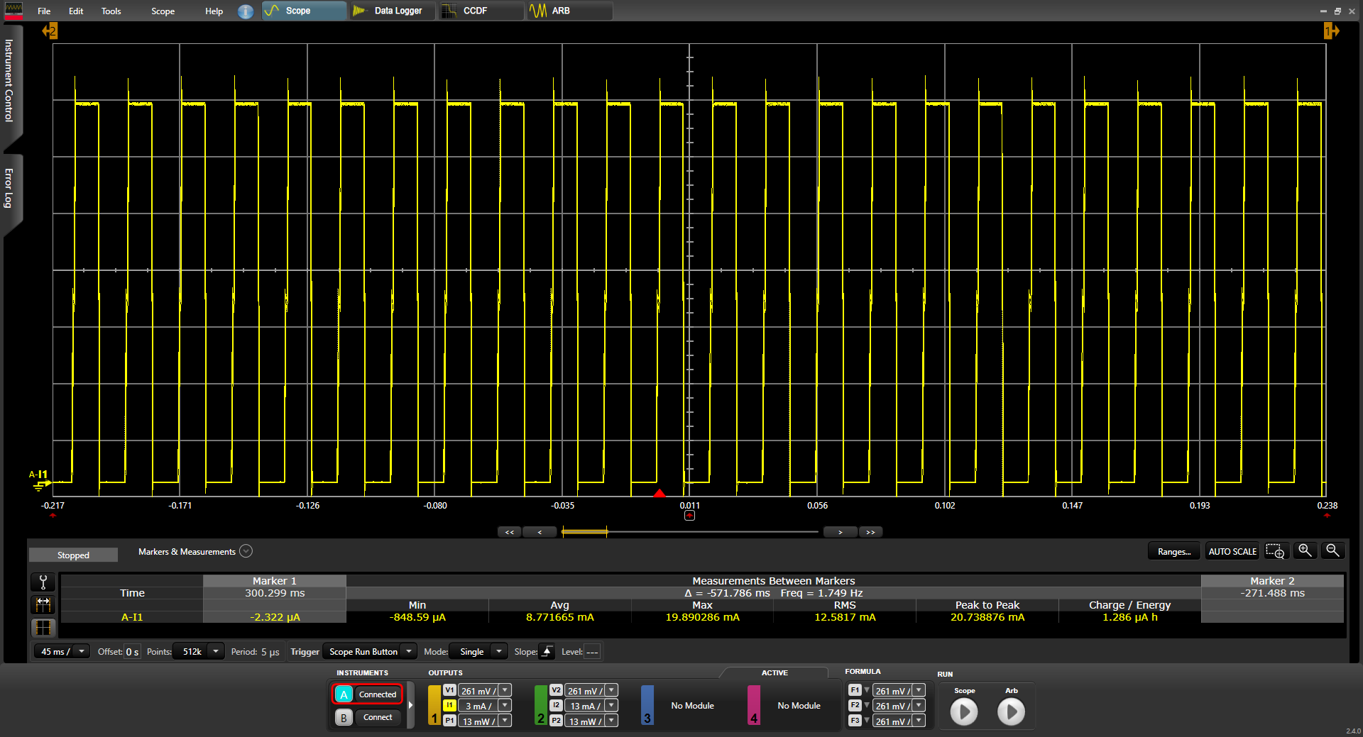

  • Hi Siri,
    Thank you for the answer.
    I made the 3 tests you indicated.
    For every test, there is nothing else that active SPI : no interrupt, no timer ...
    - Init SPI / IO => config CC1101 => STX => LPM3 : I get a stable 37.5mA
    - Init SPI / IO => config CC1101 => SLEEP => LPM3 : I get a stable 270nA
    - Init SPI / IO => nothing => LPM3 : I get a stable 2.0mA
    For the configuration, I took the default SmartRF Studio config (apart from changing power to 10dBm instead of 12dBm)
    I tried the previous test (STX -> IDLE -> SLEEP 100ms loop) with the SmartRF Studio and again, I get a ~40ms current after the 100ms of STX.
    Worth noting, it seems that the current is not always the same value but it look like there is a patten
    Romain

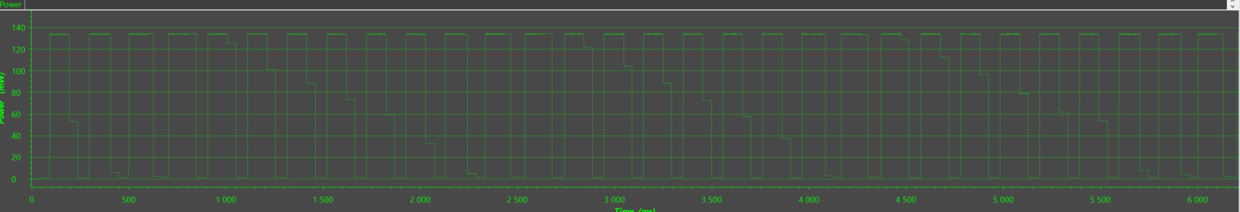

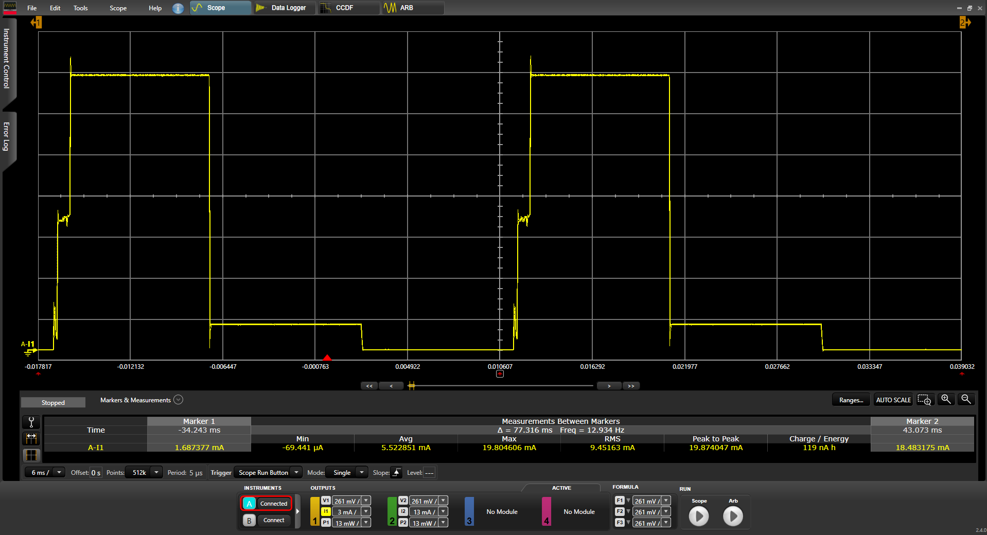

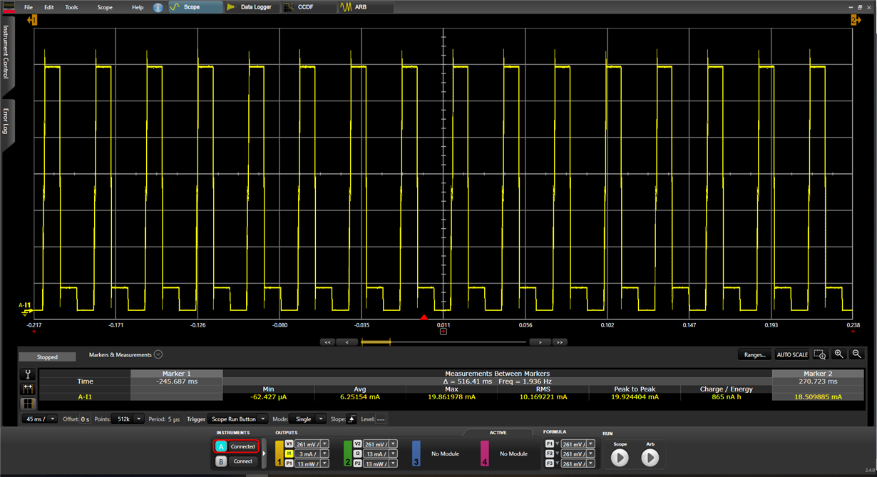

  • I did some tests on the TrxEB + CC1101EM.
    First test:
    void main(void)
        uint8 marcstate, fscal1;
        // Initialize MCU and peripherals
        initMCU();
        // Write radio registers
        registerConfig();
        while (1)
            trxSpiCmdStrobe(CC1101_STX);
            waitMs(10);
            trxSpiCmdStrobe(CC1101_SIDLE);
            waitMs(10);
            trxSpiCmdStrobe(CC1101_SPWD);
            waitMs(10);
    The current profile look like this:

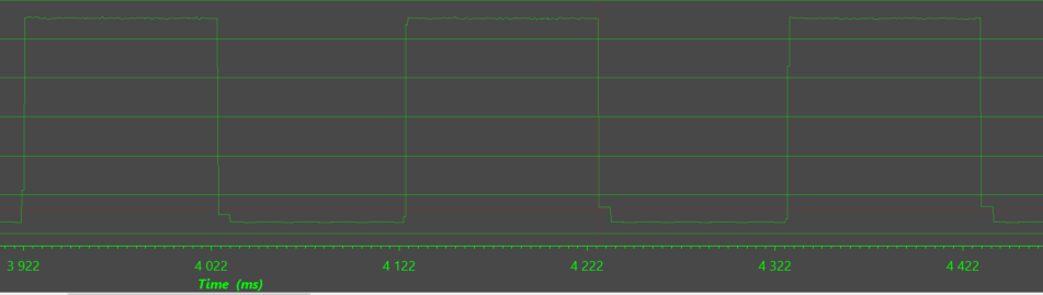

    I then change the code:
    void main(void)
        initMCU();
        registerConfig();
        while (1)
            waitMs(10);
            waitMs(10);
    As you can see, all current plots looks like expected.
