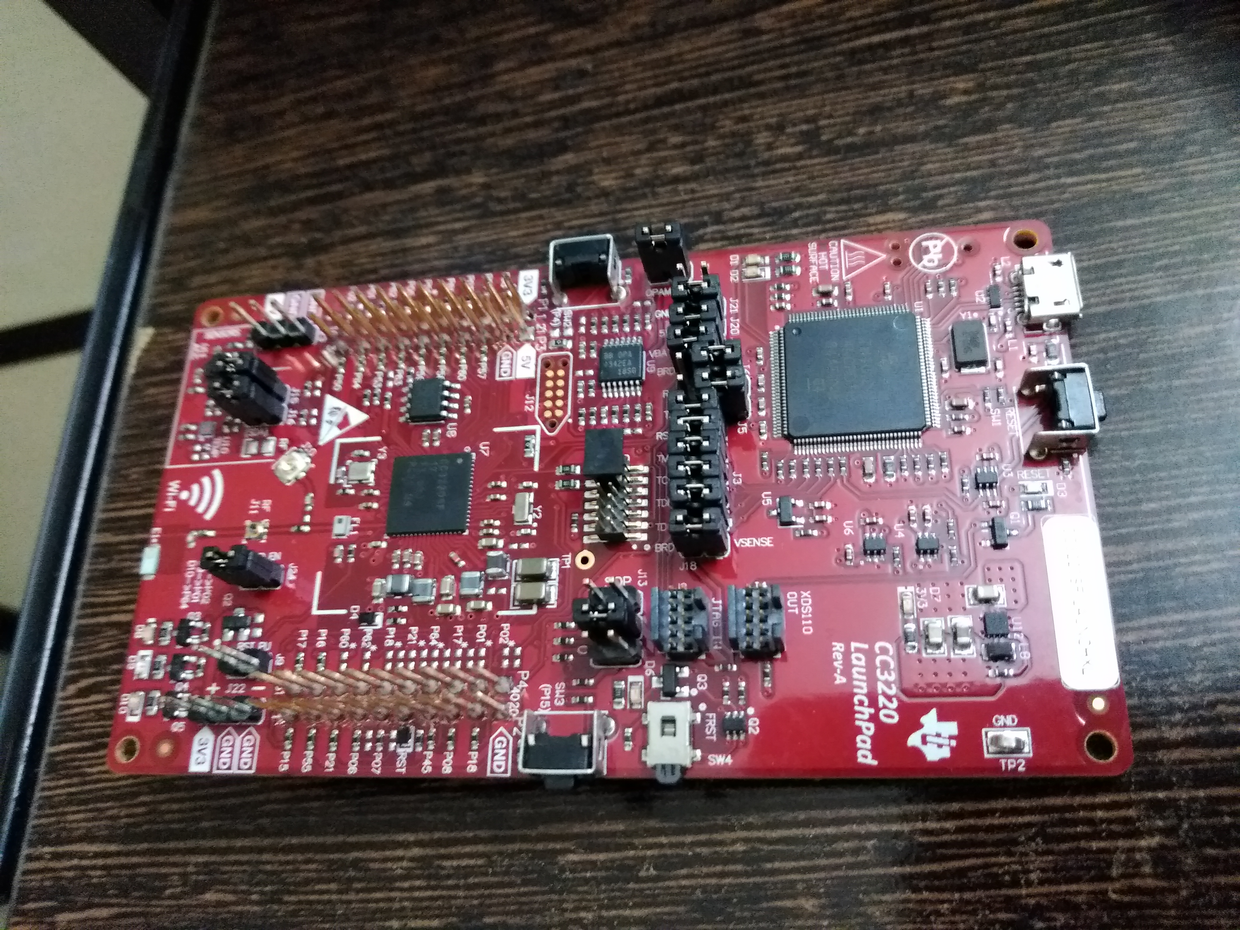

I am trying to interface fingerprint sensor R307 with CC3220SF launchpad. The sensor works on UART communication, I am using hardware uart for communiction.
I have got the library for R307 from
This code get complied without errors in Energia. I am using energia version 1.6.10E18. I can able to upload and see the working in serial monitor.
When I reset the board, code doesn't run again. I don't know wheather the code get burned of flash or not. I have tried removing the SOP jumper and tried to reset. Still the code didn't run.
Then I tried importing this energia sketch into code composer (version 8). All the codes and libraries got imported , I can able to build without any errors. When I try to debug the code works good.
Then I burned the code using Uniflash (version 4.5.0.2056). Then after resetting, I don't see the code running. During running the code will print the logs in UART. I have tried the bin from both debug and release folders under project.
I have attached the image of launchpad to verify the jumper setting. What could be the issue?
Can any one please guide me on this.
