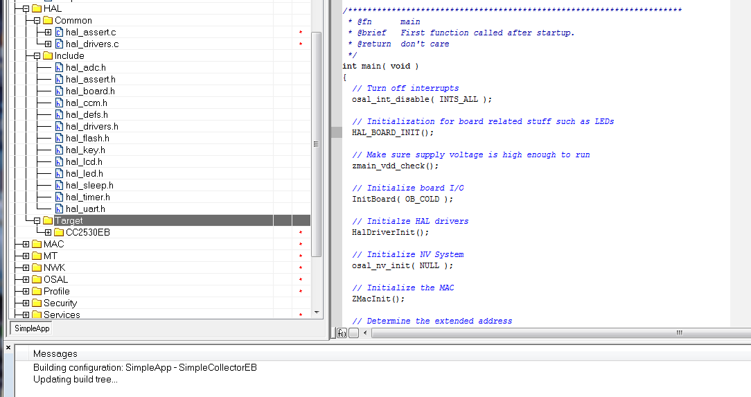

    The first thing I need help with is modifying the sensor example coord to work with the 2531 usb ... I want to see the data the sensors are sending appearing on my serial port for reading ..
    Thanks!
    Start with the following thread.
    Basically, what should be done is replacing target in HAL->Target in the project
    from CC2530EB to CC2530USB (following this path:
    ...\Texas Instruments\ZStack-CC2530-2.5.0\Components\hal\target\CC2530USB.
    Then addind "additional include directories" in project options.
    Anyhow, first thing replace the HAL->Target section with CC2530USB, then try
    to compile (there will be errors, but I want you to post these errors so I could
    guide you step by step).
    Good luck
  • Thanks Igor.. this is what I did so far:
    1) loaded SimpleApp and chose SimpleCollectorEB
    2) Project->General Options -> Target -> Device changed to  CC2531F256
    3) Project -> C/C++ Compiler -> Preprocessor changed:
    $PROJ_DIR$\..\..\..\..\..\Components\hal\include
    $PROJ_DIR$\..\..\..\..\..\Components\hal\target\CC2530USB
    $PROJ_DIR$\..\..\..\..\..\Components\hal\target\CC2530USB\usb\library
    $PROJ_DIR$\..\..\..\..\..\Components\hal\target\CC2530USB\usb\library\cc2531
    $PROJ_DIR$\..\..\..\..\..\Components\hal\target\CC2530USB\usb\class_cdc
    With these changes it compiles perfectly .. but not sure if it picked up the correct 2531 HAL changes.. is there anything else I need to do?
    Thanks!
  • To add the OSC32K_CRYSTAL_INSTALLED=FALSE compilation flag
    in  C/C++ Compiler -> Preprocessor-> defined symbols (as the 32KHz crystal
    is absent on cc2531 USB dongle).
    In General Options -> target select the CC2531F256 instead of CC2530F256.
    Compile and download this FW into cc2531 USB dongle. then plug it to PC,
    at this point WinOS should recognize this device as CDC
