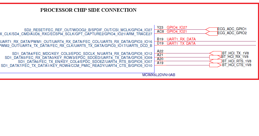

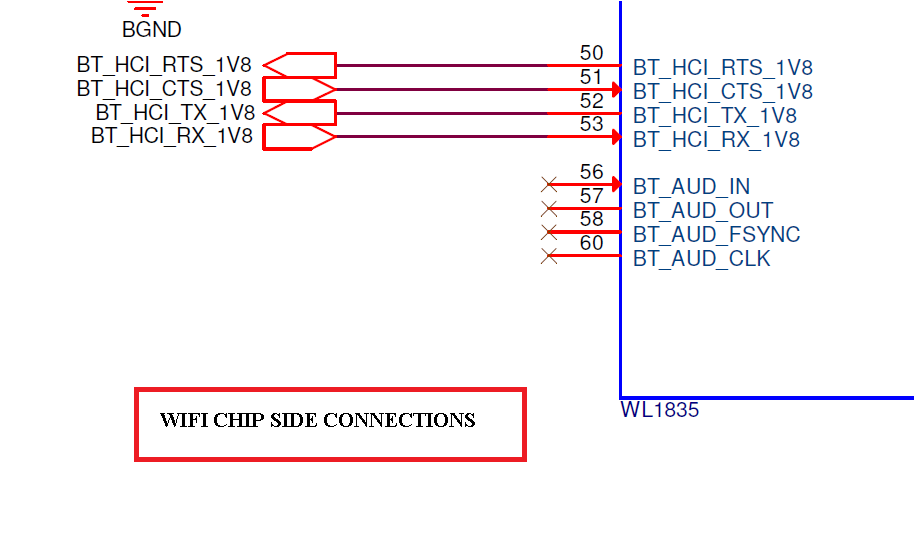

Please verify the Bluetooth connectivity schematic for iMX6SL processor with WL1835.  Pin Direction wise its connected correctly. For example

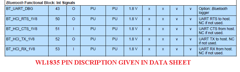

1)  "RTS"  signal is output direction for  WL1835. But in iMX6SL processor "RTS" pin is input direction. So i connected both RTS processor pin to RTS WL1835 pin.
2)   "CTS"  signal is input direction for  WL1835. But in iMX6SL processor "RTS" pin is input direction. So i connected both RTS processor pin to RTS WL1835 pin.
3) "TX" and "RX" signal has been swapped at both the ends.
Please confirm my connectivity is correct or not?

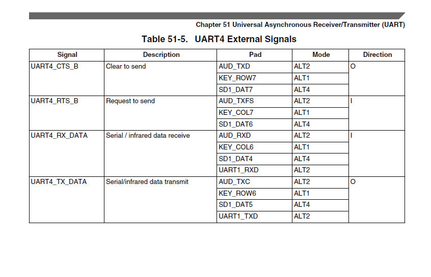

  • But In the iMX6SL (HOST) side RTS is not the direction of "output".
    and CTS is not the direction of "input". This direction pin (input and output) totally reversed in TI OMAP processor. Please refer the user manual which i have mentioned below link.
    www.freescale.com/.../prod_summary.jsp;tab=Documentation_Tab&pspll=1&SelectedAsset=Documentation&ProdMetaId=PID/DC/i.MX6SL&fromPSP=true&assetLockedForNavigation=true&componentId=2&leftNavCode=1&pageSize=25&Documentation=Documentation/00210KscRcb%60%60Application%20Notes&fpsp=1&linkline=Application%20Notes&site_preference=mobile
    Please click the above link and download "IMX6SLRM" reference manual document.. please check the page no 2929..
    Sivakumar
  • Sorry for the trouble you couldn't able to click the previous link.  Anyway i made a screen shot i had mentioned above.
    This is the UART pin configuration for iMXSL processor. Please refer the RTS and CTS direction. Based on our processor
    CTS signal is output and RTS signal is input. But direction totally reversed in some other processor like omap.
    please tell me my approach is correct or not?
  • Siva,
    You are correct. On i.Mx6 the CTS and RTS lines are reversed compared to TI nomenclature. So you connect CTS to CTS and RTS to RTS.

    i need one more doubt in in this scheme.  according to the above attached images , yes already connection done,  " processor CTS  connected with bluetooths CTS"  and "RTS of processor connected with RTS of bluetooth. what about TX and RX  pins of processor for above configuration.? below i have mentioned in WL1835 PIN description block. Please compare both processor image description and wifi data sheet image pin description.
    As per both image please send connectivity of Bluetooth circuit.

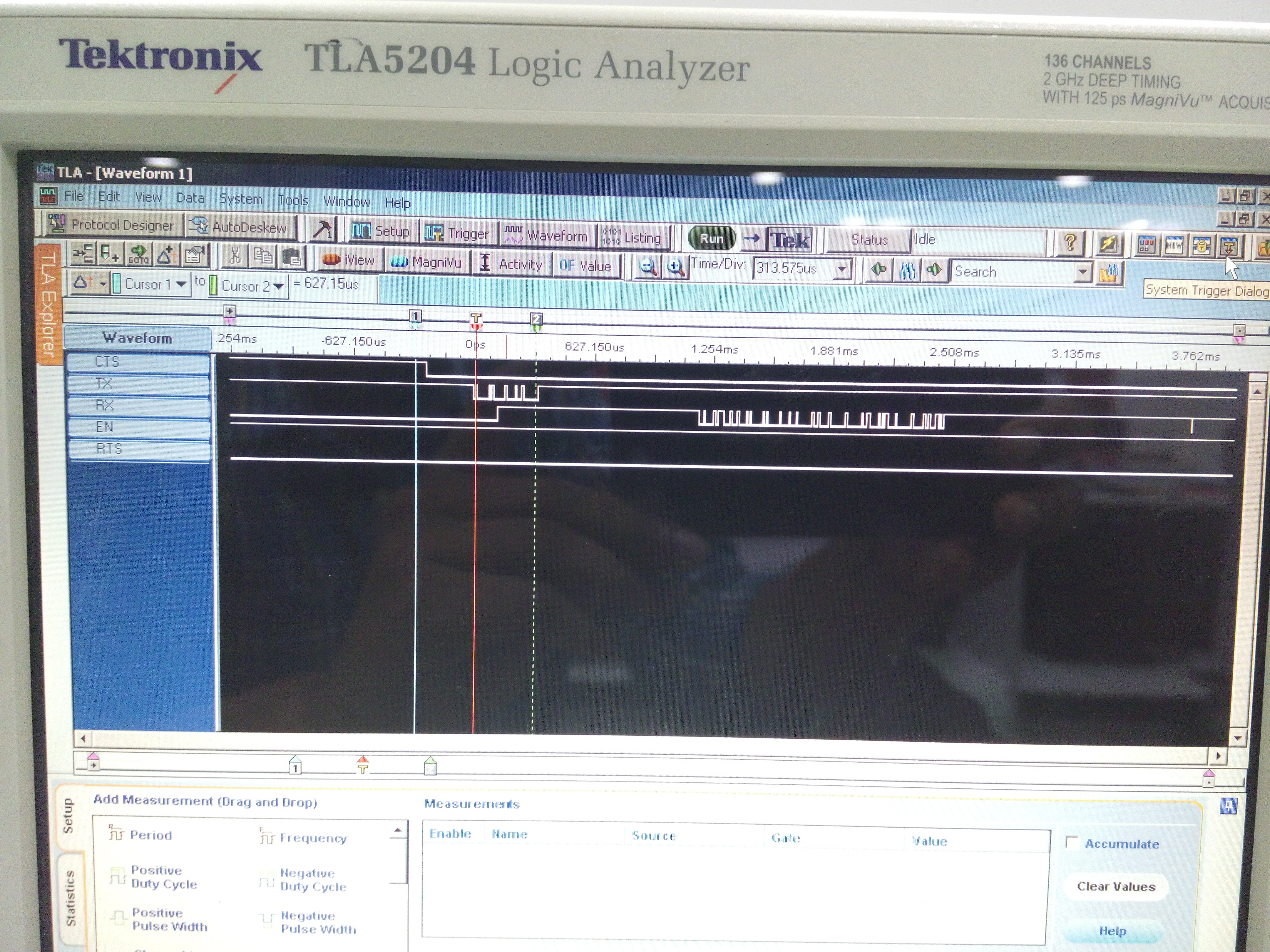

  • Hi lain,
    now i can see the "Found a Texas Instruments' chip!" in the hyperterminal. but after that i am getting "Initialization timed out." below i have mentioned the log file which i am getting in the hyper terminal.

  • Hi lain,
    below i have attached the Logic Analyzer capture files for all the lines such as TX,RX,CTS,RTS.
    If you have any suggestion please let me know.  Still we are facing the problem in Bluetooth communication.
    Sivakumar
  • On the assumption that this is all the UART traffic you see then this is the HCI command to read local version and the response which is what identifies the chip type.
    On identifying the TI device it will try and download the .bts file. Normally this file will ask for a switch to 3Mbaud to speed up download.
    So you may be asking for a baud rate mismatch with your command line.
