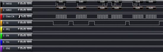

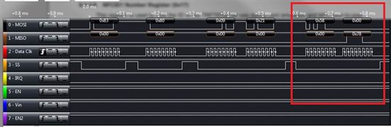

Upon power-up, there appears to be random values loaded into the NFC Target Detection Level Register (0x18). The default value for this register should be 0x00. When this register is loaded with random values, it sometimes (depending on the value) interferes with the TRF7970A's reader functionality.
NFC Target Detection Level Register (0x18) being read upon power-up. Showing Random Values:
NFC Target Detection Level Register (0x18) being read upon power-up. Showing Correct Value (0x00):
Work Around:
Clear the NFC Target Detection Level Register (0x18) upon power-up by writing a 0x00.
We've tested this on TRF7970's that were currently in this state or returning 0 bytes in the FIFO Status Register, and were able to get the to operate correctly with out having to power cycle.
I recommend making this small modification to your firmware at power-up initialization to avoid and fix this issue.
