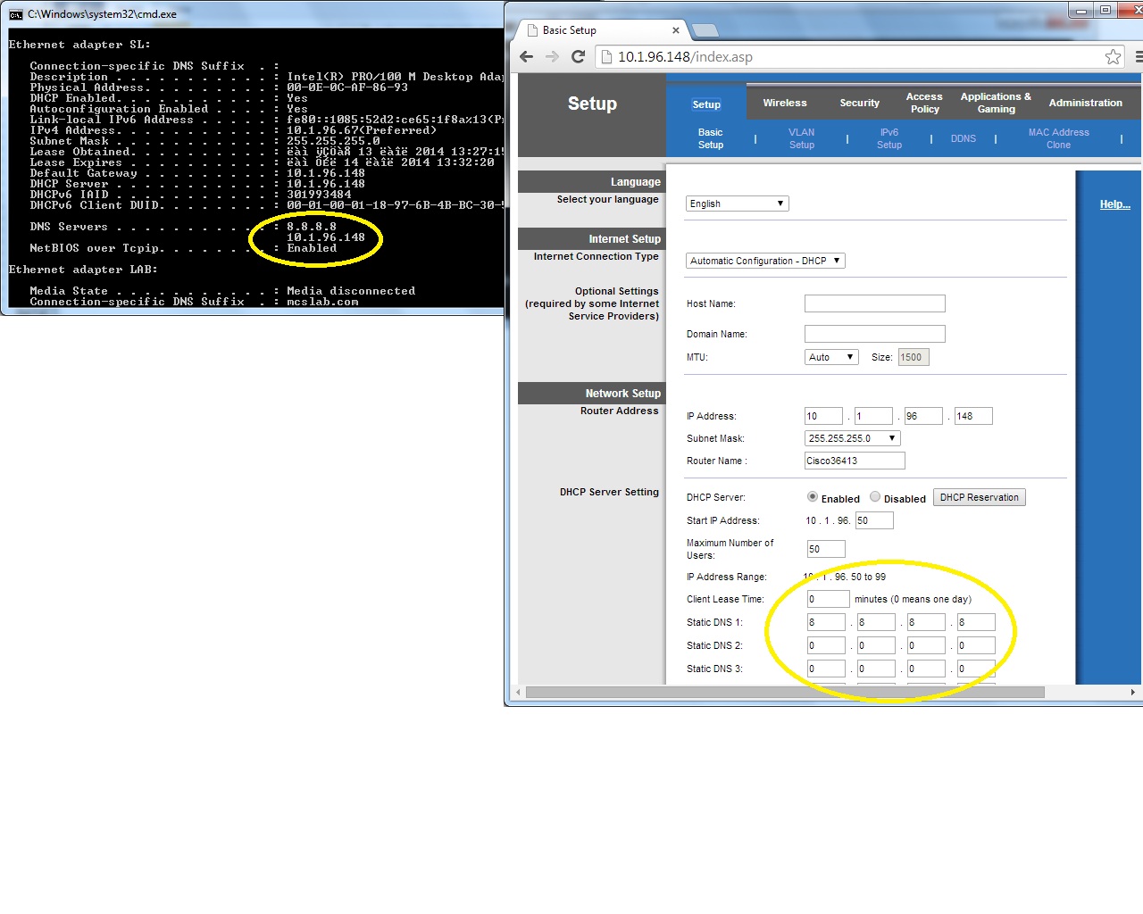

    With the Cisco wireless router, do you have anything else connected to it, for example a windows machine?
    If you have a Windows machine connected, open a command prompt and type in "ipconfig /all" and see what you get for the DNS Servers and Default Gateway for the Wireless LAN adapter. Are these IPv4 addresses or IPv6 Addresses?
    When setting up station mode for the CC3200, are you using DHCP? If so, make sure that the Cisco Router provides DNS address when it provides an IP Address during the DHCP, this may be a settings of some sort.
    Also check any other settings, for example you may have set the DNS manually on your Windows Machine or perhaps you are using a Dynamic DNS or something else that the CC3200 is having issues with. Basically, try and look into what might be different/non-standard within the DNS setup for your router.

    1) both my router and ipconfig /all shows DNS servers address and default gateway

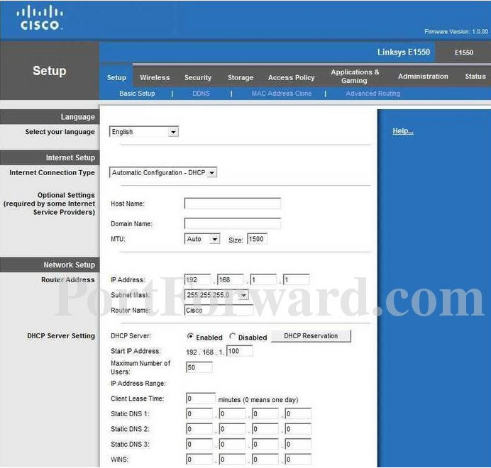

    On the other hand, i finally see an option to configure static DNS on the router configuration page, I probably will try setting the static DNS to what is shown in ipconfig /all as well. There are currently showing 0.0.0.0.

    Hopefully setting the DNS will work. The addresses you are getting on your computer by doing ipconfig /all were most likely set manually on the computer, which is why the computers works with DNS and the CC3200 does not.
    Let us know if this resolves your problem. We need this to work on all routers!
    Glenn.
  • Yup, i hope so too. Well on my computer, the setting is "obtain dns automatically", so it is not manually set either. if changing the router static DNS works, i will need to studyon how other clients can work without it. :)
  • Unfortunately, changing the DNS doesn't work either. I use wireshark to capture the DHCP traffic and confirmed that the router return all correct DNS records during DHCP offer stage.

  • All,
    With the help of Chage we were able to identify the issue.
    It seems that if the Access Point DHCP provides 3 DNS address, the device will worngly detect it as no address and return error on the sl_NetAppDnsGetHostByName.
    We have identified the issue and a fix will be provided in the next service pack (few weeks from now).
    Currently it’s mainly releated to Linksys e1550 AP but it might be seen on others if configured to 3 DNS address.
    How to detect:
    • Sympthom: sl_NetAppDnsGetHostByName returns -161
    • In the IP acquired event the DNS address is euqal to zero – that will mean there is and issue with the DNS address
    How to overcome:
    • In most AP it’s enough to set 2 DNS address (not 3)  - that will solve the issue
    • If you still observe issue please send us a message an we will look into it
    Nir Nitzani

  • Hi, I have a Linksys E2500 and am experiencing the same issue.  I tried manually entering DNS servers into two of the three slots but it didn't seem to help.  I'm not sure if I misunderstood "In most AP it’s enough to set 2 DNS address (not 3)  - that will solve the issue."  Could you please clarify how to get DNS working?
    Whether there is an existing work-around or not, I'm looking forward to the service pack since I would like to use the CC3200 in a consumer product, and broad compatibility is a must.
    Thanks!
  • Hi NatureTM,
    do you have another PC (windows) that connected to the same AP? if yes, can you run ipconfig /all to verify the number of DNS server returned?
    I know some linksys AP will return 3 DNS even though only 2 configured in the setup.
    When you configure Linksys E2500 with 2 DNS addresses, he actually  send 3 DNS address,  the 2 you configured and its own IP address.
    Meanwhile, till the SP please configure only single DNS address.
    In the attached jpeg , you can see that single DNS address is configured (8.8.8.8), but ipconfig show 2 addresses 8.8.8.8.+ the AP  IP address

  • Even when entering only one IP in the "Static DNS" settings fields, DHCP still returned 3 IP addresses.  I had to change my internet setup at the top of that page to use a static IP, and only enter one DNS server there.  It looks like the static DNS settings were overridden by the internet configuration.
    Still, you gave me enough direction to get the CC3200 DNS client working.  I appreciate the fast response!
