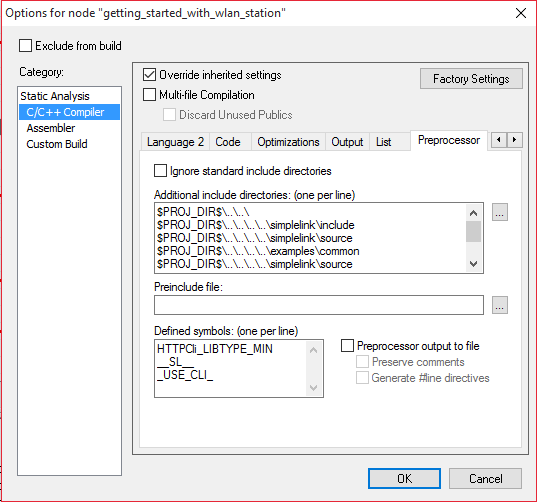

  • Hi Otopol,
    You need to compile only httpcli.c, httpstr.c, ssock.c. Remove/exclude remaining file from project.
    Also seems you are trying to compile with RTOS that we currently not support for CC3100. Please compile http library with following option:
    HTTPCli_LIBTYPE_MIN
    __SL__
    and compile http application with __SL__ option
    Aashish

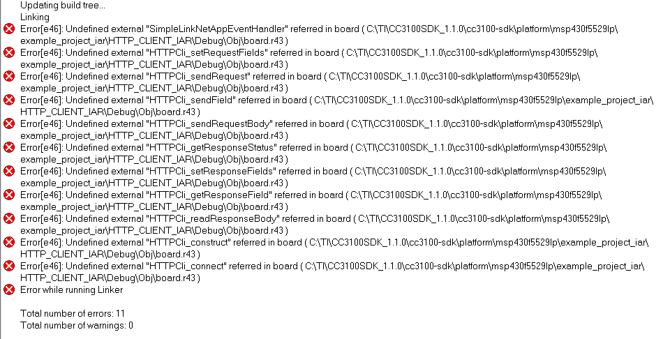

    I'm having trouble using HTTPCli library in IAR.
    As mentionned, I added build flag to HTTPcli Library :
    If I add my library to workspace, Build doesn't work (ti/net/http/httpsrv.h file not found). But if I only keep library in included path and remove library files on workspace, I does build right... Until this new problem :
    linker error :
    Have you any idea to make link step work to use HttpCli lib in IAR ?
