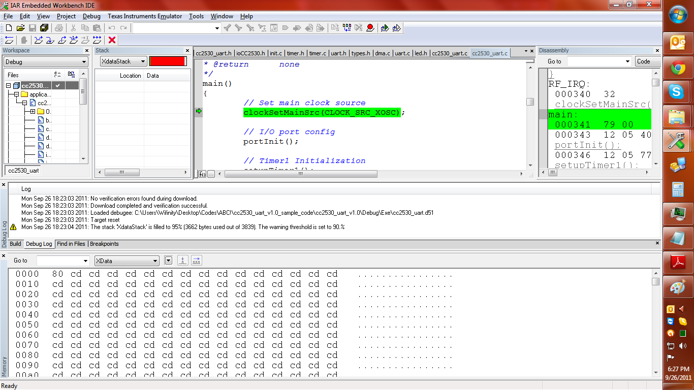

  • The following is the IAR Workbench debug screenshot. It is puzzling to see that the XData stack warning comes up even though the memory window shows only initial values in the stack. Also, this is seen even before the first instruction in main() executes.
  • In the project options dialog, try unchecking the option to run to main.  Then reload code and see if the same error exists at the moment you are at the reset vector.  If it doesn't, see if you can step through the code to find the point where it fails.
    The picture you post is curious as normally there isn't any RAM at address 0x0000 in XData space.  This data should be flash data showing through in the unified memory map but I don't see anything that looks like code here.  The 0x80 value at 0x0000 should be your reset vector and should match your dissambly window at this point.  How the debugger even gets to main is a bit of a curiosity.

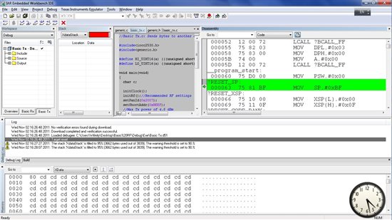

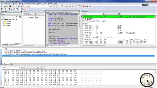

    I've disabled the "Run to main" feature. The stack warning still comes up and this time on reaching "__program_start".
    The two images below are:
    1. Screenshot at reset.
    2. Screenshot at reaching __program_start, i.e. after executing the first instruction.
    3. On reaching ?RESET_SP, i.e. after executing second instruction.
    Thereafter, the stack remains full to 95% (3662 B) till the end of the program. As evident from the memory area seen above in each screenshot, they are on their initial values.

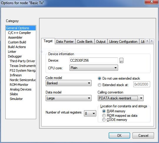

    I've changed the "Calling convention" in the General Options. It was originally at "XDATA stack reentrant". I changed it to the only other option available viz. PDATA stack reentrant. I don't see the warning anymore but I'm worried if this will cause other issues. The change is shown in the screenshot below.
    This problem is causing a major roadblock. Any help would be highly appreciated.
