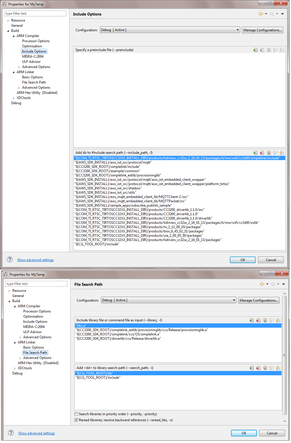

  • FYI, I'll attach my project include and linker settings:
  • I integrated the new provisioning into my own workspace and ran into similar issues.  Eventually, I just merged the new provisioning lib code into my own code base, but when I had them as separate projects I needed to make sure I had the USE_TIRTOS defined my provisioninglib project.  This should prevent the nonos calls.
    Then, it looked like provisioinlib was just using the timer as  delay, so I swapped out all the calls to timer related functions to osi_Sleep, which is the method I'm generally using as a sleep (I made sure that the task that calls provisionlib is one of the highest priority ones).

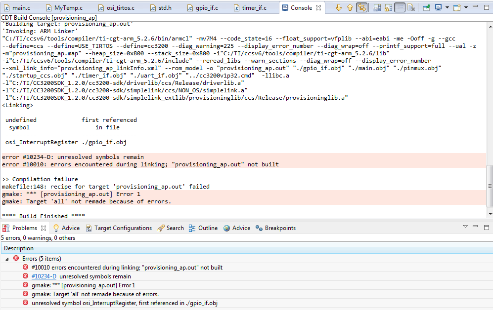

  • Thanks for the input Mark, but I'm now having problems getting provisioning_ap to build with USE_TIRTOS added to my predefined symbols.  Looks like this only used in provisioning_ap, not in provisioninglib, but I added the predefine in both projects just in case.
    I found I had to add an include path to "${CC3200_SDK_ROOT}/oslib" to the provisioning_ap project so that #include osi.h would work, however now when I try to build it gives me an unresolved symbol "osi_InterruptRegister" in gpio_if.obj.  The #include osi.h is at the top of gpio_if.c, and again the "open declaration" command does correctly map to the function in osi.h.  Is there anything outside of adding the osi include path to the project that I need to do?

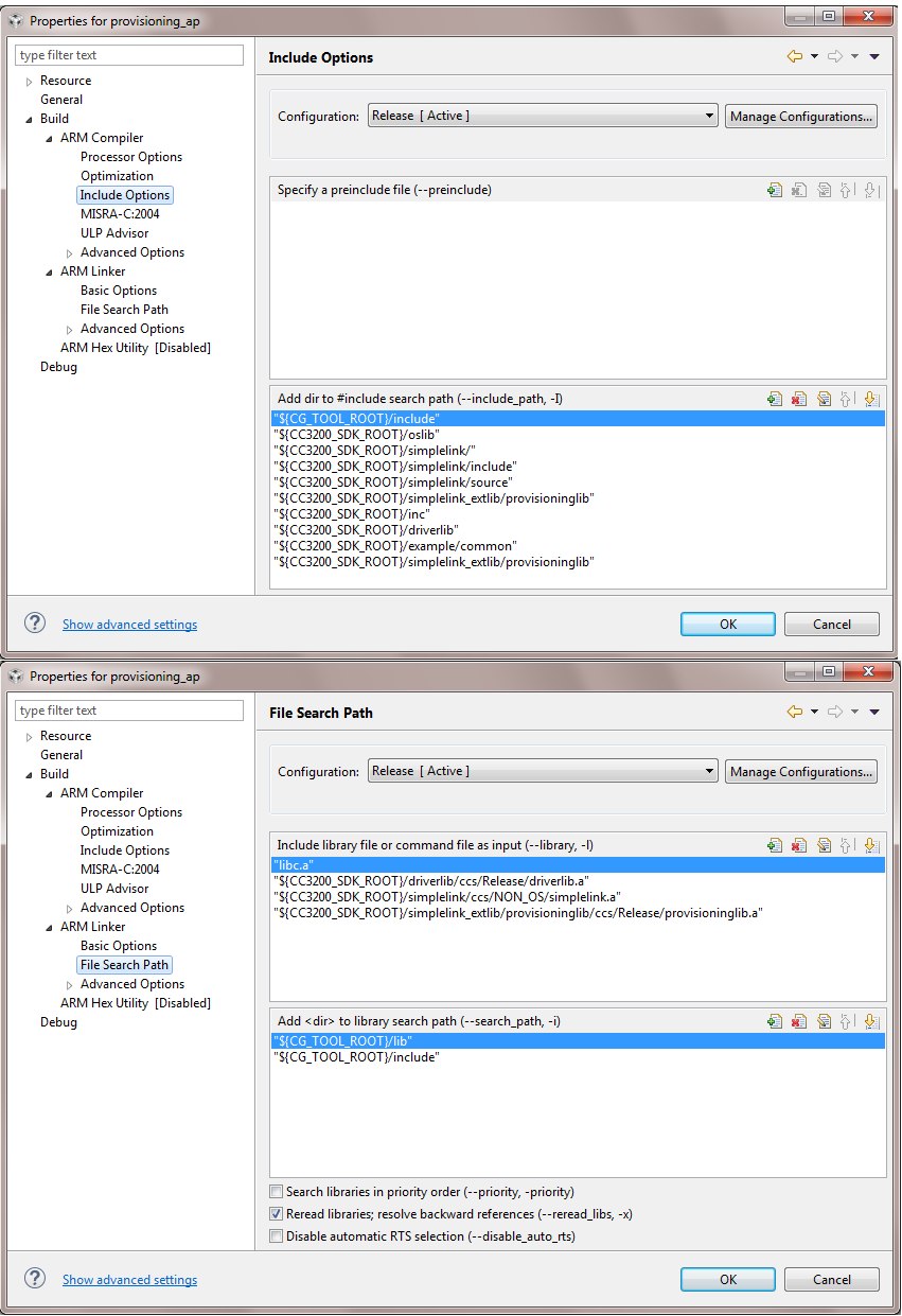

    Assuming I do indeed need to rebuild provisioning_ap project with USE_TIRTOS definied, here's some more details on trying to do this:
    Here is my provisioning_ap project settings (only modification was to add SDK_ROOT/oslib)
    Here is my problems/console windows:

  • A quick update:
    I found the same issue occurs when I try to build the provisioning_smartconfig project with USE_TIRTOS in the pre-defined symbols.
    I installed CCS, TI-RTOS, and the CC3200 SDK onto a new machine and found the same exact issues.
    It seems odd that I need to add an include path when I try to build for TI-RTOS (because it cannot find osi.h without adding CC3200_SDK_ROOT/oslib to include paths). Am I supposed to be doing something different than adding USE_TIRTOS to predefined symbols (Build->Arm Compiler->Advanced)? I was expecting to see two build configurations for these projects, but there seems to only be a "Release" configuration.
  • In the above build logs, it seems, you are linking with non-os simplelink library. Please make sure, you are linking with OS enabled libraries (provisioning_lib, simplelink).
    Did, you try with nacent SDK1.2 builds, with out any modifications. And did it work for you?

    Thank you for pointing out I had to change the simplelink.a library file path to use the OS version.  I have updated the library search path to use the OS version of simplelink.a and gotten past the previous issue (along with a few others), but am stuck with two issues I'm not sure how to resolve.

      It sounds like my project is pulling in osi_tirtos from two different locations, one from the RTOS directory and one from the SDK directory. I tried removing the SDK path, but find issues as osi.h cannot be found without that include.  So I'm looking to remove the RTOS directory instead, but it isn't in my include paths.
    See picture below of my project properties.  Notice on the left that my project, "Prov_Template", shows path "C:/ti/tirtos_cc32xx_2_16_01_14/products/tidrivers_cc32xx_2_16_01_13/packages" is part of the includes.  But it's not listed in my project properties->build->Include options (shown on the right).
    I don't know how to remove this RTOS path since it isn't in include paths.  So my question is how is this 'RTOS/packages' include path showing up in my project if it's not part of my project settings?  And what would you recommend I try to resolve my error message above?
