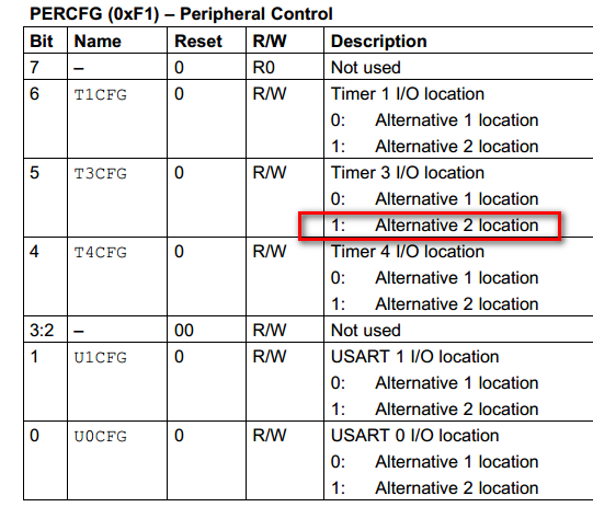

YiKai Chen said:Try my latest test code to output PWM on P1_6 using Timer 3.
PERCFG =0x20; // Select Timer 3 Alternative 0 location
P2SEL =0x20;
P1SEL |= BV(6); // Set P1_6 to peripheral
T3CTL &= ~0x10; // Stop timer 3 (if it was running)
T3CTL |= 0x04; // Clear timer 3
T3CTL &= ~0x08; // Disable Timer 3 overflow interrupts
T3CTL |= 0x03; // Timer 3 mode = 3 - Up/Down
T3CCTL0 &= ~0x40; // Disable channel 0 interrupts
T3CCTL0 |= 0x04; // Ch0 mode = compare
T3CCTL0 |= 0x10; // Ch0 output compare mode = toggle on compare
T3CTL &= ~0xE0; // Clear Prescaler divider value
T3CTL |= 0xA0; //Set Prescaler divider value = Tick frequency /32
T3CC0 = 128; //Set ticks = 128
// Start timer
T3CTL |= 0x10;
I tried your code and I could get 50% duty in P1_6. How could I change the duty? I tried to change the value of T3CC0 , but nothing happened.
