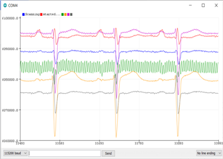

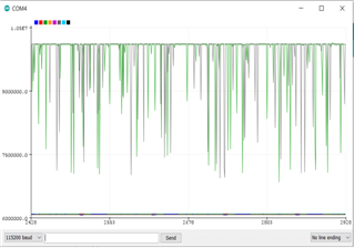

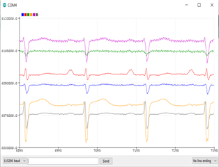

    I have tried some simulations and tests and I am attaching the output of the same here.
    I selected an ECG wave on the simulator and I am attaching the outputs that I have obtained with respect to the signal. I am able to plot the signals properly only when I suppress the output from channel 1 of 2nd and 3rd ADS IC.
    Plot1. (Output with all the signals plotted together)
    Plot 2 Output of all the leads except V1 and V2
    Plot 3 Output when v1 swapped with v2 and v4 swapped with v5 on the ECG simulator
    Legends :
    Blue - Lead1; Red - Lead 2; Green- V2; Yellow - V3; Pink- V5; Grey- V6
    Original Signal From ECG Simulator :  Leads from the beginning V1, V2, V3, V4, V5 and V6.
    Observation: Channels 2 is able to show a proper signal even when the flex-register values of Channel 1 and Channel2 are swapped. However, there is some added noise being observed in that test on channel 2 signals. When physically swapped on the simulator, Channel 2 shows a valid signal which is fed to the Channel1.

  • Dear Yang,
     Apologies. I was not able to add the plots earlier and I have added them for your perusal. Please let me know if you need anything else.
