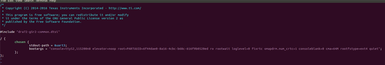

  • hi Keerthy,
        Thanks for your reply, I revisited your proposal
        1、I found the project linux configuration file dra72-g5r2.dts, the bootargs in it are as shown below, but I can't find a configuration like init=/sbin/init, should these be added to the configuration?

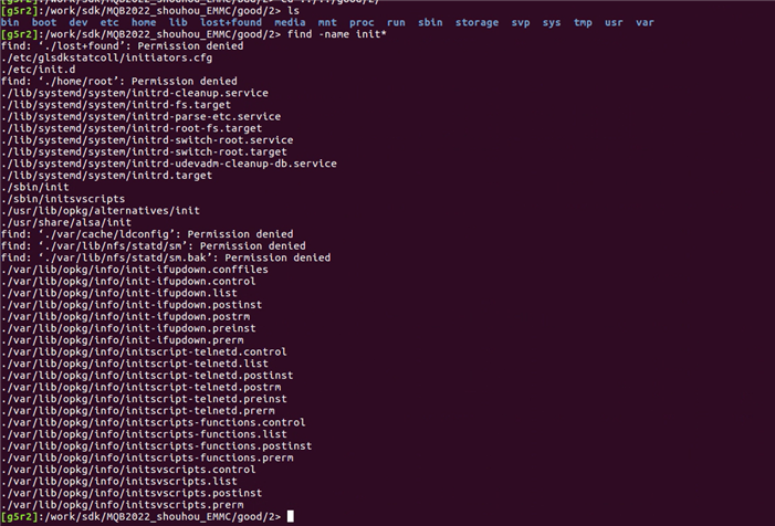

       2、Regarding the contents of the filesystem, I did an experiment. It is to prepare a good machine with the same software version to compare with the machine in question, I exported the mmcblk2 partition data through the dd command, and then mounted it on my ubuntu, I found that the init file also exists in the bad partition.
    The file system mount directory of the problematic machine:
    The file system mount directory of the normal machine:
    3、Because the problem machine is black during the user's driving, I judge that init turns out to be normal, and then I don't know what factors triggered it, which caused the kernel to panic. I don't have any other ideas for this part for the time being, but I would like to ask you for advice。I've tried to re-upgrade the machine to the same software and it will work back
    4、As long as a kernel panic occurs, it is the same no matter how many times you restart。It will not be able to return to normal unless I follow the method in step 3 and overwrite the EMMC partition with an SD upgrade card
    Yes if the init part is corrupt you won't be able to boot to kernel and hence you see the hang. So to double confirm redoing step 3 working for you right? If yes then you will need to check why eMMC or SD init is getting messed up. May be some health check but not sure on that eMMC part. So request to check with the eMMC vendor.
