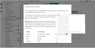

Hi TI,
Thanks very much!
I do not have the option to select another chip (CC1354xxx) available in my CCS. Can you suggest me how to enable it?
Thanks ver much.

    In general it happens to me with all other projects of the same sdk and previous sdks.
    CCS: 12.6.0
    Sysconfig: 1.16
    SDK: simplelink_cc13xx_cc26xx_sdk_7_10_02_23
    Example proyect: C:\ti\simplelink_cc13xx_cc26xx_sdk_7_10_02_23\examples\rtos\LP_EM_CC1354P10_1\zstack\znp
  • Thanks, I see the same with the zstack examples but not the generic ones. This is likely intentional by the SDK. I will bring this thread to their attention for further comment.
  • Hi albgarc,
    The SysConfig Device Switch feature is not fully utilized on Z-Stack projects given the depth of project-level changes that are also required to convert to a separate device.  Instead, you will need to import a new LP-EM-CC1354P10-6 Z-Stack znp example and migrate your stack configurations accordingly.  There should be minimal to no application code changes for the ZNP project.

  • Once you have a LP-EM-CC1354P10-6 znp example then you will be able to use the SysConfig Device Switch to select the CC2674P10RGZ, but not the CC1354P10RGZ.
    The reason this device is supported is because although only CC1354P10 LaunchPads are available, the CC2674X10 devices are preferred for Zigbee development.  Is there a specific reason you need the CC1354P for Sub-1 GHz purposes or are you willing to adopt the CC2674 variant instead?  Here also is the Migration Guide I forgot to mention previously.
