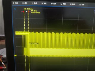

cam1 yuv422 1080p  30Hz/60Hz----->soc------->csitx--30/60hz---->max96717------>LVDS------>max9296------mipi---30/60Hz--->LCD Controller---->LVDS Display.
TDA4entry CSITX output display jitter
The frame rate signal of TDA4entry CSITX output oscilloscope has a jitter of about 30us.
Is this the cause of display jitter?
How to prevent frame rate signal jitter in SOC CSTTX output?
LCD Controller IC manufacturers believe that screen shake is caused by unstable frame signals.

  • Hi gg yang,
    Not sure which release you are using, but in SDK10.0, i see below change in kernels/video_io/host/vx_csitx_host.c file, in tivx_csitx_params_init API. Can you please see if you have these change?
    #elif defined(SOC_J722S)
    prms->instCfg[loopCnt].fifoDepth = 192U;
    #endif
    Brijesh
  • Hi.Brijesh
     TDA4entry SDK9.02.05. ADAS.
    #endif
    I have fixed it
     Now YUV422 1080p 30Hz CSITX can output correct content.
