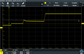

  • Hi Dylan,
    I think I´ve found the problem: Sometimes on power up I´ve got the attached voltage profile. My brown out level is the default one.So its around 1.5/1.6V.
    What I think what happens:
    1. System starts out of POR
    2. Voltage rises above brown out level 0
    3. eeprom emulation starts moving stuff from one section to the other
    4. in the middle of a write or erase flash operation the voltage falls below the brown out level 0
    5. data is corrupted
    The attached voltage profile does not happen all the time. Only when hot plugging.
    I think the solution is to set the brown out level to 3 ~2.9V. I`ve got a 3.3V power supply provided by the TIOL1123.
    In addition to that I will add a 10ms delay because the voltage ramp up will take about 8ms after getting out of POR.
    What do you think?
    Thanks!
    Best regards
    Steffen

  • Hi Steffen,
    The root cause assessment makes sense to me, if you get a reset during a flash operation then flash data can be corrupted. When the supply voltage is still ramping and is just above the BOR threshold, then a flash operation begins, the device draws extra current and can pull the voltage down a bit.
    Setting the BOR threshold higher should help to ensure that no flash operation is executed if the supply voltage is very close to the minimum operating voltage. Delaying a bit could also help to ensure that the voltage has ramped up before executing code.
    As for your question about what to do in the event of a BOR level 1-3: you are correct that a BOR3 will generate only an interrupt, not a reset. In the interrupt you will need to define the behaviors necessary for your system. Based on what we've discussed here, it sounds like you should check the status of the flash controller to ensure that there are no ongoing operations. By jumping to the interrupt handler you are also stopping the next flash command from being issued to the controller.
    When you are writing the interrupt handler you need to consider two possible cases:
    1) The power supply returns to safe operating levels. Here you likely just wanted to delay the next flash operation until the voltage has come back up. Clear the interrupt flag, wait a little longer if you see a need for it, and return from the handler. If the voltage dips back down again you should just jump back to the handler again.
    2) The power supply does not return to safe operating levels. Here you want to ensure that you don't request any new flash operations so that none are executing when the voltage supply passes the minimum threshold. Once the ongoing operation completes (if there was one) your flash should be ok to enter the power down state. Beyond that it is up to you how you want to gracefully power down.
