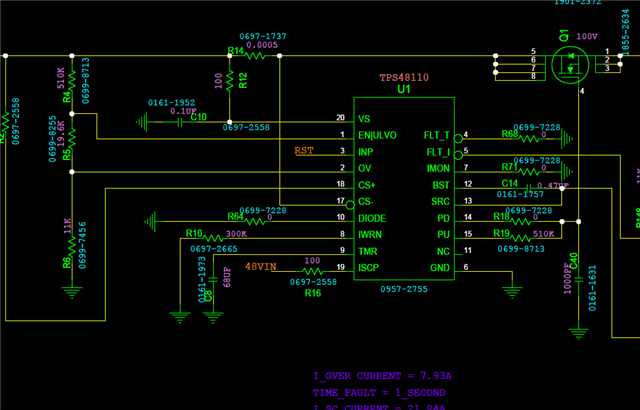

We are using the TPS48110 in our new board.
We used the design calculator from calculate the Riwrn Rsns Riscp values.
We chossed value of 3mohm for Rsns
We choosed value of 50 Kilo ohm for Riwrn to set the over current protection threshold at ~8A
We chossed vlaue of 4.7 Kilo ohm for Riscp to set the short circuit protection threshold at ~26
But actually the current is cutted off ( over current protection ) at ~6.8A
please advise which values of Riwrn, Riscp should i use for setting the over current at 8A and the short circuit protection at 26A
thanks

  • Hi Sarah
    in the mid time i attached the scheme here
    please review it
    thanks
  • Hi Meori,
    1. Add protection resistor to INP (4.7kohm)
    2. Consider adding placeholder for RTMR in parallel to CTMR
    3. If you have EMI concerns place ferrite beads in series with CS+/-
    Sarah

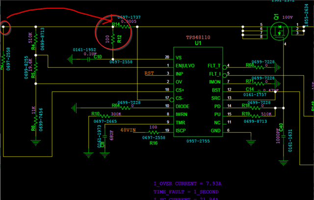

  • Hi Meori,
    I did speak with our Systems engineer about this today.
    Can you check your IMON accuracy? You will need to populate a resistor here. A typical explanation for IWRN inaccuracy could be sense pin/ shunt resistor placement. If you are also seeing inaccuracy in IMON then this is the likely culprit.
    Consider the importance of a Kelvin connection with the RSNS and the CS+/- pins. Ideally you will have CS+/- connected directly to the RSNS pads not along the VBAT trace.. I see from your schematic that you have CS+ routed to the far left of the shunt resistor, make sure this isnt how the layout is actually routed.
    Secondly make sure the CS+/- lines are length matched. Its important to consider any loses due to extra length on one compared to another since we are dealing with mV of delta.
    Sarah

  • Hi Sarah
     You need to make sure that your board traces are connected directly to the shunt pads
    > Did you mean that CS- should be connected directly to the shunt. CS+ can't be directly connected because it should be connected to Rset
    please approve
  • Hi Meori,
    Yes CS+ should be connected through the RSET resistor. This trace should be connected directly to the RSNS pad. The point here is that we do not want you to place the trace for the CS+/- pins just anywhere along the VBATT line. This is theoretically the same thing,, but could impact accuracy if not connected directly at shunt pads.
    Sarah
  • Hi Sarah
    I did not understand where should i place the traces for CS+/CS-
    please mark it, on the scheme below :
    thanks

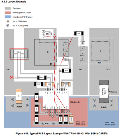

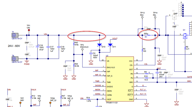

  • Hi Meori,
    Please reference the layout example section in our DS shown below. The key here is that the races from CS+/- are tied directly to RSNS pads (circled in red). You need to make sure that CS+ and RSET are not connected directly to Vin pour like shown with red X.
    You can also reference the TPS48111 EVM. The intention with the schematic is that Vs and EN connection are made before the RSNS connections and the sense pins are connected at the RSNS nodes.
    For your drawing I have shown the same fix, but this is just a schematic. The important thing is that your layout traces do what is shown in section 9.5.2.
    I hope this is helpful.
    Sarah

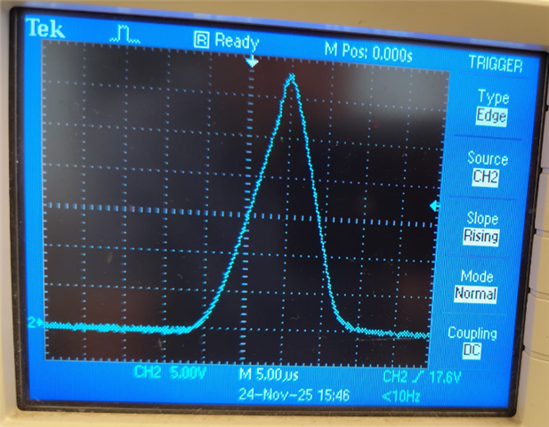

  • Hi Sarah
    Our load is a capacitive load  ( motor) with 160uF
    when the external FET ( IAUC40N08S5L140) is turn ON while it connected to this motor, there is inrush current of about 30A  (see below  each volt is 1A)
    the Isc  threshold is configured to 25A thus the TPS 48110 regulator is turn off the FET and the FLT I is going low
    there is resistor of 82k ohm is series to the gate ( as shown below )
    when i added capacitor of 1nf from gate to gnd there is no inrush current but when i perform full short circuit  ( out to gnd ) the FET is damaged
    what should i do ?
    please advise

  • Hi Meori,
    The capacitor from gate to ground is good and will slow down your FET turn on to dissipate the INRUSH current safely. We suggest a resistor in series with this to help dampen the discharge of that capacitor.
    Are you performing the Short to GND test when the FET is fully enhanced? Or are you enabling into Short?
    How are you physically applying the short?
    What is the damage you are seeing on the FETs?
    Sarah
  • Hi Sarah
    i am performing the short to GND when the FET is fully enhanced ( there is 48V at the output)
    physically i apply the short by a switch
    the FET is actually out of action ( i think its burned)
    thanks
  • Hi Meori,
    A few thoughts.
    1. Do you have any confirmation before the FET was damaged if the device recognized the event as SCP (based on CTMR vs FLT_I timing) and how long it took to respond? Just wanting to make sure that this wasn't an OCP event which you have your shut down time set to 1 second.
      1. The device should consider 35A an SCP and shut off < 10us. The should be more than fast enough to protect your FET.
    2. Additionally typically short to ground tests are performed with some resistance and small inductance on the line to mimic an actual wire. This is important as a short to GND without any line resistance would have infinite current increase.
    3. Its good you are able to confirm FLT_I. This indicates device was able to recognize and respond to current event. When you power device back on with damaged FET does FLT_I remain on? Can you verify if there is a short from G-S or D-S on your burnt FET first?
    Sarah
