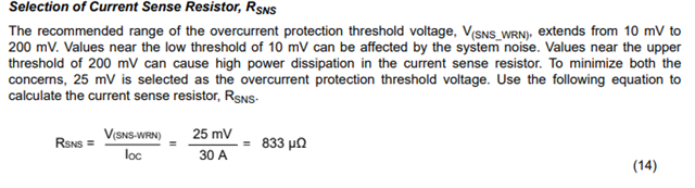

i want that this driver will protect over current at ~ 8A and for that i used 300K  as Riwrn

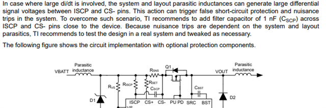

Also, i want that this driver will cut the current at ~ 22A ( short circuit protection) i used the above equation and get value of 100 ohm for Riscp ( i use 500u ohm resistor as Rsns)
but actually the driver cut the current ( short circuit protection)  at ~ 12A
when i used the excel sheet design calculator i got failure
please advise
  • Hi Meori,
    Can you send over a schematic for review?
    Firstly, I notice that your RSNS i snot ideal for the range of current you are testing. Both your Isc and Ioc put your V_WRN < 25mV. This could make your more susceptible to noise
    Secondly, typically when I see this you are experiencing a false trip due to noise. You can add a capacitor between ISCP and CS- to help eliminate this. As well as increase your RSNS value so the V_SNS_WRN is in a better range. If you already have this capacitor try increasing it to 10nF or 100nF.
