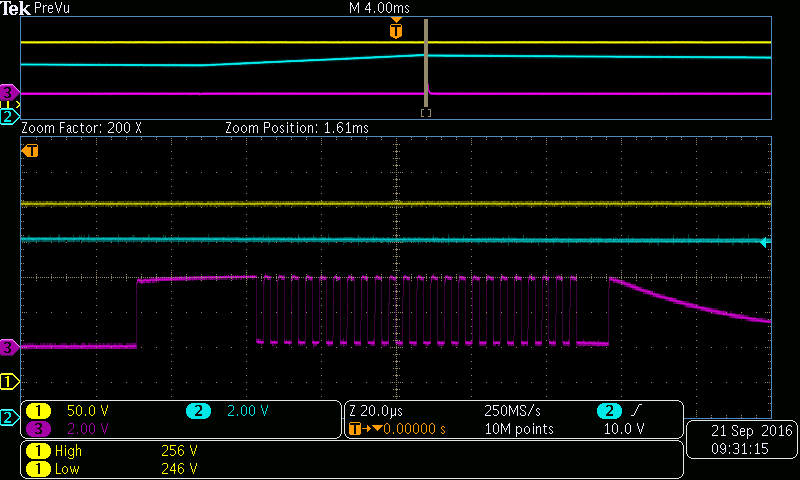

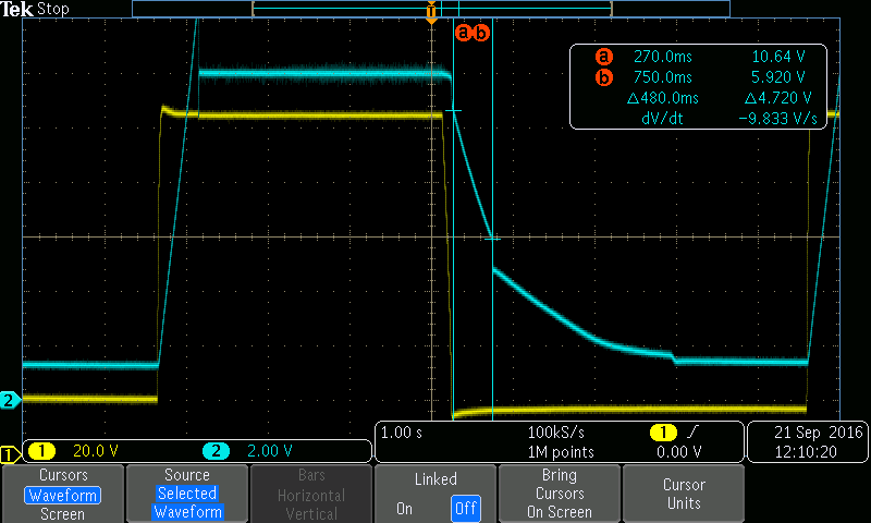

A problem concerning a flyback switcher using the UCC28631. If left alone for long enough, it will start up with no problem. If repowered, sometimes it will come up, sometimes it will not.
Monitoring Vdd on the switch side, it seems that if I repower the supply while the chip is in t_reset, it will cause the chip to low-power latch mode ("locked up" below). What is going on? What is causing the latch? How do I avoid it, or detect and clear it?
