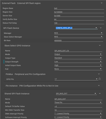

Hi folks,
One of the features I have had the most trouble porting from SDK 3.20 to SDK 5.10 has been OAD for both Simple Peripheral Offchip and MultiRole Offchip. Initially, I thought it was user error - but I have come to the conclusion that the SysConfig program is at fault.
Reference Material from the SDK
Overview
OAD works on both MultiRole and Simple Peripheral project on SDK 3.20. Since SysConfig was not used for this project, I have been migrating to it for SDK 5.10. OAD, while seemingly configured correctly for the BIM project and MR and SP projects, always reports: "OAD failed to open" on the latest SDK.
Diagnosis
I began by configuring the SDK 5.10 SysConfig such that the ti_drivers_config.c and ti_drivers_config.h matched the SDK 3.20 board files as closely as possible.

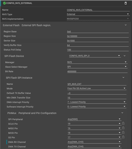

I tired many many things until I noticed a strange behavior - or rather the lack of behavior:
SDK 5.10 - GPIO Controlled CS SDK 5.10 - SPI Controlled CS
SDK 5.10 SysConfig Generated: ti_drivers_config.c SDK 5.10 SysConfig Generated: ti_drivers_config.c

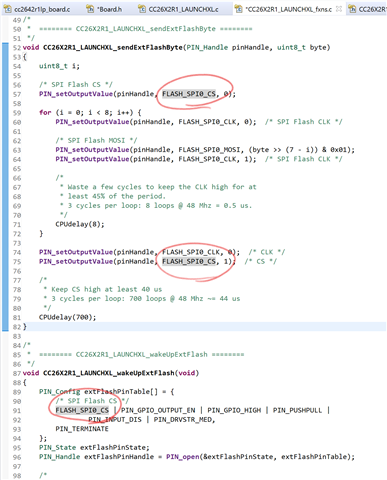

For reference, this is the modified board file for SDK 3.20:
And this depicts the flash specific functions:

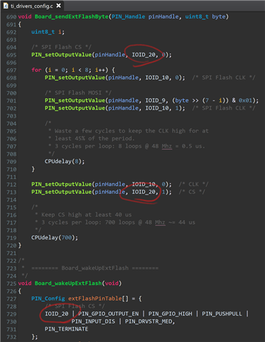

The solution for now is to constantly correct this IOID until this bug is fixed. I have been unable to make SysConfig generate a configuration with any other CS Pin IOID which is why I think there is a bug.
Let me know what you think - I have put three days into looking into this bug and only just noticed this behavior.
Ken
  • Hey Ken,
    You will find in source\ti\drivers\.meta\templates\BoardCC26XX.c.xdt that the Board_* APIs are hard-coded to use IOID_20, IOID_10, IOID_9, and IOID_10.  You can change these values, save the project, and clean/rebuild the project accordingly.  I will submit a ticket to address this issue as these functions should be dynamically changed based on SysConfig settings.
    Ryan
  • Hi Ryan!
    Ah! That makes me feel better. I haven't entirely frozen my SysConfig yet - so this has proven to be a bit of a nuisance to constantly correct between builds. I appreciate that you've forwarded this on - I hope this enhancement is made available soon.
    Ken

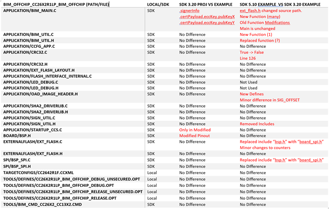

    I also checked the Board/bsp.h file from the BIM project:
    SDK3.20 SDK5.10
    // Board external flash defines
    #define BSP_SPI_MOSI            IOID_21
    #define BSP_SPI_MISO            IOID_19
    #define BSP_SPI_CLK_FLASH       IOID_20
    #define BSP_IOID_FLASH_CS       IOID_18

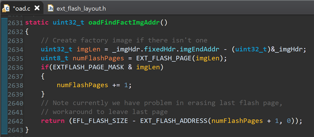

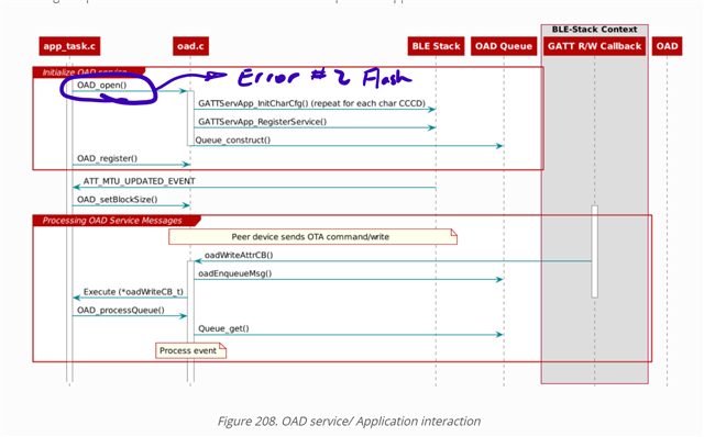

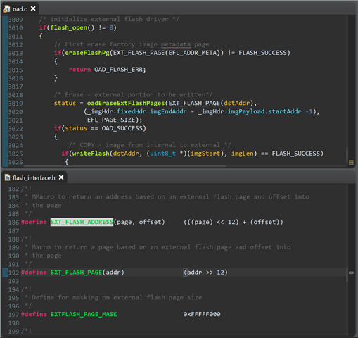

    I still cannot get OAD to open correctly. How can I diagnose this problem?
    Ken
  • Hey Ken,
    What information can you gather from the CCS debugger?  Have you ever monitored the SPI lines with an oscilloscope or logic analyzer?

    • BSP.h file in the BIM project (copied from the SDK to a project-local directory) and customized it for my PCB as described in post 1.
    • SysConfig should handle the SPI configuration for the Simple Peripheral Project via NVS/SPI also described in post 1.

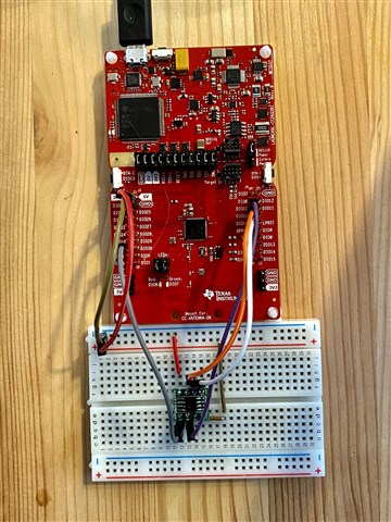

    Since my last post, I have received a SPI flash breakout PCB and mounted my SOP-8 flash package to it (chip worked in SDK3.20). When stepping through bim_main() and the external flash functions I see that the SPI CS and CLK pin states are changing. I connected my SDS 1202X-E oscilloscope to the breakout to sniff the communication.
    This depicts SCK (Channel 2, Purple) and CS (Channel 1, Yellow) during the startup.
    In greater time-scale resolution:
    Since my oscilloscope is limited to 2 Channels, I attempted to observe the MOSI (Channel 2, Purple) and MISO (Channel 1, Yellow) terminals:
    Once more in greater timescale:
    I am definitely not seeing the expected SPI output, so it is likely that the OAD error is indicating that something is incorrect. To further diagnose this issue, I referred to the oad.h source file for possible return messages for oad_open(...):

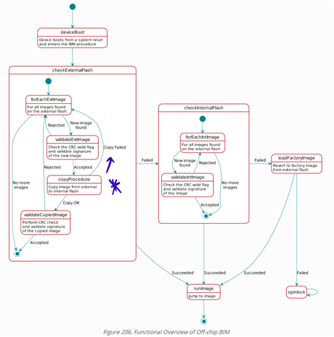

  • To make the previous post more clear, I retrieved some flowcharts and marked what I am investigating.
    BIM Startup Sequence
    The following flowchart from the BLE5-Stack User's Guide depicts how the BIM (No-RTOS) starts, identifies a valid boot image, then executes it. Because the BIM is only customized at the bsp.h file for PCB/Board specific flash needs, this operation marked in purple should successfully copy the flash image from External Flash to Internal Flash. I will check this later today.
    Application Startup
    The following graphic depicts the OAD operations in the Application image including startup and processing. Marked in purple is the operation that fails in the Application image during the startup procedure. The error appears to indicate that the External SPI flash is not working correctly. I have traced the assignment of the error status to the procedure described as: /* COPY - image from internal to external */ in the oadCreateFactoryImageBackup(...) function called during OAD_open().

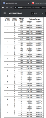

  • I am using an MX25R8035FM1L0 so the configuration should be identical except in IO assignment. Besides the bug noted in Post 1, there are no discrepancies I can find - though a 1:1 comparison is hard because SysConfig was not used in SDK 3.20.
    I enabled debug mode on the BIM project, concatenated it with my project image, and then watched the Launchpad LEDs. The BIM project is working in so far as it can indicate to me that no image was found in the external or internal flash. Bim_checkImages() is the second to last command in main and the debugger gets trapped in the while(1); and progresses no further.

    So, I returned to stepping through the OAD_open process:
    uint8_t oadCreateFactoryImageBackup(void)
        uint8_t rtn = OAD_SUCCESS;
        uint8_t status = 0;
        uint32_t dstAddr = oadFindFactImgAddr();
        uint32_t dstAddrStart = dstAddr;
        uint32_t imgStart = _imgHdr.imgPayload.startAddr;
        uint32_t imgLen = _imgHdr.fixedHdr.imgEndAddr - (uint32_t)&_imgHdr;
        /* initialize external flash driver */
        // SUCCESS! No problems.
        if(flash_open() != 0)
            // First erase factory image metadata page
            if(eraseFlashPg(EXT_FLASH_PAGE(EFL_ADDR_META)) != FLASH_SUCCESS)
                return OAD_FLASH_ERR;
            /* Erase - external portion to be written*/
            status = oadEraseExtFlashPages(EXT_FLASH_PAGE(dstAddr),
                    (_imgHdr.fixedHdr.imgEndAddr - _imgHdr.imgPayload.startAddr -1),
                     EFL_PAGE_SIZE);
            if(status == OAD_SUCCESS)
                // FAILURE Early Return resulting in OAD_FLASH_ERROR
              if(writeFlash(dstAddr, (uint8_t *)(imgStart), imgLen) == FLASH_SUCCESS)
                   // Excised code... to be reviewed later
                   /* WRITE METADATA */
                   // UNTESTED! Never seem to run this code...
                   //if(eraseFlashPg(EXT_FLASH_PAGE(EFL_ADDR_META)) == FLASH_SUCCESS)
                    if(writeFlash(EFL_ADDR_META, (uint8_t *)&imgHdr, OAD_IMG_HDR_LEN + 8) != FLASH_SUCCESS)
                       rtn = OAD_FLASH_ERR;
                } // end of if(writeFlash((dstAddr+4,  (uint8_t *)(imgStart +4), (imgLen -4)) == FLASH_SUCCESS)
                else
                // if(extFlashErase(dstAddr, imgLen))
           else // UNTESTED! Never seem to run this code...
           } //  end of if(extFlashErase(dstAddr, imgLen))
            /* close driver */
            flash_close();
         } // end of flash_Open
        return(rtn);
    TLDR:
    Called... Returned...
    eraseFlashPg FLASH_SUCCESS
    oadEraseExtFlashPages OAD_SUCCESS
    writeFlash FLASH_FAILURE
    Specific Method resulting in Error:
    if(writeFlash(dstAddr, (uint8_t *)(imgStart), imgLen) == FLASH_SUCCESS)){
        //Error Occurs
    writeFlash calls NVS_write which consistently returns -1 as per TI-RTOS Drivers NVS.h.
    This error corresponds with NVS_EFAIL which has no description in the TI-RTOS Drivers.
    Stepping through the code, the error is actually when source array and the read array are compared for bad which returns true indicating a failed comparison that ultimately returns NVS_STATUS_INV_WRITE (-7) by doWriteVerify in NVSSPI25X.c
        else if (flags & NVS_WRITE_PRE_VERIFY) {
            if ((hwAttrs->verifyBuf == NULL) || (hwAttrs->verifyBufSize == 0)) {

    Is there a well defined procedure for configuring SPI NVS Flash?
  • I looked at MOSI and MISO during normal boot with the Debug and Unsecured BIM with the concatenated application image. My serial decoder didn't seem to want to do anything to the data - but just looking at these waveforms tells me that the BIM is indeed configured correctly and that the Application appears to be reading from/writing to the SPI flash.
    While probing this, I realized that DIO_7 (Green LED) is Pin 12 and is assigned to UART. The fact that the LED is lit in my previous post is totally irrelevant.
    SPI MOSI (Ch2, Purple) SPI SCK (Ch1, Yellow)
    Overview of the Waveform at Boot with Points of Interest
    Point of Interest #1 Enlarged
    Point of Interest #2 Enlarged
    Point of Interest #3 Enlarged
    Point of Interest #4 Enlarged
    Point of Interest #5 Enlarged
    Point of Interest #6 Enlarged
    SPI MISO (Ch2, Purple) SPI SCK (Ch1, Yellow)
    The waveform is very dense. The MISO channel has continuous activity until reset.
    Based on the arguments of the method that calls the verification function, I suspect that these values are defined incorrectly.
    I believe these values are defined in oad_image_header_app.c. Here is the working SDK 3.20 and non-working SDK 5.10.
    There are no significant differences - additions were made to provide better support for clang and IAR.

  • Alright, so here is what I understood:
    • The targeted erase address (0x010000) was returning success, but memory was not erased.
    • The address was compared against the MEMORY ORGANIZATION table.
      • 0x010000 => Block 16
    • Targeted erase address (16) returns success and erases memory.
    For reference, this is the MEMORY ORGANIZATION Table for my Flash Chip (same series as the one used by the LaunchPad). My EFL_PAGE_SIZE is set to 4096 (0x1000) which indicates a 4KB sector.
    I have looked for methods calling eraseFlashPg that pass an address rather than a page index. Most methods provide an integer page, but there are two that do not and they both happen to be inside of the oadCreateFactoryImageBackup where my error is occurring.
    Line 3013 passes EFL_ADDR_META (0x0, Location of table of external flash image structures) to the Macro EXT_FLASH_PAGE which bitshifts 0 to the right by 12 to 0x0. Then this value is passed to eraseFlashPg which returns successfully but is allegedly not erasing. Line 3013 could be replaced by eraseFlashPg(0) since the block of the table should be fixed on the first page, but I have never observed it returning early at line 3013 or 3015.
    Line 3019 passes the value returned by oadFindFactImgAddr() for the location of the image in external flash. This function has a note, but that shouldn't affect our use case.
    These macros, methods, and functions are identical to those in SDK 3.20.
    But maybe I am overlooking something. I selected address values from the MEMORY ORGANIZATION table and compared the calculated page against the actual page using the macro (addr >> 12).
    • Address 0x0h (0 == 0)
    • Address 0x1000h (0 != 1)
    • Address 0x2000h (0 != 2)
    • Address 0x9f000h (2 !=159)
    • Address 0xF0000h (3 != 240)
    That doesn't look like it returns the correct page/sector at all - but if it works in SDK 3.20, it shouldn't matter for SDK 5.10.
    What do you think, ?

  • What do you think would be a reasonable value to set it to? It is currently the default value.
  • If it is the default value then perhaps my hypothesis is incorrect.  I know most examples use 0x256000 based on the external flash availability on-board LaunchPads.
    Ryan
  • As serious as this problem is, I should work on other problems and try to revisit it later.
    static const NVSSPI25X_HWAttrs nvsSPI25XHWAttrs[1] = {
        /* CONFIG_NVS_EXTERNAL */
            .regionBaseOffset = 0x0,
            .regionSize = 0x100000,
            .sectorSize = 0x1000,
            .verifyBuf = verifyBuf,
            .verifyBufSize = 64,
            /* NVS opens SPI */
            .spiHandle = NULL,
            /* SPI driver index */
            .spiIndex = CONFIG_SPI_0,
            .spiBitRate = 4000000,
            /* GPIO driver pin index */
            .spiCsnGpioIndex = CONFIG_GPIO_0,
            .statusPollDelayUs = 100
    Please keep me apprised of any other people who appear to be having similar problems.
  • Alright, so it's been about 10 days since my last post on the subject of non-functional OAD. I stepped back and started from scratch on the problem and performed the following comparisons:
    • SDK 3.20 Example cc26x2r1lp_bim_offchip VS SDK 3.20 Working Project
      • This isolates any changes made to make the BIM work as intended.
    • SDK 3.20 Example cc26x2r1lp_bim_offchip VS SDK 5.10 Example cc26x2r1lp_bim_offchip
      • This isolates changes made to the BIM example over the past few years.
    Comparison Results:
    Initial Observations:
    • Only (1) security signing information and (2) pinout were changed to adapt the SDK 3.20 BIM to the external flash.
    • bsp.h (which contains the pinout of the SPI flash) has been replaced with board_spi.h in (1) ext_flash.c and (2) bsp_spi.c
      • This seems like a potential problem - however, board_spi.h is not found in:
      • C:\ti\simplelink_cc13x2_26x2_sdk_5_10_00_48\source\ti\common\flash\no_rtos\extFlash
      • Which is really weird... maybe my SDK 5.10 is corrupted/missing files?
    • crc32.c changed a true to a false... not entirely sure why, but maybe no big deal.
    • Other differences didn't seem particularly important seeing as how bim_main.c/main()was unchanged
    Request:
    , can you shed me a little light on the changes to: ext_flash.c, bsp_spi.c, and crc32.c
    I will seek out a fresh copy of the board_spi.h files and maybe reinstall my SDK.
  • board_spi.h is deprecated and has been replaced with bsp.h, otherwise there are no differences to ext_flash.c or bsp_spi.c pertinent towards this investigation.  Can you please provide a code snippet of the crc32.c line you are describing?
    Ryan
