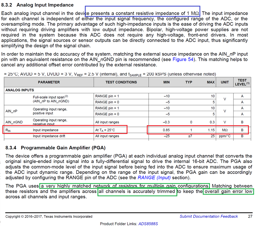

1. For the input impedance descriped in d/s, this is important as it could introduce system gain error. the spec. said input impedance has +/-15% vairsion around 1Mohms, but the PGA/input impedance section also said this input impedance is one stable and trimmed to match the system gain error. So my quesion is that Rin impedance is accurate or not? if NOT, I need compenste this error in my system design, correct? if the Rin is trimmed inside chip, how about the accuracy and its temperature drift?  btw, how about PGA's feedback resistor accuracy?

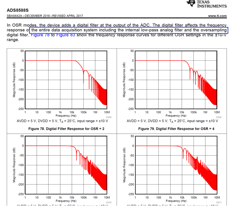

3. For OS operation mode, how to understand " The digital filter affects the frequency response of the entire data acquisition system including the internal low-pass analog filter and the oversampling digital filter."? as I understand, the LPF is independent on the oversampling digital filter, so how this digital filter would impact the frequency response of both LPF and digital filter from oversampling (averaging digital filger)?

    1. The input impedance, Rin, has been characterized and specified in the table as you showed above, the typical value is 1Mohm and the variation is between 0.85 to 1.15Mohm. Also, you can see the temp drift specification in the same table. The actual gain error depends on Rin and also your the resistance in your front-end circuity. If the error can not meet your requirement, you will have to do a calibration on system level.

    3. It's true that the internal LPF is independent from the digital filter. However, both filters should be considered for the whole signal chain when converting an analog signal. The combination of both filters determines the maximum input signal frequency. The analog LPF has a constant BW and frequency response once the input range is determined, however the digital filter has different frequency responses with different OSR values. When the OSR is small, the BW is dominated by the LPF. When the OSR is larger, the BW is dominated by the digital filter.

  • Thank Dale. For the 3rd issue, Figure78~Figure83 are the combine result from both LPF and OS filter?
    btw, do you have idea on how to calibrate the error from external resistor and internal resistor? how about the PGA feedback resistor accuracy, may i need take care of it as well?

    These are figures of frequency response for digital filter.

    You only need to care about the accuracy and drift of 1Mohm input impedance which have been specified in the data sheet, not other resistors.
    Dale
  • Got it. so we must have gain error calibration in our system to compensate the 1Mohms +/-15% error, correct?
    Thanks.
    Feng
  • Hi Feng,
    It's up to you and depends on your system's requirement.
    Dale
