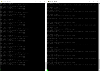

  • Hi Ryan,
    I was able to reproduce the issue with the spimaster and spislave examples.  I changed the spislave to send 0x11 0x22 0x33, etc and spimaster receives 0x00 0x11 0x22 0x33.  I need to update the problem statement.  I didn't realize we implemented a workaround in our spislave code where we add 1 bytes to the tx and rx buffers so the master clocks 1 less byte than needed.  The problem actually exists when the slave and master sides use the exact number of bytes for transaction.count.  I left the two examples at 30 bytes and saw the issue.
    One thing that is different between the examples and our code is that the examples use a 3 pin SPI where our code uses 4 pin.  I tried to configure the spislave example  for 4 pin but when I configured the SS pin in sysconfig, the spislave code could never detect MRDY going low.  If I go back to 3 pin, the code had no trouble with reading MRDY low.  It's very strange to me and maybe you have an idea there.  However, I don't want to sidetrack you for I'm trying to understand where the pre-appended 0x00 is coming from when the slave and master use the exact same count.  Yes, we can implement a workaround and we've been doing that but we'd like to understand why this is happening.
    Dawn

  • Attached are spimaster.c and spislave.c.  I made a few tweaks from the out-of-box code and added printf's so I could follow what was going on.  I was only able to get the example code to work for 3 pin but the problem showed itself.  We use 4 pin in our application and it shows there too.

  • Hi Ryan,
    This is great news but it's not working quite right for me.  I've implemented it as you suggested above and it works for the first transfer but then for the second transfer, there's 1 0x00 at the front of the master's rxBuffer.  Then each subsequent transfer another 0x00 is added to the front until the slave crashes all together.  It seems to crash when there are 6 or 7 0x00's at the front of the master's rxBuffer.
    Dawn

  • Hi Ryan,
    I've attached the spimaster.c and spislave.c source files I've been using.  Also attached is is output that demonstrates the extra 0x00's.
    Dawn

    // 3-2-2022
    // master output from suggested workaround where the slave does the following:
    // point the transaction txBuf to the second element
    // call SSIDataPut(SSI0_BASE, (uint32_t) slaveTxBuffer[0]) prior to SPI_transfer() with the first element
    // The workaround works for the first transfer but then subsequent transfers have an additional 0x00
    // added to the front of the slave's transmission.
    Set MRDY to low
    Wait for SRDY interrupt (falling edge)
    Set MRDY to high
    masterRxBuffer: 0x11 0x22 0x33 0x44 0x55 0x66 0x77 0x88 0x99 0x00
    Set MRDY to low
    Set MRDY to high
    masterRxBuffer: 0x00 0x11 0x22 0x33 0x44 0x55 0x66 0x77 0x88 0x99
    Set MRDY to low
    Set MRDY to high
    masterRxBuffer: 0x00 0x00 0x11 0x22 0x33 0x44 0x55 0x66 0x77 0x88
    Set MRDY to low
    Set MRDY to high
    masterRxBuffer: 0x00 0x00 0x00 0x11 0x22 0x33 0x44 0x55 0x66 0x77
    Set MRDY to low
    Set MRDY to high
    masterRxBuffer: 0x00 0x00 0x00 0x00 0x11 0x22 0x33 0x44 0x55 0x66
    Set MRDY to low
    Set MRDY to high
    masterRxBuffer: 0x00 0x00 0x00 0x00 0x00 0x11 0x22 0x33 0x44 0x55
    Set MRDY to low
    Set MRDY to high
    masterRxBuffer: 0x00 0x00 0x00 0x00 0x00 0x00 0x11 0x22 0x33 0x44
    Set MRDY to low
    Set MRDY to high
    masterRxBuffer: 0x00 0x00 0x00 0x00 0x00 0x00 0x00 0x11 0x22 0x33

    I observed the following output:
    Starting the SPI master example
    This example requires external wires to be connected to the header pins. Please see the Board.html for details.
    Set MRDY to high
    Wait for SRDY to be high
    Master SPI initialized
    Set MRDY to high
    Set MRDY to low
    Set MRDY to high
    Set MRDY to low
    Set MRDY to high
    Set MRDY to low
    Set MRDY to high
    Set MRDY to low
    Set MRDY to high
    Set MRDY to low
    Set MRDY to high
    Set MRDY to low
    Set MRDY to high
    Set MRDY to low
    Set MRDY to high
    Set MRDY to low
    Set MRDY to high
    Set MRDY to low

  • Here are the connections I see from your picture:
    Master SLAVE
    DIO15 MASTER_RDY DIO25
    DIO21 SLAVE_RDY DIO29
    DIO10 SCLK DIO23

  • Thanks for clarifying.  I wanted to make sure there was a common GND connection as it was not shown in your image.  My setup is identical:
    But once more my output is different:
    I can't explain the reason between the difference since we are using the same v5.30 SIMPLELINK-CC13XX-CC26XX-SDK
    Ryan
  • Hi Ryan, you had asked me to upgrade my SDK to v5.40 so I'm using simplelink_cc13xx_cc26xx_sdk_5_40_00_40.
    Dawn
  • I meant 5.40, apologies for the confusion.
    Ryan
  • Hi Ryan, I compared the last code you posted in the forum with what I'm using and I noticed your posting has:
    #define SPI_MSG_LENGTH  (9)
    Can you change this back to (30) and see what happens.  The issue happens when the slave and master have the exact same message length.
    Dawn
  • One more thing, Ryan.  I changed the #define to 9 and I get the results you do.  That is why the slave's receive messages are garbled.  You should see what I'm seeing when you change it to 30.
    Dawn
  • That was indeed the difference in setup.  I apologize for the confusion as I appeared to have at some point lost my direction while debugging.  I've now got the issue appearing on my end and will further look into the cause.
    Ryan
  • Hi Ryan, I'm glad you're seeing what I'm seeing now.  Do you have an update on this issue?
    Dawn

    Please let me know if this workaround is suitable for your application.
    Ryan
  • Hi Ryan,
    This workaround works for us too!  Thanks for sticking with me and getting this resolved.
    Dawn
