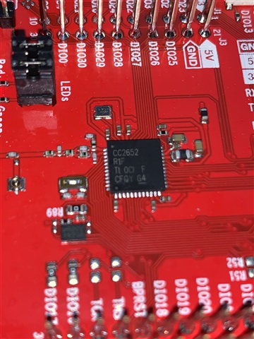

When i use CCS or UNIFLASH i get the message:
Device revision '0x4' unknown for selected target. Assuming latest known revision: Rev. 2.1.
Uniflash does work and also CCS works. But when i try to debug project zero (project_zero_CC26X2R1_LAUNCHXL_tirtos7_ticlang)
the CCS application crashed/disappears during downloading.
The text on the chip is:
CC2652
R1F
TI OCI F
CFQY G4.
Any assistance is appreciated.
Michel

  • Thanks for waiting, Michel.  It has been determined that this is a bug in the flash properties file. Revision 0x4 is read from the ICEPick module and compared with the values defined in the C:\ti\ccs1200\ccs\ccs_base\DebugServer\propertyDB\CC26x2_FlashProperties.xml file. A snippet can be seen below.
        <property id="DeviceInfoRevisionTranslation">
            <target>generic</target>
            <name>Revision Translation</name>
            <valueType>String</valueType>
            <defaultValue>0:1.0:A:1:1.01:B:2:1.1:C:3:2.1:E</defaultValue>
            <readOnly>1</readOnly>
            <hidden />
        </property>
    The <defaultValue> tag must be updated with information  about revision 0x4. This is only used to display information about the chip and does not make any difference for the debug session. The following should be added to the defaultValue string: “4:3.0:F”. That means it is PG3.0 and it should be shown as revision F.
    Ryan
  • Hi Ryan,
    I've changed the defaultvalue as suggested with an additional  ':'. Now the problem is solved.
    Thanks for the quick responses.
