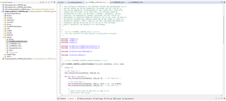

    For these sentences, What kind of power issues can it be ? I thought something in the POWER_SAVING definiton prevent to flash the code. Because after disabling the POWER_SAVING, I could flash the code to my custom board. It can also arised from the board files. Because board files for my custom board are not exactly same with Launchpad. The board files that I used like in the screenshot. As you can see, CC2640R2DK_CXS.h and CC2640R2DK_CXS.c are for my custom board but CC2640R2_LAUNCHXL_fxns.c is for the Launchpad and there are flash related codes in the CC2640R2_LAUNCHXL_fxns.c file.

    Issues with power, I mean with power circuitry.
    It is early for me to say that CXS board files would cause issues. I don't have experience with 2.7mm CC2640R2F. But, I only use the launchpad board files as base reference for custom boards because it works with latest SDK.
    I suspect you have an issue with your custom board circuitry. I suggest you work with the hardware designer to resolve your issue
