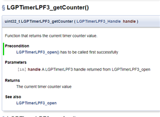

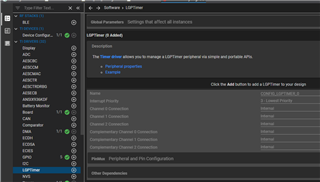

  • Shashirekha,
    Here is another useful thread that discusses a similar function )(although not exact): https://e2e.ti.com/f/1/t/1234806/
    Also reference the RTC in CPU_MMAP (RTC) for register descriptions.
    In Syscfg there is "LGPTIMER", click "examples" for some example code snippets which could be useful (I recommend going this route).
    You may also find some useful information in the hw_rtc.h file present in the SDK that may be helpful.
