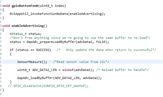

  • Hello Jan,
    I have called the function BLEAppUtil_invokeFunctionData() in callback function of GPIO interrupt.
    And written function enableAdvertising() in app_broadcaster.c.
    Now, the broadcasting is happening periodically, but the GPIO wakeup is not occuring.
    Am I missing something here?
    Rushikesh.

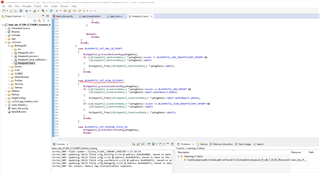

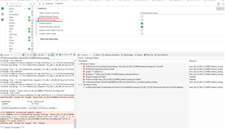

    I have tried to below option of disabling timers by doing below setting but its generating build errors.
    Rushikesh.

  • Hello Jan,
    Thank you for your solution and quick response!
    I have tried a different method to disable the event here. I'm commenting the part which adds the advertising event into the queue. Please let me know it its correct or not.
    Because, its working well. I'm getting interrupt as well as the broadcasting through the interval timer has stopped.
    I'm getting low standby current and average current as well.
    Will try above solution as well.
    And please provide your feedback as well on above.
    Thanks and regards,
    Rushikesh.
  • Hi Rushikesh,
    I am glad to hear the method you have implemented seems to work well! Based on your code snippet, I would suggest removing the dynamic memory allocation entirely. You are currently allocating memory, but not freeing it which will cause issues further down the line. Besides that, my only concern would be that you are having an empty advertising callback. If you don't have any plans to use any of the advertising callback features, then this should be okay to leave as is, but if you do plan to use the callback down the line then I would suggest trying to see if the solution i provided earlier works as expected.
