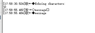

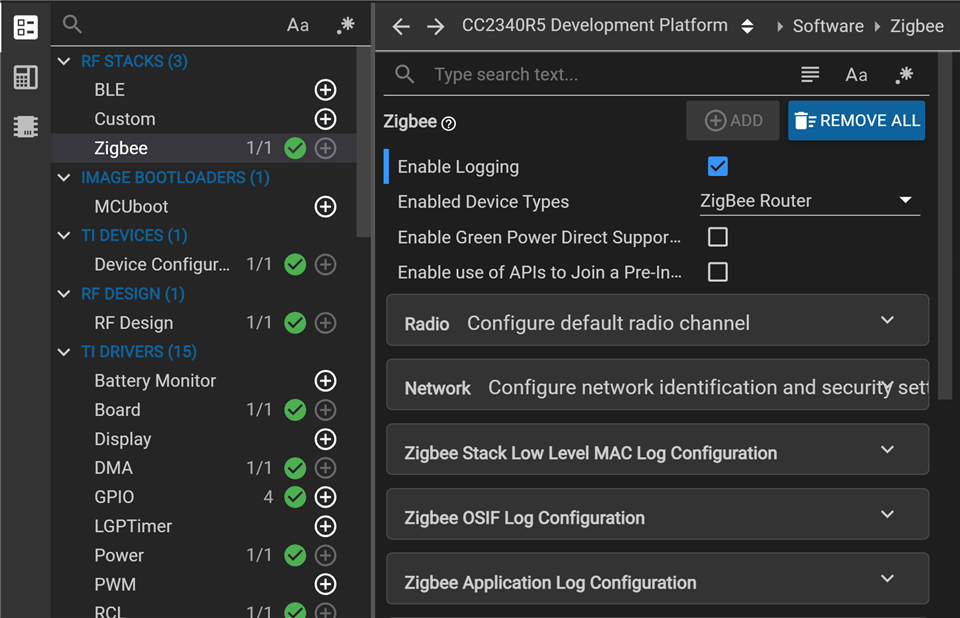

The running example is a door lock.
After adding the initialization of logs to my initialization process, it just keeps getting stuck in the serial port input and output process. However, the underlying logic for the other Zigbee devices is not functioning.
The desired effect is that when there is input on the serial port, the characters should be received and corresponding logical processing should be carried out. And it is also output via the serial port. Then the logic of Zigbee is not affected either.
How should it be modified?

  • Hi Yongjian,
    First, you can enable logging in the SysConfig file, along with any additional options from the "Log Configuration" drop-down windows.
    Then follow this Logging SimpleLink Academy Lab (instructions are for the F2 SDK but should mostly apply for F3 as well) along with the TI Log Tool User's Guide.  This is uni-directional (i.e. CC2340R5 TX only).
    If bi-directional is necessary (i.e. CC2340R5 RX/TX) then your current implementation is at fault for calling a logThread function which never leaves (i.e. while 1 forever) and thus does not allow the Zigbee application to operate.
    I will speak with R&D about what can be done to resolve this.
    Ryan
  • Using Using www.ti.com/.../4.0.3.LTS here is a reference for the on_off_switch that enabled a UART2 callback echo using a CONFIG_UART2_ZB module added to SysConfig using the backchannel XDS110 UART channel.

    void schedule_uart_callback (zb_uint8_t count) {
        zb_buf_get_out_delayed_ext(uart_callback, count, 0);
     *  ======== callbackFxn ========
    void callbackFxn(UART2_Handle handle, void *buffer, size_t count, void *userArg, int_fast16_t status)
      ZB_SCHEDULE_APP_CALLBACK(schedule_uart_callback, count);

        /* Create a UART in CALLBACK read mode */
      UART2_Params_init(&uartParams);
      uartParams.readMode     = UART2_Mode_CALLBACK;
      uartParams.readCallback = callbackFxn;
      uartParams.baudRate     = 115200;
      uart = UART2_open(CONFIG_UART2_ZB, &uartParams);
      if (uart == NULL)
          /* UART2_open() failed */
          while (1) {}
      /* Pass NULL for bytesWritten since it's not used in this example */
      UART2_write(uart, echoPrompt, sizeof(echoPrompt), NULL);
      numBytesRead = 0;
      /* Pass NULL for bytesRead since it's not used in this example */
      status = UART2_read(uart, &input, 1, NULL);
