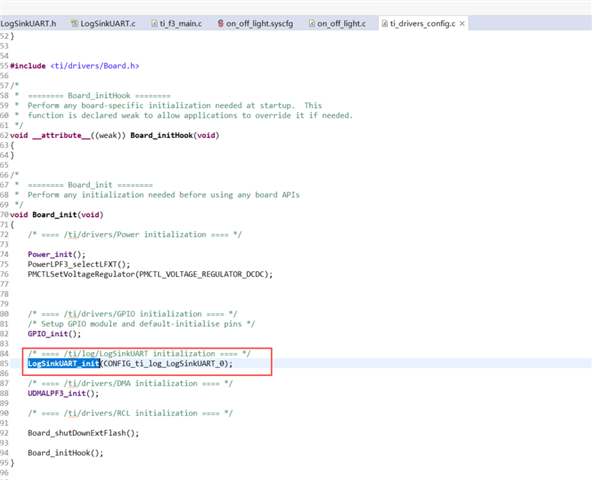

Based on the onoff_light_LP_EM_CC2340R5_freertos_ticlang example  of the simplelink_lowpower_f3_sdk_9_12_00_19 SDK ,Configure the UART2 port in the SYScfg and After initializing the UART2 port, it was found that the SDK could not start normally.
const char echoPrompt[] = "Echoing characters:\r\n";
UART2_Handle uart;
UART2_Params uartParams;
uint32_t status = UART2_STATUS_SUCCESS;
size_t bytesWritten = 0;
/* Create a UART where the default read and write mode is BLOCKING */
UART2_Params_init(&uartParams);
uartParams.baudRate = 115200;
uart = UART2_open(CONFIG_UART2_0, &uartParams);
UART2_write(uart, echoPrompt, sizeof(echoPrompt), &bytesWritten);
After calling the UART2_open interface, the system stops running.
  • Hi baosong,
    That could be the expected result.  For only TX output you must either enable Logging through UART exclusively through SysConfig, and use the example APIs demonstrated to add your own Zigbee application messages.  If you need RX input as well then there are additional steps necessary as demonstrated in this relevant E2E post.
    This assumes that UART2 is being initialized and configured in the correct locations, so if you continue to struggle then you will need to provide your SysConfig and on_off_light.c files.
    Ryan

  • Hi Ryan Brown1,Adding the Zigbee logging still doesn't allow the system to start normally.
  • Further discovery ,I imported a new onoff_light example and enable logging then Select UART Port Log,Zigbee protocol stack failed to start.
    I guess that it was the UART2_open function that caused the startup failure,If the serial port initialization is removed, the system can start normally.
  • I apologize if it had not been made clear previously that no application code changes are necessary when enabling logging for a Z-Stack project, as SysConfig is used to determine the correct usage and all initialization is handled in the background.  Thus you should not be calling UART2_open independently when using the logging feature.
    Ryan
  • On version 8_40_02_01 ,I can use the UART2 port normally,but in the 9_12_00_19 version I cannot use the UART2 port for the same method.
     In order to further verify the issue,int the 9_12_00_19 version, I imported a new onoff_light example and enable logging then Select UART Port Log, No additional application code was added(There is no code for UART2 port initialization added in the "on_off_light" file), then the example cannot run successfully.
    I want to upgrade our product to the latest version (9_12_00_19), but after the UART2 port initialization in the new version, the system crashed.   I sincerely hope to receive your assistance.
  • I am currently on business travel and will not be able to confirm UART logging on the v9.12 F3 SDK until later this week.
    Thank you for your patience,
    Ryan
  • OK, I'm will wait for your reply. I want to implement the serial port send and receive on the V9.12 version.The problem I'm currently facing is that once the UART2 port is initialized, the system will stop running.
  • I've replicated the issue, please remove the LTO Arm Compiler Optimization option for your project.
    Another workaround I'm aware of is using ARM-CGT-CLANG 4.0.3.LTS or greater in your "General" settings.
    Ryan
  • Thank you very much,UART has been successfully run on version V9.12.
