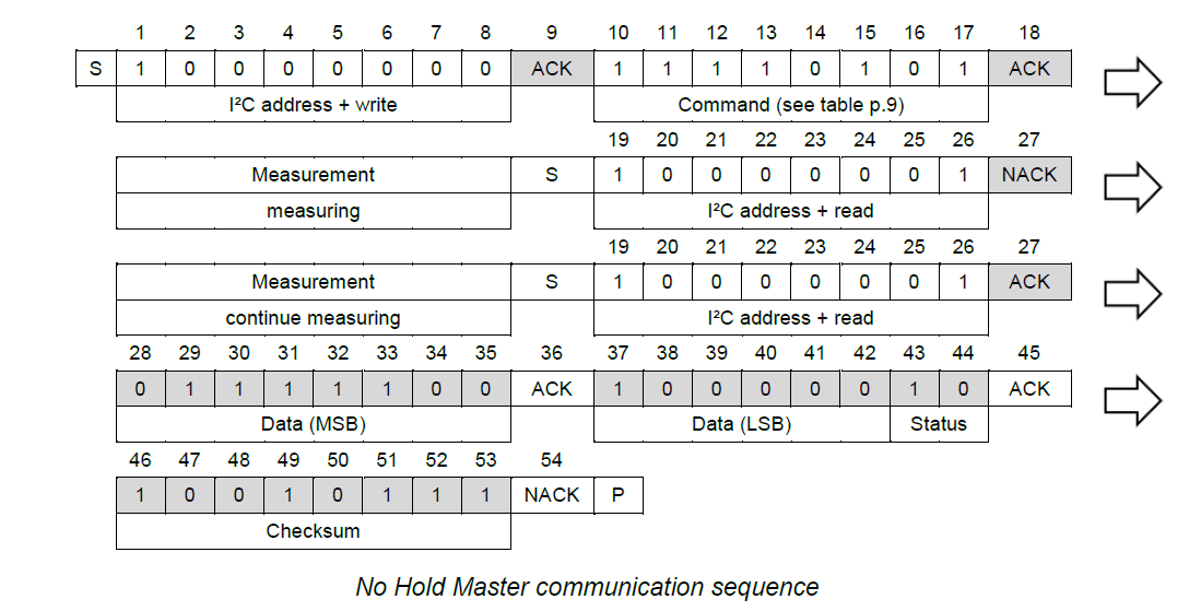

I am using MSP430F5255 in Master mode and talking to a slave device in HTU21D over I2c.
The recommended format for starting a conversion and reading the results is as per the attached file.
MSP just hangs after it receives the first NAK from the slave. I have tried a combination of steps to try and read the NAK_INTERRUPT(that would not help as I understand reading from some previous posts.)
So wanted to know what would be the best approach  to send multiple read requests after receiving the first NAK ?
Chinmay

  • This diagram is a bit ambiguous. Most likely it tells you this:
    You start a transfer, address the slave (which the USCI does automatically when setting UCTXSTT, so you don’t send the address yourself), then a command.
    The slave begins measurement. Now you make a repeated start. Which the slave won’t acknowledge because it has no result yet. The slave behaves as if it wouldn’t be there. Your code has to detect this and simply retries. As soon as the slave has a result for you, it will ACK the read request and you can fetch the data.
    So depending on the time the slave is busy, the second line may happen multiple times or never.
    But since sending the command was successful, you know that the slave is there and just busy. If the write attempt (the first line) had resulted in a NACK (which you need to check too!), the slave really isn’t there. Or you use the wrong slave address :)
    This ‘no hold master’ mode is for not blocking the bus while being busy. In ‘hold master’ mode, the slave would hold the clock line low at the end of the second line, releasing it and sending an ACK (skipping ht e3rd line) when ready. Which would block the bus, but is easier to handle if it is the only slave, and also would be faster (no need to wait for another start)

  • Yes, the hold master mode, while providing faster reaction time, blocks the bus. If there are multiple slaves, this is no solution.
    Some devices offer an ‘interrupt’ signal to tell the master that the operation is complete and the slave is available for delivering the result. If this is available and can be used (a matter of available additional I/O lines), this would be preferred over polling like this. However, it still requires starting a transfer from scratch rather than have the transfer started and stalled until data available. So 'hold master' is still fastest.
    If you set UCTXSTT and the slave doesn’t answer, then when UCTXSTT clears, UCNACKIFG is set (and if UCNACKIE is set too, the ISR is called).
    This way you know that the slave didn’t respond and is apparently not ready yet.
  • Hi Jens,
    Many thanks for your comments. I was able to resolve the issue with some debugging and some code samples with a local TI Engineer.
    I had the following problems in the code.
    1. I should have waited , with a delay or checking the busy flag when transmitting the slave address, i.e. when I change mode from transmit to receive.
    2. The way I was reading the NACK flag was not correct (calling the API USCI_get_interrupt status), .You have to send the start condition and then poll on UCNACKIFG. Maybe this could be made a part of the standard API, that are present.
    C Nanda
