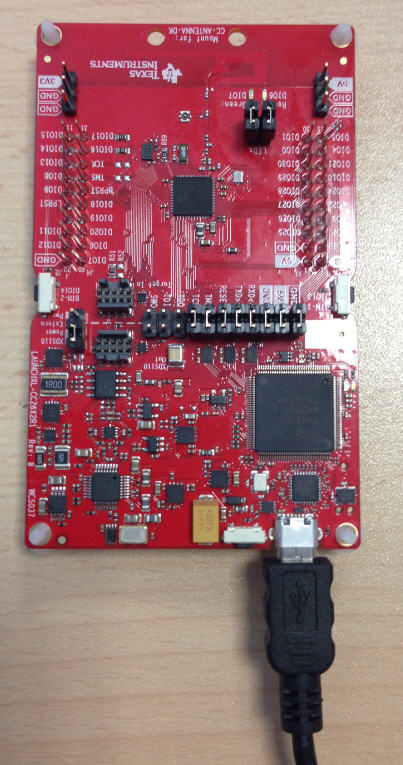

    and from what I can see this demo board seems to me the evolution of the other one in order to support the latest ZigBee specification and then I hope also the old ones. I'm correct?
    Question #1
    Now the question is if tthis device and the stack proposed can be used to make a controller for Home Automation application like in the CC2530/CC2531.
    Question #2
    Another is about available example that can be used to speed the developing so briefly if there are design examples like the TI2530ZNP but already ported for the CC2652R or if we have to perform the porting from this two microcontroller.
    Some help?

  • Fabio,
    The SENSOR-TO-CLOUD solution contains LAUNCHXL-CC26X2R1 ZNP firmware images and Zigbee 3.0 networks can allow HA devices to join its network, this is once again the recommended path.  No migration should be required.
    Ryan

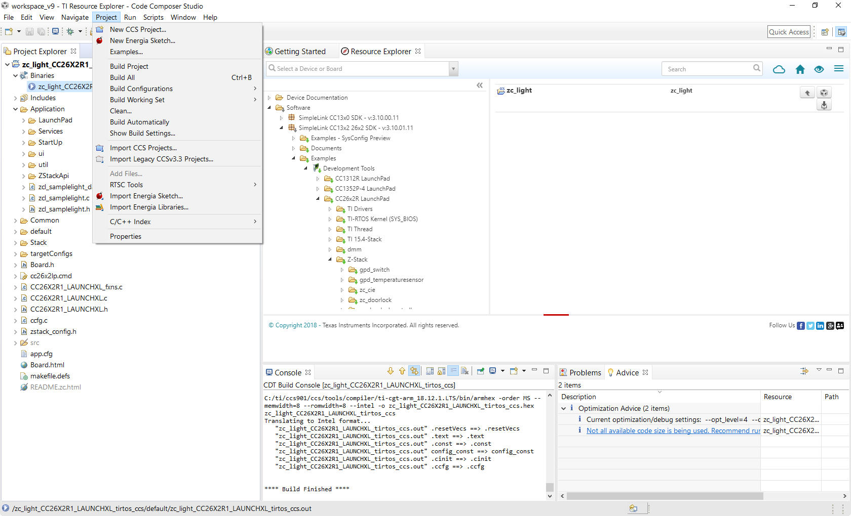

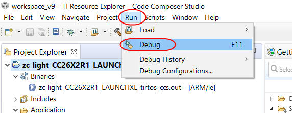

    finally I've got the LAUNCHPAD, now I'm try to follow the first ZigBee demo zc_light.
    By looking at the manual I can read:
    Build and Download Project -> Build the zc_light project.
        - Set the zc_light project as the active project. Make sure the Debug project configuration is used.
        - Select Project → Rebuild to build the project.
    the doubt is how set the correct configuration, seems that I've to set the debug configuration but I've found this option only at the path Project->Properties->General and then select the panel Products, on the bottom of the page there is a Build-profile text box and I can choose from release and debug so I think to have to set the debug option. I'm right?
    Also there is no menù Make under the Project menu entry so I think to use Build All and at  least I', unable to find the Download option as per manual...
  • You don’t have to change anything in zc_light project property. Just build and download it to your LaunchPad and it should work.

    but how to download, there is no button or menu entry for download....
    [EDIT]
    Ok ,my be I've found the way, on the manual I can see:
        Set to erase all Flash memory
                Navigate to Project → Properties → Debug → Flash Settings and select All Unprotected Sectors under Erase Settings during Program Load
                This will ensure the NV memory from previous project builds is reset.
        Load the zc_light project onto the device
                Select Run → Debug to download the zc_light application.
                Once the debugging session starts, click the red stop button
    Then to perform the flashing of the board I've to go into the Run->Debug or use the F11 key, right?
    Also the manual say that we have to change some flashing option, is necessary or I've to leave it untouched?
    Thank!
  • Yes, you can  go into the Run->Debug or use the F11 key to download it into your LaunchPad. You can leave Flash option untouched.

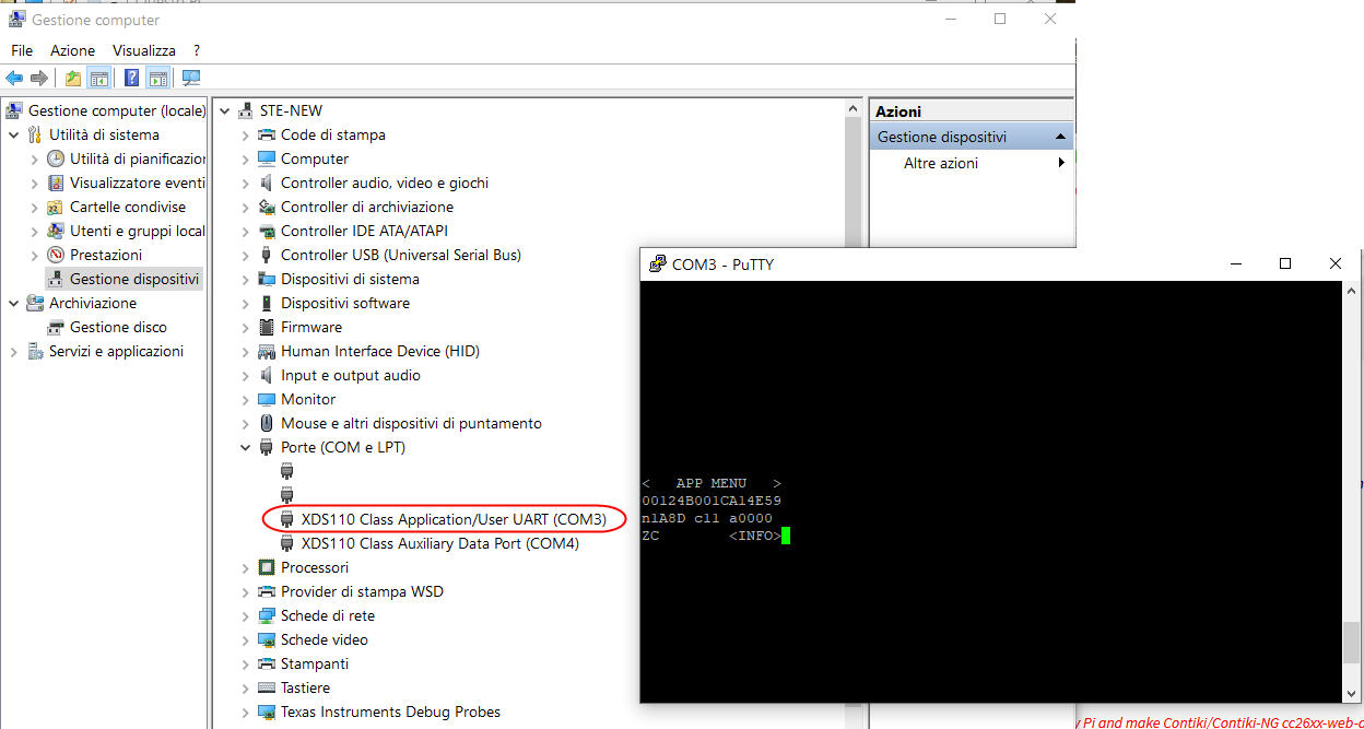

    Well actually I was able to run the application and see the user interface through PuTTY.

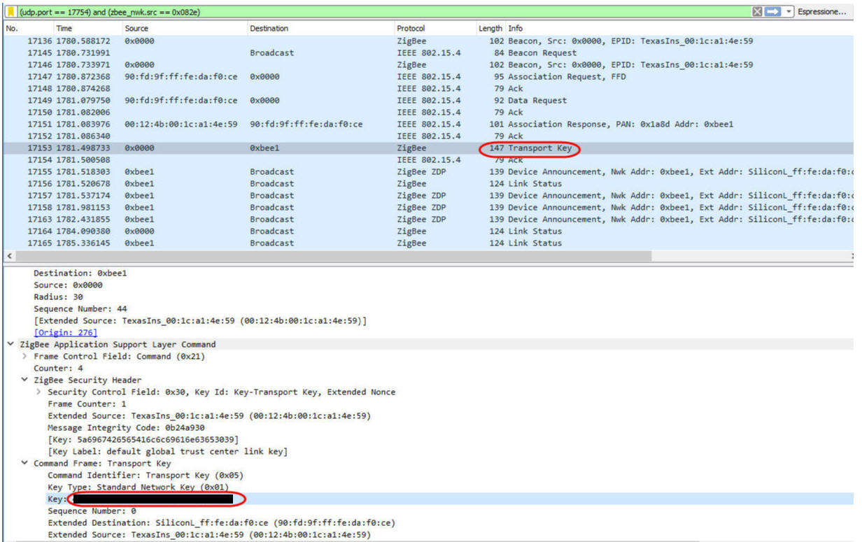

    Actually to perform the sniffing I'm using a NORTEK HUSBZ-1 key (Z-Wave and ZigBee, configured to acquire the ZigBee packet) and Wireshark.
    To drive data into Wireshark I'm using the ZigBeeSniffer.jar tool (from com.zsmartsystems.zigbee.sniffer), my first attempt was to work under Linux environment with the open source Bellows library, (to drive the radio inside the key) based on the open zigpy ZigBee framework (to manage the ZigBee stack). Of course I've already added to Wireshark ZigBee packet dissector the ZigBee Default Global Trust Center Link Key (AES-128, 32 bit, key, 5A:69:67:...)

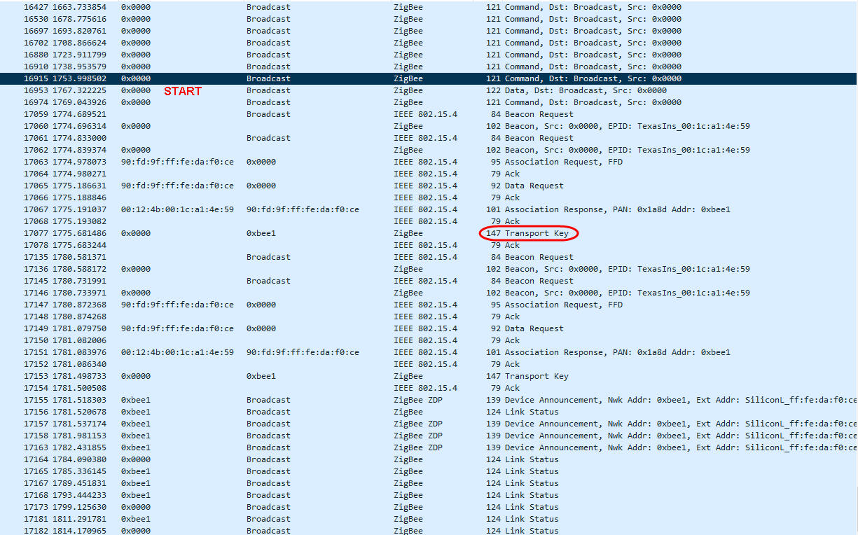

    By means of this setup I was able to make the network and joining the lamp bulb and also send command to perform various action depeding the supported cluters on the specific ZED. Now the goal is implement my solution with the CC2652R chip.
    The first step then will be start the commissioning procedure (paring) to add a simple light bulb on the network.
    To perform the pairing the procedure, with the lamp bulb in my hand, I've to start the commissioning and the power up the bulb (to be sure about the bulb I've resetted it, in this case I've to power on-off it 6 times).
    After having reset the light bulb the LAUNCHXL-CC26X2R1 board, programmed with the zc-light example application through CCS, was powered.
    In Wireshark I can see, every 15 ", the Broadcast command issued from the board:
    Next step is switch the btn1 board button to start the commissioning process and after some second switch on the light bulb.
    after that I've added the Trasport Key to Wireshark in order to decipher subsequent communications between the ZC and the ZED.
    the 90:fd:9f:ff:fe:da:f0:ce is effectively my light bulb so I think it was discovered and the example have also distributed the global key to encrypt the future communications between theLAUNCHXL-CC26X2R1 board (that act as ZC - ZigBee Coordinator) and the ligh-bulb (that act as ZED - ZigBee End Device).
    The coordinator set the address of the ligh-bulb equal to 0xBEE1, so for every communication, instead the generic address 90:fd:9f:ff:fe:da:f0:ce we have the network address 0XBEE1.

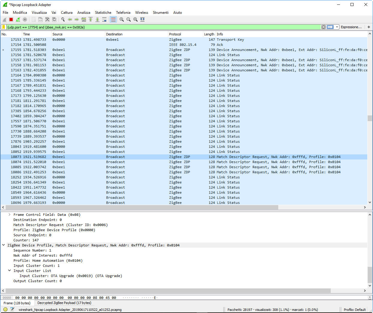

    After the pairing process the search for endpoints and clusters for each endpoint supported by the device should be followed, here below the last significat log rows captured inside wireshark.
    So I think that the discovering process is not carried and I've to make necessary change to support the clusters type of the light bulb I'm right?
    Thank for your time!
    Best regards.

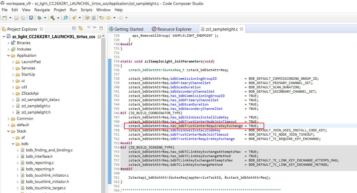

  • Try to set bdbTrustCenterRequireKeyExchange to false on ZC to test again.
    there is a way to perform a search of this key in a fast way inside CCS? I found difficult in finding references inside the design, the search function seems able to work only inside a file, not on the whole design...
    After some search using Notepad++ inside the folder at the CCS default workspace I think to have found the flag inside the file zcl_samplelight.c, function static void zclSampleLight_initParameters(void).
    Is it the right place?
    Anyway recompilation with this flag set to FALSE give me same result, the communication stop after the Match Descriptor Request...

  • BDB_DEFAULT_TC_REQUIRE_KEY_EXCHANGE should be set to FALSE by default in the SIMPLELINK-CC13X2-26X2-SDK v3.10, and from the screenshots it appears that the ZC does not time out of the TCLK exchange process and ask the ZED to leave the network.  ZDO_COORDINATOR and RTR_NWK are defined in Stack/Config/f8wcoord.opts but this should not be altered.  Can you provide an actual sniffer log file instead of screenshots?
    Ryan

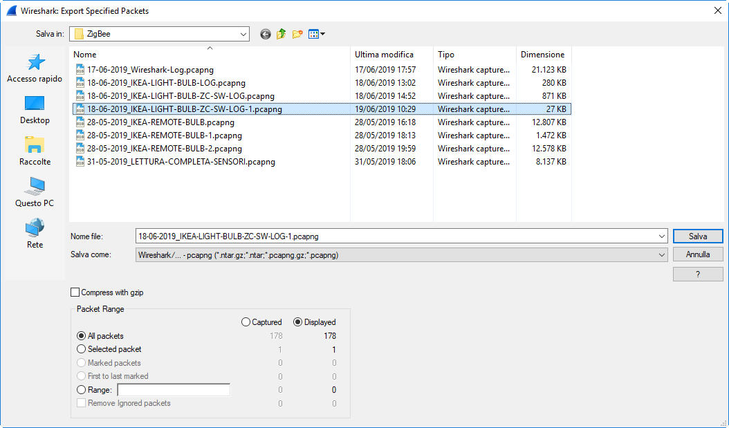

    thank for ytour help, here attached the Wireshark Log.
    Concerning the zc_light sample application, from my understanding, correct me if I'm doing wrong, the application work as a coordinator, so able to from the network and bind ZCD device, also as coordinator it can be a ZigBee device and in this example the coordinator can behave also as a light, I've correctly understand?
    Also to start from scratch I've checked the behavior of my ligh-bulb at startup and at now behave correctly by doing three scan attemps as specified inside the "ZIGBEE HOME AUTOMATION PUBLIC APPLICATION PROFILE", so the process is going straight but what I can see is the endopoint discovering process, may be I've to write it inside the sample application? This type of info I'm looking for inside the demo design but is not simple to find...
    Thank
    Best regards.
    17-06-2019_Wireshark-Log.zip

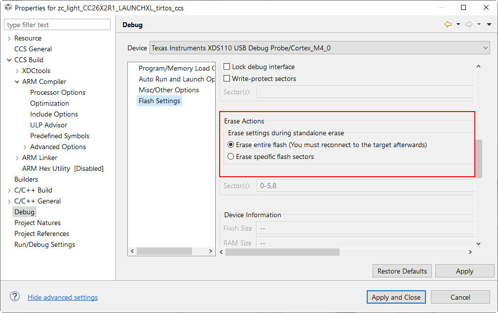

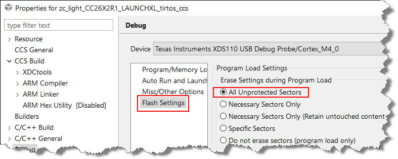

  • After you set BDB_DEFAULT_TC_REQUIRE_KEY_EXCHANGE to FALSE, you should rebuild your zc_light and erase flash on your LAUNCHXL-CC26X2R1 board to download zc_light firmware to test again.
  • Under the Properties window of the design, inside the Debug section on the Flash Settings there are several points where the flash erase is specified, at the top, into the "Program Load Settings":
    I've to change this option to "All Unprotected Sectors" ?
    and at the bottom, into the "Erase Actions", panels is already set the "Erase entire flash" radio button, so I've to change other option to performs a full flash memory erase?
    What is the difference in flash erasing between these two panels?
    Thank!
    Best regards
  • Yes, I suggest you to use "All Unprotected Sectors". By the way, which Zigbee bulb do you use to test this?

  • After you set BDB_DEFAULT_TC_REQUIRE_KEY_EXCHANGE to false and erase chip to download to test again, does the bulb still cannot join zc_light?
  • Hi @YK Chen,
    I've changed the Flash settings inside the "Program Load Settings" panel as your suggest:
    then I've programmed the board by pressing F11 inside CCS.
    I've did the light bulb reset (6x on-off), after the bulb reset (it will lamp once) I've powered off the light bulb.
    then I started the commissioning process by pressing the btn1 button on the board.
    Then I've powered the light bulb to start the device announce task.
    Here attached the Wireshark log.
    18-06-2019_IKEA-LIGHT-BULB-LOG.zip
    The light bulb get the NWK address from the coordinator but after the "Match Descriptor Request" command from the light bulb there are no other communications, so I think that from the ZC point of view (the LAUNCHXL-CC26X2R1) I've to communicate ad the light bulb that I've someType 1 clusters able to match the light bulb cluster, at least the On/Off cluster to light on and off the bulb, this seems to me from the ZigBee specifications.
    Also I kindly ask if this example implement a ZC (coordinator) with light embedded facility so it appear to others ZigBee devices also as a light device (I think yes because this can be paired to the ZED switch that have the ability to turn on or off light so inside the ZC there should exist a On/Off cluster...), so I kindly ask to more skilled people with these examples if my thinking are correct or no.
    Thank!

    1. reset the light bulb and load the zc_switch sample application in CCS:
    2. recompiled the zc_switch example design (F11)
    3. Perform the commissioning process on the LAUNCHXL-CC26X2R1 board by press the button BTN1
    4. Switch on the light bulb
    5. Log the ZigBee packets through Wireshark
    Here attached the Wireshark sniffing.

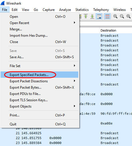

  • I cannot open and parse your sniffer log with my Wireshark.
  • Hi @YK Chen,
    I'm currently using the Wireshark version 3.0.2 and I've saved the packets capture by means of the File->Save As... and option pcapng that is the default one...
    Attached a new export that I've made by means of the Export option (not Save As...) let me know if you can open it.
    18-06-2019_IKEA-LIGHT-BULB-ZC-SW-LOG-1.zip
    Thank!

    Thank you for the latest sniffer log, by looking at it I was able to determine that your ZR light is not responding to the ZC switch's Identify Query, this is what the switch would use to send a Simple Descriptor Request to the light's endpoint to see if there were any application input clusters which could be bound.  Please reference the Zigbee 3.0 sniffer log detailing the correct process between a ZR light and ZC switch.  You must either find out why the IKEA product is not responding to the Identify Query or manually bind the devices using Device Announce Callbacks Active Endpoint Requests/Callbacks, and Simple Descriptor Requests/Callbacks, and ZDO Bind Requests.  The following is an SLA to walk you through the process: http://dev.ti.com/tirex/explore/node?node=AJeGnyIqlkquNAYMtLtovQ__pTTHBmu__LATEST
    For your questions regarding Zigbee Cluster types and initiator/taget roles, please refer to Section 6.2 of SWRA615: http://www.ti.com/lit/swra615
    You misunderstood the ZC README, commissioning does not have to be performed after network steering.  Binding, attribute reporting, and sending ZCL commands can all occur after permit join is disabled and commissioning has ended.

    Here below the used hardware (the GPIO two flying wires are only for testing, not used in this work, connected to a simple led).

    Starting from the init of the tutorial perform a full Erase of the flash memory with the UniFlash tool. About this point it may be not mandatory if the settings inside CCS (Project->Properties->Debug->Flash Settings) are set in order to perform the erase of All Unprotected Sectors (option under the Program Load Settings panel).
    Load inside CCS the zc_switch demo design.
    From ttutorial Task 1 step 3 define the following global variables inside the zcl_samplesw.c source file (of course the file name is different because now we are working with the zc_switch example and not with the zc_light example described into the tutorial):

    Now, before run the example perform a light bulb reset (6x power On and Off cycle until the lamp perform a blink).
    Power off the light bulb.
    Run the demo application.
    Press the BTN1 button on the LAUNCHXL-CC26X2R1 board.
    Wait some seconds and apply power to the light bulb.
    After a little the light bulb will be paired and through the BTN2 on the LAUNCHXL-CC26X2R1 board the light bulb will be On or Off (the BTN2 issue a toggle command, see the zclSampleSw_processKey() function where the KEY_RIGHT is processed).
