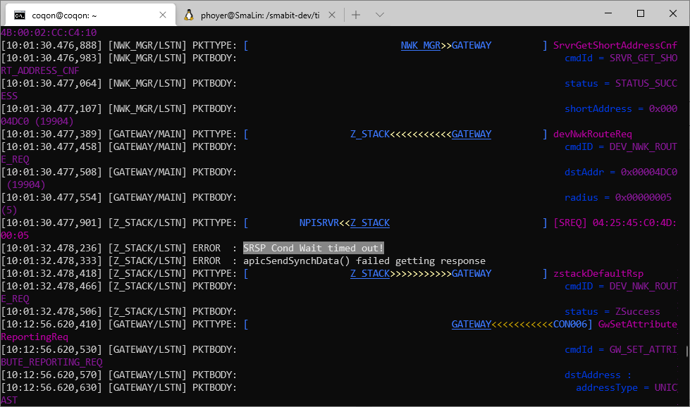

We have are having an issue with a smart home gateway with CC1352 adn Z-Stack Linux gateway. After a certain amount of commands sent to a smart plug, we get the following message:
[16:54:21.697,127] [Z_STACK/LSTN] ERROR  : SRSP Cond Wait timed out!
[0m[37m[16:54:21.696,797] [GATEWAY/LSTN] ERROR  : SRSP Cond Wait timed out!
[0m[37m[16:54:21.696,894] [GATEWAY/LSTN] ERROR  : apicSendSynchData() failed getting response
I doubt that this has to do with UART speed or other speed-related parameters as the problem can be reproduced depending on the amount of commands sent, not their interval:
  1. 2 secs interval: after about 50 minutes
  2. 5 secs interval: after about 3 hours
  3. 15 secs interval: after about 10 hours
When running a test script changing the plug state each x seconds, at some point we do not receive the state anymore (this is when we get the timeout message) but the plug continues to switch correctly. After another 20 minutes or so the plug also stops switching. For the second state, I cannot find a specific point in the log, you can just see this on the plug.
Could it be some counter or buffer which will overrun after some time?
In the attached log you can find the event at 16:54:21.697,127. I needed, we can provide further logs. The problem happens with different units (gateway and plug) so it is not related to a specific hardware.

  • Hi Peter,
    An update from my side:
    After investigating the logs which you've provided, I believe the issue is related to and EINTR, which occurs during call to recv() in SISreadThreadFunc: recv: Interrupted system call. Notice that in zigbee.log, all the "SRSP Cond Wait timed out!" happen after "recv: Interrupted system call".
    Specifically for Z_STACK/READ:
      // Read from socket
      do
        // Normal data
        n = recv( pInstance->sAPIconnected, &hdrbuf, sizeof(hdrbuf), MSG_WAITALL );
        if ( n <= 0 )
          if ( n < 0 )
            perror( "recv" );
          else
            uiPrintfEx(trINFO, "Peer closed connection\n" );
          done = 1;
    As you can see, if recv() runs across EINTR, then this thread essentially ends (done = 1). The result is that Z_STACK/READ no longer receives messages, causing Z_STACK/LSTN to always time out for synchronous transactions (READ is the only thread which signals that a SRSP is received).
    To overcome this, we can re-do the recv() if it was interrupted by a system call, something like:
    // Normal data
        do {
        } while ( n < 0   &&   errno == EINTR);
            if ( len > 0 )
              do {
                n = recv( pInstance->sAPIconnected, pMsg + 1, len, MSG_WAITALL );
            else
              // There are no payload bytes; which is also valid.
              n = 0;
    Toby
  • Hi Toby,
    I have applied your changes but now it runs ino a segfault after some time, I suppose when the othe problem would have normally occured.
    I have attached the full log file and below a screenshot from when it happens. There is also the ZB trace attached and, just to make sure, a copy of the file which I have changed.
    Peter

      if ( !hdr )
        return NULL;
      hdr->subSys = subSys & RPC_SUBSYSTEM_MASK;
      if ( (subSys & RPC_CMD_TYPE_MASK) == 0 )
        hdr->subSys |= RPC_CMD_SREQ;
      hdr->cmdId = cmdId;
    #ifdef API_CLIENT_8BIT_LEN
      hdr->len = (uint8) len;
    #else // API_CLIENT_8BIT_LEN
      // Length field endianness conversion to little endian
      hdr->lenL = (uint8) len;
      hdr->lenH = (uint8)( len >> 8 );
    #endif // API_CLIENT_8BIT_LEN
      memcpy( hdr + 1, pData, len );
      uiPrintfEx(trINFO, "preparing to send %d bytes, subSys 0x%.2X, cmdId 0x%.2X, pData:\n",
          len,
          subSys,
          cmdId );
      // Lock mutexes
      uiPrintfEx(trINFO, "[MUTEX] Lock SRSP Transaction Mutex\n" );
      if ( pthread_mutex_lock( &pInstance->clientSREQRSPmutex ) != 0 )
        perror( "pthread_mutex_lock" );
        exit( 1 );
      len += sizeof(*hdr);
      ptr = (uint8 *) hdr;
      if ( pthread_mutex_lock( &pInstance->sendMutex ) != 0 )
        exit( 1 );
      visualization_args.localLN = pAPIS_SysParams->layerNum;
      visualization_args.localName = pAPIS_SysParams->serverName;
      visualization_args.remoteLN = get_connection_layer_number(pInstance->sAPIconnected);
      visualization_args.remoteName = get_connection_name(pInstance->sAPIconnected);
      visualization_args.directionSend = TRUE;
      visualization_args.max_layers = INVALID_LAYER_NUMBER;
      trace_print_buf(ptr, len, "[SREQ] ", &visualization_args);
      print_pb_msg(hdr->subSys, hdr->cmdId, ptr + sizeof(apicMsgHdr_t), len - sizeof(apicMsgHdr_t), 0, "", FALSE, &visualization_args, sizeof(apicMsgHdr_t), "[SREQ] ");
      for ( ;; )
        n = send( pInstance->sAPIconnected, ptr, len, 0 );
        if ( n == -1 )
          perror( "send" );
          pthread_mutex_unlock( &pInstance->sendMutex );
          free( hdr );
          pthread_mutex_unlock( &pInstance->clientSREQRSPmutex );
          return NULL;
        if ( n < len )
          ptr += n;
          len -= n;
          // Repeat till entire frame is sent out.
          continue;
        break;
      free( hdr );
      uiPrintfEx(trINFO, "Waiting for synchronous response...\n" );
      // Conditional wait for the response handled in the receiving thread,
      // wait maximum 2 seconds
      gettimeofday( &curtime, NULL );
      expirytime.tv_sec = curtime.tv_sec + 2;
      expirytime.tv_nsec = curtime.tv_usec * 1000;
      uiPrintfEx(trINFO, "[MUTEX] Lock SRSP Mutex\n" );
      if ( pthread_mutex_lock( &pInstance->clientSREQmutex ) != 0 )
        exit( 1 );
      uiPrintfEx(trINFO, "[MUTEX] Wait for SRSP Cond signal...\n" );
      while ((result == 0) && (pInstance->numOfReceivedSRSPbytes == 0))
        result = pthread_cond_timedwait( &pInstance->clientSREQcond, &pInstance->clientSREQmutex, &expirytime );
      // Wait for response
      if (result == 0)
        if ( pInstance->numOfReceivedSRSPbytes > 0 )
          // Copy response back in transmission buffer for processing
          rspMsg = pInstance->srsp_msg;
          // Clear the response queue
          pInstance->srsp_msg = NULL;
        else if ( pInstance->numOfReceivedSRSPbytes == -1 ) //need to add handling of a client disconnection while waiting to srsp (in that case, lock pInstance->clientSREQmutex, set pInstance->numOfReceivedSRSPbytes = -1 , and signal pInstance->clientSREQcond.
          uiPrintf( "Server closed connection\n" );
      else if ( result == ETIMEDOUT )
        // TODO: Indicate synchronous transaction error
        uiPrintfEx(trINFO, "[MUTEX] SRSP Cond Wait timed out!\n" );
        uiPrintfEx( trERROR, "SRSP Cond Wait timed out!\n" );
      else
        uiPrintfEx( trERROR, "SRSP Cond Wait returned %d\n", result );
      pInstance->numOfReceivedSRSPbytes = 0;
      // Now unlock the mutexes before returning
      uiPrintfEx(trINFO, "[MUTEX] Unlock SRSP Mutex\n" );
      pthread_mutex_unlock( &pInstance->clientSREQmutex );
      if ( rspMsg )
        if ( pRxSubSys )
          *pRxSubSys = rspMsg->subSys;
        if ( pRxCmdId )
          *pRxCmdId = rspMsg->cmdId;
        if ( pRxLen )
          *pRxLen = rspMsg->len;
        returnValue = (uint8 *) (rspMsg + 1);
      else
        uiPrintfEx( trERROR, "apicSendSynchData() failed getting response\n");
      return returnValue;
     * @fn          apicFreeSynchData
     * @brief       This function returns the received synchronous response
     *              data back to the memory pool.
     * @param       pData - pointer to the memory block that were returned
     *                      from apicSendSynchData.
     * @return      None
    void apicFreeSynchData( uint8 *pData )
      free( ((areqMsg *) pData) - 1 );
     * @fn          apicSendAsynchData
     * @brief       This function sends a message asynchronously over the
     *              socket
     * @param       handle - API client handle
     * @param       subSys - Subsystem ID
     * @param       cmdId - Command ID
     * @param       len- length in bytes of the message payload to send
     * @param       pData - payload message to send
     * @return      None.
    void apicSendAsynchData( apicHandle_t handle, uint8 subSys, uint8 cmdId,
                             uint16 len, uint8 *pData )
      size_t n;
      uint8 *ptr;
      apicMsgHdr_t *hdr;
      apicInstance_t *pInstance = handle;
      visualization_args_t visualization_args;
      if (len > 255)
        uiPrintf( "[ERR] apicSendAsynchData called with excessive length %d\n",
            len );
        return;
      hdr = malloc( sizeof(apicMsgHdr_t) + len );
      if ( !hdr )
        uiPrintf( "[ERR] apicSendAsynchData failed malloc()\n" );
        return;
      // Add Proper RPC type to header
        hdr->subSys |= RPC_CMD_AREQ;
      hdr->cmdId = cmdId;
      hdr->len = len;
      // Endianness conversion
      uiPrintfEx(trINFO, "trying to send %d bytes, subSys 0x%.2X, cmdId 0x%.2X\n",
          len,
          subSys,
          cmdId );
      len += sizeof(apicMsgHdr_t);
        exit( 1 );
      trace_print_buf(ptr, len, "[AREQ] ", &visualization_args);
      print_pb_msg(hdr->subSys, hdr->cmdId, ptr + sizeof(apicMsgHdr_t), len - sizeof(apicMsgHdr_t), 0, "", FALSE, &visualization_args, sizeof(apicMsgHdr_t), "[AREQ] ");
      for ( ;; )
        if ( n == -1 )
          perror( "send" );
        else if ( n < len )
          len -= n;
          ptr += n;
          // Repeat till all bytes of the message is sent.
          continue;
        break;
      free( hdr );
     * @fn          apicReadVersionReq
     * @brief       This API is used to read the serial interface server
     *              version.
     * @param       pValue -
     * @return      None.
    void apicReadVersionReq( apicHandle_t handle, uint8 *pValue )
      uint8 *pRsp;
      // Send Read Version Request
      pRsp = apicSendSynchData( handle, RPC_SYS_SRV_CTRL,
          API_LNX_CMD_ID_VERSION_REQ, 0, NULL, NULL, NULL, NULL );
      if ( pRsp )
        // copy the reply data to the client's buffer
        // Note: the first byte of the payload is reserved for the status
        memcpy( pValue, &pRsp[1], 3 );
        apicFreeSynchData( pRsp );
     * @fn          apicReadParamReq
     * @brief       This API is used to read serial interface server parameters.
     * @param       paramId - The parameter item identifier.
     * @param       len - The length in bytes of the item identifier's data.
     * @param       *pValue - Pointer to buffer where read data is placed.
     * @return      None.
    void apicReadParamReq( apicHandle_t handle, uint8 paramId, uint8 len,
                           uint8 *pValue )
      uint8 *pRsp, reqdata[] =
      { paramId, len };
      // Send param request
          API_LNX_CMD_ID_GET_PARAM_REQ, 2, reqdata, NULL, NULL, NULL );
      if ( pRsp )
        memcpy( pValue, &pRsp[1], len );
    /* Initialize thread synchronization resources */
    static void initSyncRes( apicInstance_t *pInstance )
      // initialize all mutexes
      pthread_mutex_init( &pInstance->clientSREQRSPmutex, NULL );
      pthread_mutex_init( &pInstance->clientSREQmutex, NULL );
      pthread_mutex_init( &pInstance->clientAREQmutex, NULL );
      pthread_mutex_init( &pInstance->sendMutex, NULL );
      // initialize all conditional variables
      pthread_cond_init( &pInstance->clientSREQcond, NULL );
      if ( sem_init( &pInstance->clientAREQsem, 0, 0 ) != 0 )
        uiPrintf( "[ERR] sem_init() failed\n" );
        exit( 1 );
    /* Destroy thread synchronization resources */
    static void delSyncRes( apicInstance_t *pInstance )
      // destroy all conditional variables
      pthread_cond_destroy( &pInstance->clientSREQcond );
      sem_destroy( &pInstance->clientAREQsem );
      // destroy all mutexes
      pthread_mutex_destroy( &pInstance->clientSREQRSPmutex );
      pthread_mutex_destroy( &pInstance->clientSREQmutex );
      pthread_mutex_destroy( &pInstance->clientAREQmutex );
      pthread_mutex_destroy( &pInstance->sendMutex );
     * @fn          SISreadThreadFunc
     * @brief       Read Thread
     * @param       ptr - poiner to instance
     * @return      pointer to instance
    static void *SISreadThreadFunc( void *ptr )
      int done = 0, n;
      apicMsgHdr_t hdrbuf;
      apicInstance_t *pInstance = ptr;
      char trace_prefix[35];
      trace_init_thread("READ");
      /* thread loop */
      // Read from socket
      do
        // Normal data
        do
        if ( n <= 0 )
          if ( n < 0 )
            perror( "recv" );
          else
          done = 1;
        else if ( n == sizeof(hdrbuf) )
          size_t len;
          areqMsg *pMsg;
          // We have received the header,
          // now read out length bytes and process it,
          // if there are bytes to receive.
          len = hdrbuf.len;
          // Convert little endian length to host endianness
          len = hdrbuf.lenL;
          len |= (uint16) hdrbuf.lenH << 8;
          pMsg = malloc( sizeof(areqMsg) + len );
          if ( pMsg )
            pMsg->nextMessage = NULL;
            pMsg->len = len;
            pMsg->subSys = hdrbuf.subSys;
            pMsg->cmdId = hdrbuf.cmdId;
            if ( len > 0 )
              do
            else
              n = 0;
            if ( n == pMsg->len )
              uiPrintfEx(trINFO, "Received %d bytes, subSys 0x%.2X, cmdId 0x%.2X\n",
                  pMsg->len, pMsg->subSys, pMsg->cmdId );
              STRING_START(trace_prefix,"[read] %02X:%02X:%02X:", hdrbuf.len, hdrbuf.subSys, hdrbuf.cmdId);
    #else
              STRING_START(trace_prefix,"[read] %02X:%02X:%02X:%02X:", hdrbuf.lenL, hdrbuf.lenH, hdrbuf.subSys, hdrbuf.cmdId);
    #endif
              visualization_args.directionSend = FALSE;
              trace_print_buf(((uint8 *)(&pMsg[1])), n, trace_prefix, &visualization_args);
              print_pb_msg(pMsg->subSys, pMsg->cmdId, ((uint8 *)(&pMsg[1])), n, 0, "", FALSE, &visualization_args, sizeof(apicMsgHdr_t), "[read] ");
              if ( (pMsg->subSys & RPC_CMD_TYPE_MASK) == RPC_CMD_SRSP )
                // and signal the synchronous reception
                uiPrintfEx(trINFO, "[MUTEX] SRSP Cond signal set\n" );
                uiPrintfEx(trINFO, "Client Read: (len %d):\n", pMsg->len + sizeof(hdrbuf) );
                fflush( stdout );
                  uiPrintf( "[ERR] Mutex lock failed while handling SRSP\n" );
                  exit( 1 );
                if ( pInstance->srsp_msg )
                  // Unhandled SRSP message must be freed
                  uiPrintfEx( trWARNING, "[ERR] Unhandled SRSP cleared\n" );
                  free( pInstance->srsp_msg );
                pInstance->srsp_msg = pMsg;
                pInstance->numOfReceivedSRSPbytes = pMsg->len + sizeof(hdrbuf);
                pthread_cond_signal( &pInstance->clientSREQcond );
              else if ( (pMsg->subSys & RPC_CMD_TYPE_MASK) == RPC_CMD_AREQ )
                uiPrintfEx(trINFO, "RPC_CMD_AREQ cmdId: 0x%.2X\n", pMsg->cmdId );
                pInstance->areqRxMsgCount++;
                uiPrintfEx(trINFO, "[DBG] Allocated \t@ 0x%08X"
                    " (received\040 %d messages)...\n",
                    (unsigned int)pMsg,
                    pInstance->areqRxMsgCount );
                uiPrintfEx(trINFO, "Filling new message (@ 0x%08X)...\n",
                    (unsigned int)pMsg );
                if ( pthread_mutex_lock( &pInstance->clientAREQmutex ) != 0 )
                  uiPrintf( "[ERR] pthread_mutex_lock() failed"
                      " while processing AREQ\n" );
                  exit( 1 );
                // Place message in read list
                if ( pInstance->areq_rec_buf == NULL )
                  // First message in list
                  pInstance->areq_rec_buf = pMsg;
                else
                  areqMsg *searchList = pInstance->areq_rec_buf;
                  // Find last entry and place it here
                  while ( searchList->nextMessage != NULL )
                    searchList = searchList->nextMessage;
                  searchList->nextMessage = pMsg;
                pthread_mutex_unlock( &pInstance->clientAREQmutex );
                // Flag semaphore
                sem_post( &pInstance->clientAREQsem );
              else
                // Cannot handle synchronous requests from RNP
                uiPrintf( "ERR: Received SREQ\n" );

    Close to top of log, we see NPI_PID=692.
    The npi_ipc_errno 0x02030100 is defined in npi_lnx_error.h: #define NPI_LNX_ERROR_UART_SEND_FRAME_FAILED_TO_WRITE 0x02030100
    Later we see the part of log you've screenshot:
    [10:01:30.477,901] [Z_STACK/LSTN] PKTTYPE: [ NPISRVR<<Z_STACK ] [SREQ] 04:25:45:C0:4D:00:05
    [10:01:32.478,236] [Z_STACK/LSTN] ERROR : SRSP Cond Wait timed out!
    [10:01:32.478,333] [Z_STACK/LSTN] ERROR : apicSendSynchData() failed getting response
    At this point the NPISRVR is not active, and we see that the zigbeeHAgw script is attempting to restart all the servers:
    resetting ZigBee SoC
    starting NPI, cmd ' ./NPI_lnx_arm_server NPI_Gateway.cfg -v 0x0000010E ' on Thu Nov 5 10:13:17 CET 2020
    [10:13:17.518,404] [NPISRVR/MAIN] UNMSKBL:
    [10:13:17.518,855] [NPISRVR/MAIN] UNMSKBL: ************************************************
    [10:13:17.518,887] [NPISRVR/MAIN] UNMSKBL: * NPI Server v1.0.2d *
    After this, it looks like the communication has been restored (e.g there are GW_ATTRIBUTE_REPORTING_IND).
    Based on these, there are two options:
    1. Restart the specific server (in this case NPI). This would involve changes to other_server_died() (in zigbeeHAgw, which currently stops then restarts all the servers), and also the track_servers script to specify which PID died.
    2. The "Interrupted system call" can be fixed, using similar methods as before (repeating a blocking operation if EINTR is detected, such as for npi_write()).
