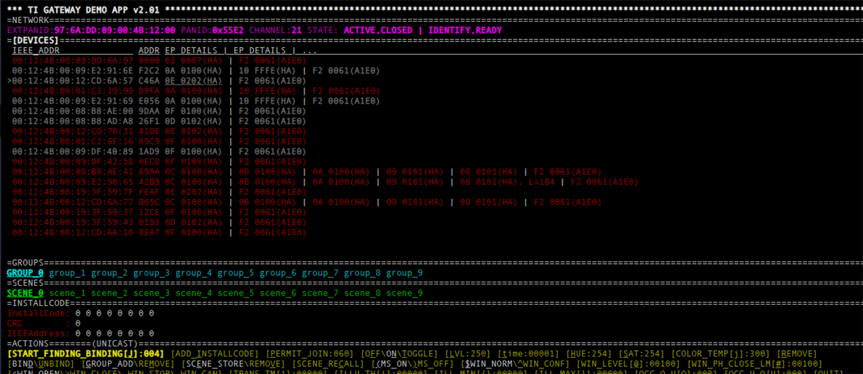

  • Hello Toby Pan,
    I would like to answer your question
    Q. What do you mean "it goes in offline mode" and "device goes offline" ?
    Ans :
    if you look at the Zigbee Gateway Application code. you will be able to found that there is a way to get the Device Network Status.
    In file nwkmgr / nwkmgr.pb-c.h you will able to find its definition. also same reference is mentioned in serverpb / server.pb-c.h
    typedef enum _NwkDeviceStatusT {
       * Device is off-line (non-responsive to service discovery)             // Here TI clearly mentioned that the device is in non-responsive mode.
      NWK_DEVICE_STATUS_T__DEVICE_OFF_LINE = 0,
       * Status good
      NWK_DEVICE_STATUS_T__DEVICE_ON_LINE = 1,
       * Device has been removed
      NWK_DEVICE_STATUS_T__DEVICE_REMOVED = 2,
       * Not Applicable (this value is returned when gateway device)
      NWK_DEVICE_STATUS_T__DEVICE_NA = 255
        PROTOBUF_C__FORCE_ENUM_TO_BE_INT_SIZE(NWK_DEVICE_STATUS_T)
    } NwkDeviceStatusT;
    & this Device State is maintained in the file type.h  > device_info_t  struct.
    /* Display-related information for a Device in the network */
    typedef struct { endpoint_info_t ep_list[MAX_ENDPOINTS]; uint64_t ieee_addr; uint16_t nwk_addr; uint16_t manufacturer_id; bool valid; bool selected; bool selected_as_bind_destination; uint8_t device_status; uint8_t num_endpoints; uint8_t selected_endpoint_index; } device_info_t;
    I am sending you a screenshot that shows the GRAY line devices goes in to offline mode. & RED ones are online.
    & this is defined in user demo / framework / user_interface.c file in function  void ui_redraw_device_list(void)
    STRING_ADD(device_string, DARK_WHITE " |%s%s" , ds_device_table[i].selected_as_bind_destination ? GREEN :   \
     ((ds_device_table[i].device_status == NWK_DEVICE_STATUS_T__DEVICE_OFF_LINE) ? BOLD BLACK : RED), ds_device_table[i].selected ? BOLD : "");
    STRING_ADD(device_string, " ");
    I hope now you will be able to understand about device status.
    How we can manage this to get back our device responsive to service discovery?
    Thanks & Regards
    Shiv Patil.

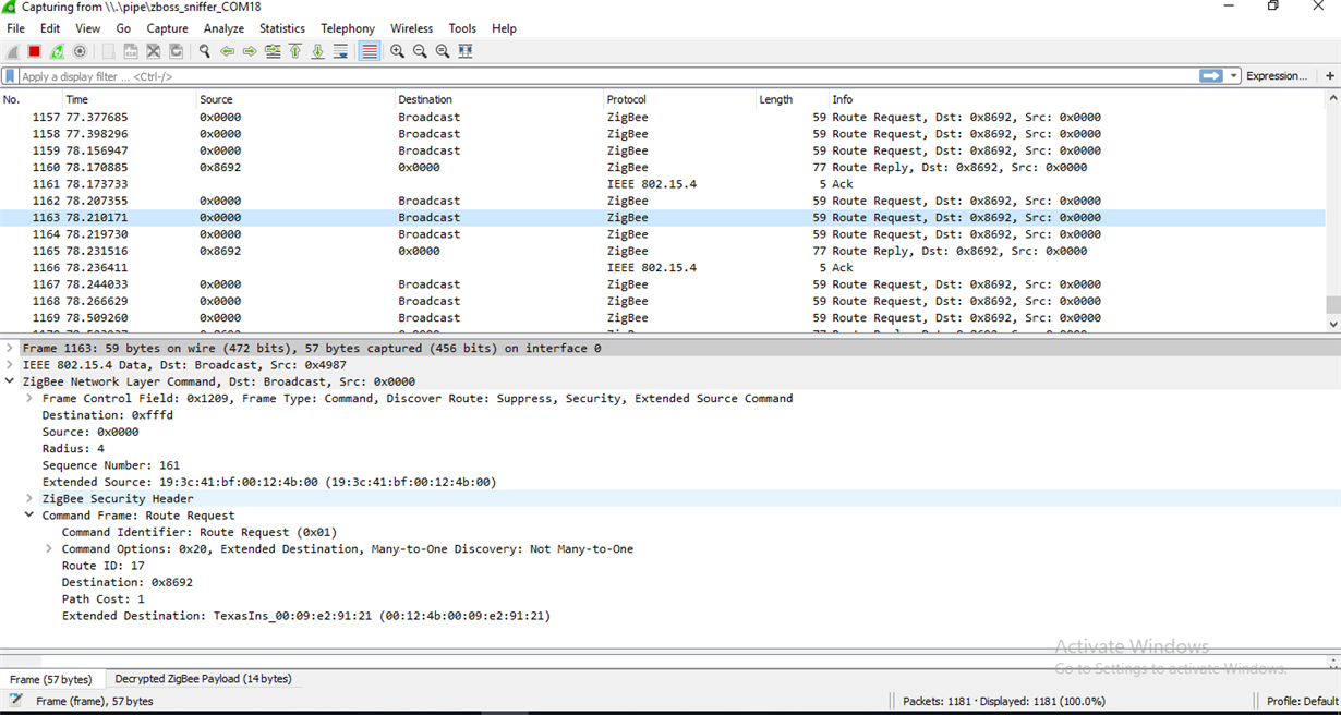

  • If a device is considered offline if the ZNP detects that that device has failed to receive a consecutive number of messages.
    In the gateway server, this number of messages is MAX_DEVICE_FAILED_ATTEMPTS.
    You will need to check sniffer logs to see if this is the case.
    To get the offline device online again, this offline device must become active in the network again.
  • Yes it tries up the MAX_DEVICE_FAILED_ATTEMPTS if device doesn't responds to the requests it goes in to offline mode.
    & When Device goes offline we are not able to see the commands on sniffer. // shows something like Route Request.
    Find the attachment give below will help you to understand the problem
    My question is, how we get device back to online state?...
  • The Route Request is attempting to find a routing path to the "offline device".
    Can you check if the "offline device" is actually functional?
  • To return the device to "online state", you need to make sure that it responds to the messages that the ZNP sends to it.
  • understood,
    When device is in online state or is Responsive to the all requests send to it, works fantastically.
    But in case whenever the device is in non responsive mode / Offline. SRSP Cond Wait timed out! may occur.
    how to handle this error?.
    Shiv Patil.
  • I am not able to reproduce this behavior; when a device goes offline (by powering off), it is grayed out in the UI, but there is no time out in the linux gateway servers.
    Looking back at the sniffer log screenshot, it looks like your device (0x8692) is still functional (it sends the Route Reply).

  • Do one thing,
    Run the ./zigbeeHAgw bbb & ./start_application script.
    Add any device in network supports ON/OFF OR anye Actuation Command related to it.
    Continuously send ON &  OFF commands by pressing keys 'n' & 'f'.
    Try this as ferster as you can.
    After some time you will able to know that device is going to be offline now.
    The device details on start application will be display in gray color as given below.
    >00:12:4B:00:09:E2:91:21 B5F0 0F 0100(HA) | F2 0061(A1E0)
    Try this for few more time you will able to see msg on start application logs.
    TIMEOUT waiting for confirmation
    This means on ./zigbeeHAgw produces the error.
    ERROR : SRSP Cond Wait timed out!
    I am not sure but, this problem is may related to the NIP Linux server.
    Shiv Patil.
