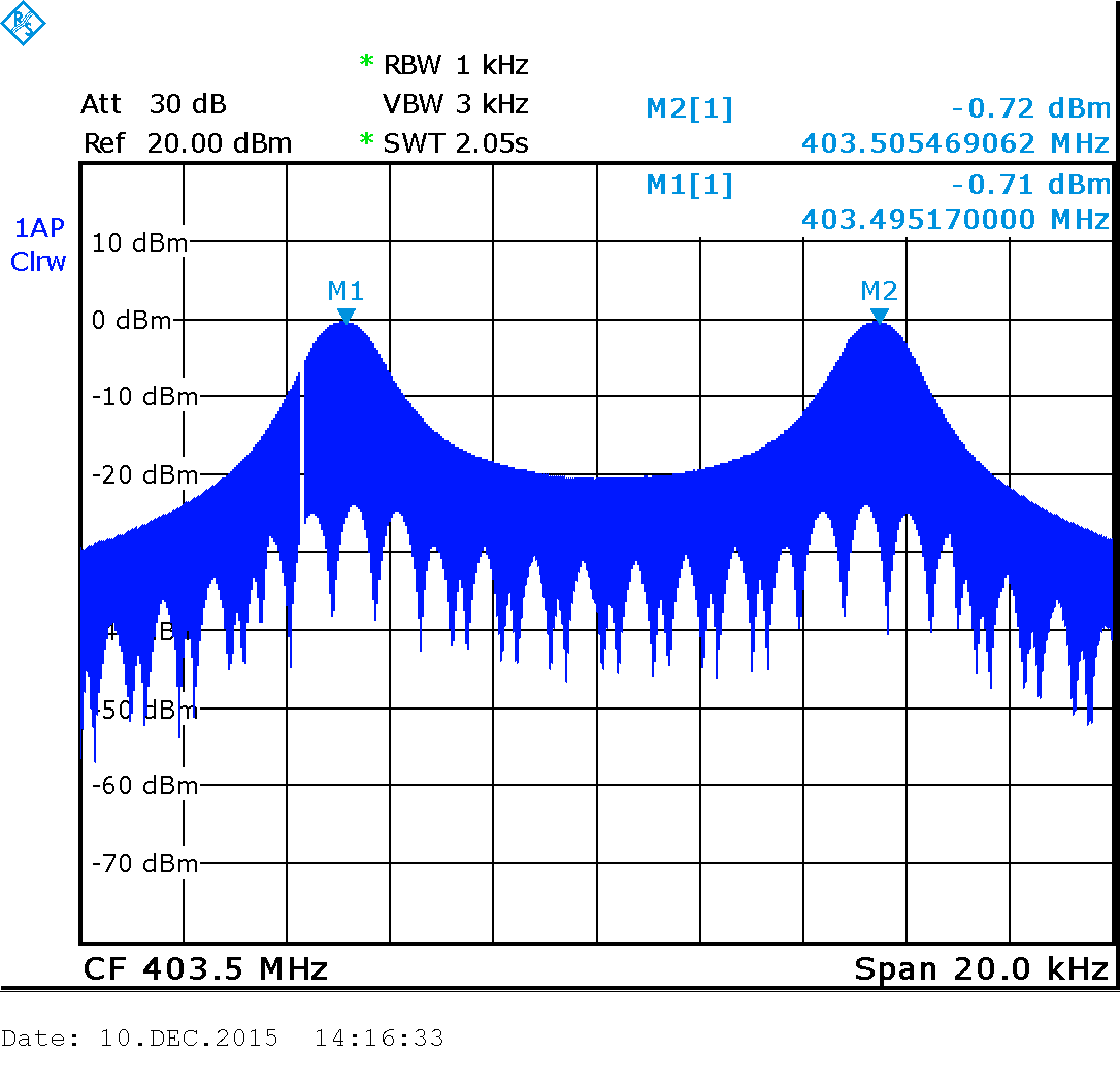

  I have CC1101 Evaluation module (CC1101EMK433) interfaced with MSP430F5529LP launchpad via SPI. I have checked the working of SPI: when I send SRES strobe I receive 0x0F which I monitored using CCS's watch window. Now the issue is when I pass STX, the return status byte doesn't show 0x2_. It remains in 0x0F which was received when SIDLE is passed. However, when I read the address of STX (keeping BURST bit low and MSB of the header high for read operation), upon sending the dummy byte for receiving the data in the address, I get 0x2F here which tells me that the module is in TX mode (STATE bits).  I tried the same with SRX which is passed after passing SIDLE. I observed the same pattern. When I read the SRX register, I get 0x1F in RX buffer which tells the module is in RX mode.
Is this the correct way of making the strobes work or there is some issues? While it is transmitting, I checked the RF output using spectrum analyser which had the same RF parameters that were configured by the microcontroller. Please find the code and the image of the spectrum below.
