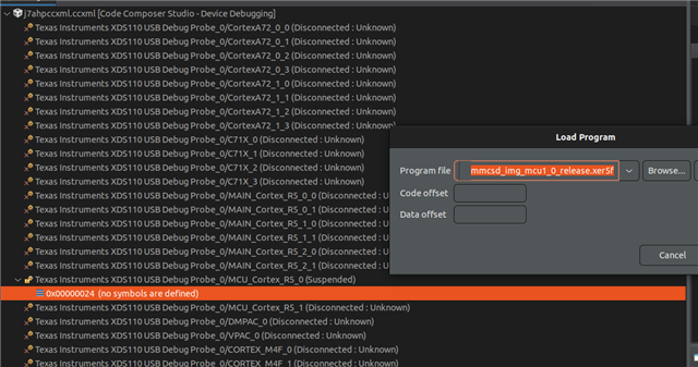

    • Keep the Device in Dev Boot mode and power on .
      • For EVM DIP switch configuration as follow’s
        • SW8[1:8] 1000_0000
        • SW9[1:8] 0111_0000
    • Open debugger connect to R5 core , load SBL image and run.
    • UART console print:
    With this approach we are not actually connecting to the M4_0 for loading TIFS but SBL is doing the task for us.You can also do the power on of the other core's inside the SBL using TISCI api, so that you can load the firmware on those core using JTAG at later stage.
