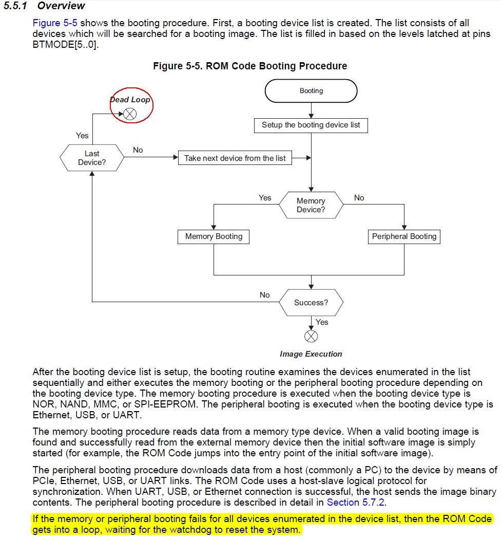

as below description, I understand after BOOTLOADER scan the device list set by bootmode, the BOOTLOADER will enter dead loop and waiting for watchdog(3 minutes) reset. But from test result seems the BOOTLOADER scan the device list in endless loop, for example I set bootmode[5:0] = 111110b, all device in the list are empty, UART0 output CCCCCCCC consequently, never stop, so I think the watchdog never overflow.
So please help check ROM code if below description is not accurate.

    It is more likely that ROM code doesn't enter endless loop to wait for watchdog. If it was, you would see only one 'C' every 3 minutes.
    Endless 'C', denotes ROM doesn't wait for watchdog , but restarts the booting list, or issues a global reset. In this case you cannot notice the watchdog restart, so I presume it is set and working as described. Watchdog is still useful if boot hangs in the middle for some reason.
    I observe the same behavior in DRA7xx.
    I'm not the expert who can confirm though.
    Stan

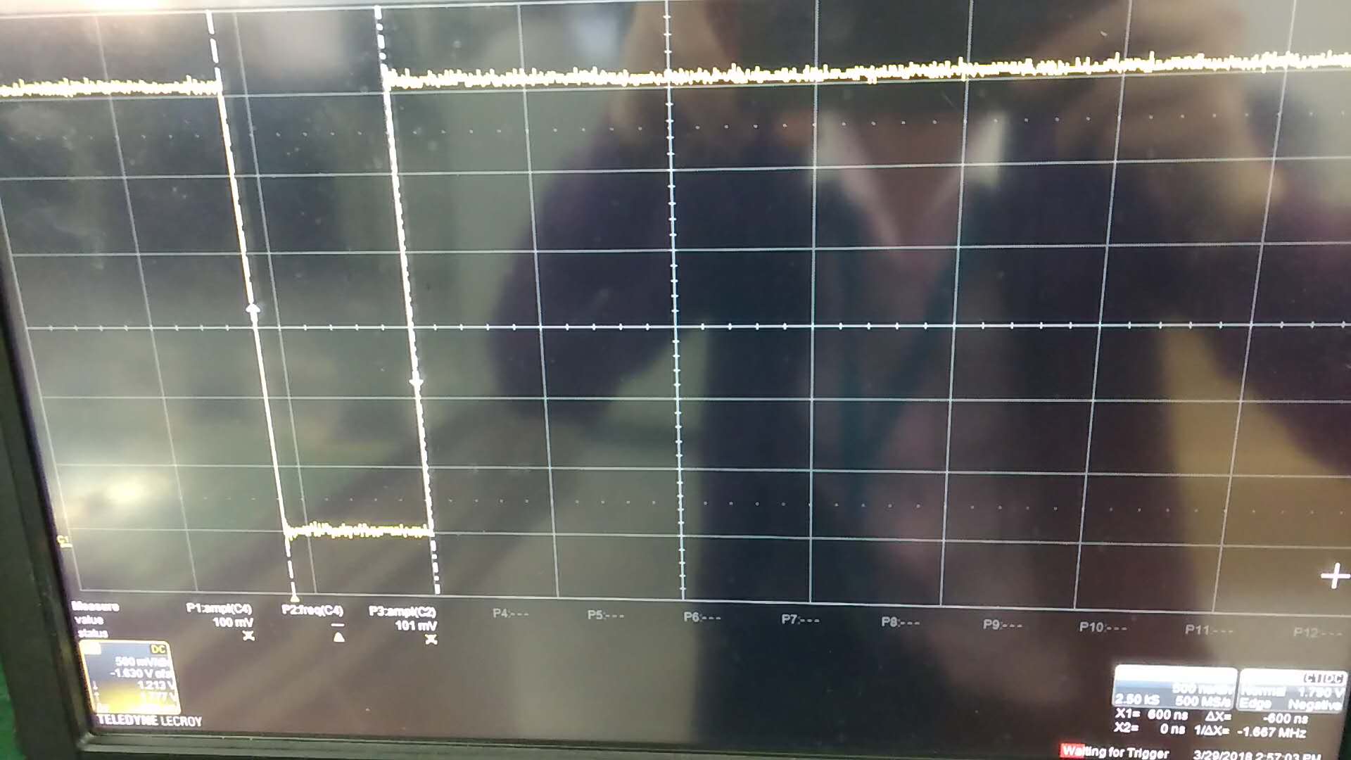

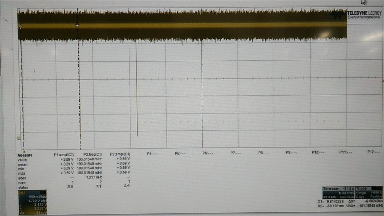

    we don't know at which boot hangs.after hanging, observed 10s interval pulse on RSTOUT_WD_OUT.
     The pulse width is 600ns.
    The test procedure is configure 50s period in watchdog, plus the boot time, so the right interval on RSTOUT_WD_OUT is about 70s. and it is the right behavior during test. but after hanging, RSTOUT_WD_OUT output interval 10s.
